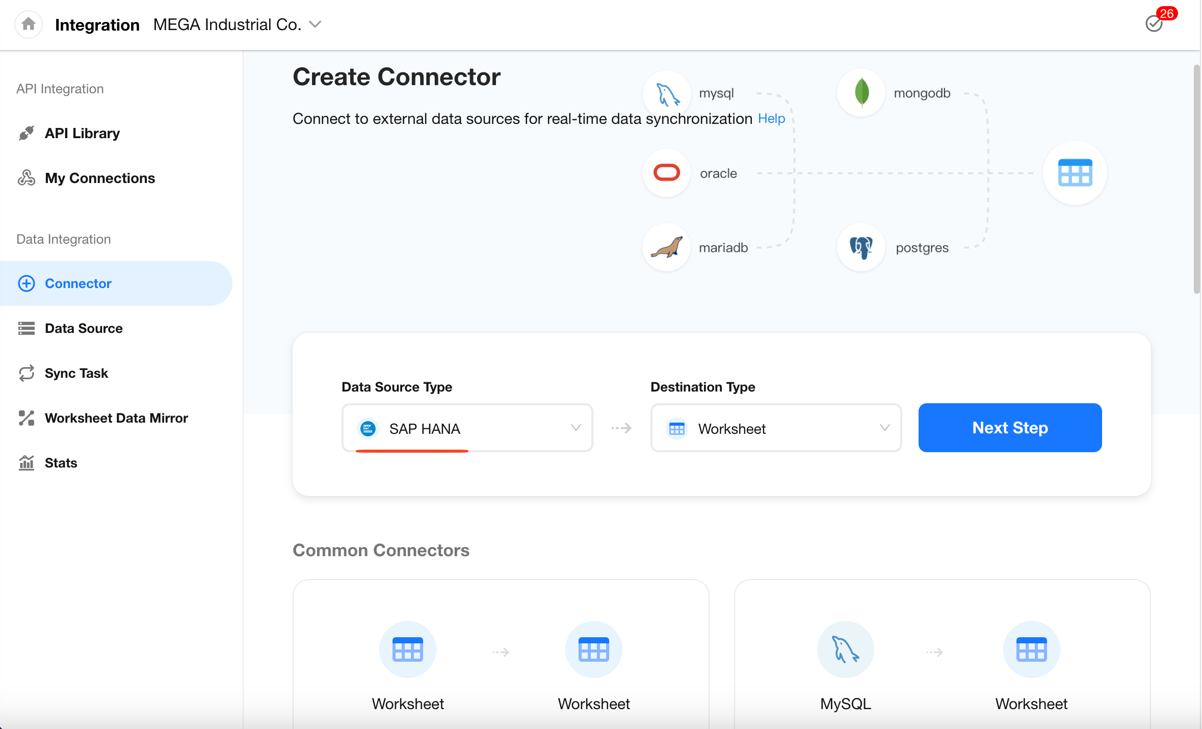

1. Create a Connector
Select the SAP HANA source and the destination data source type, then click Next.

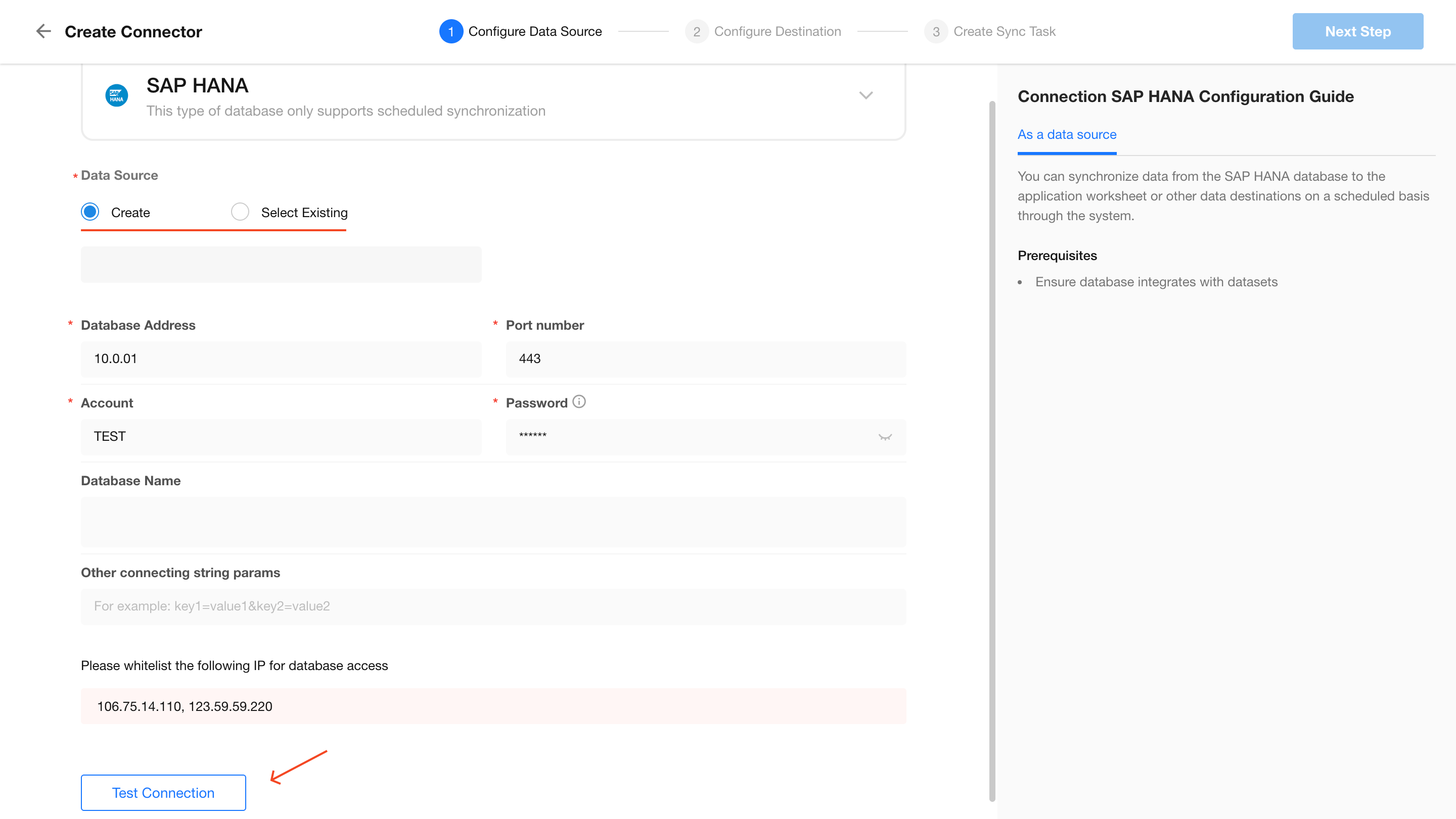

2. Select or Create a Data Source
Create a new data source or select an existing one. Click Test Connection to verify, then click Next if the connection is successful.

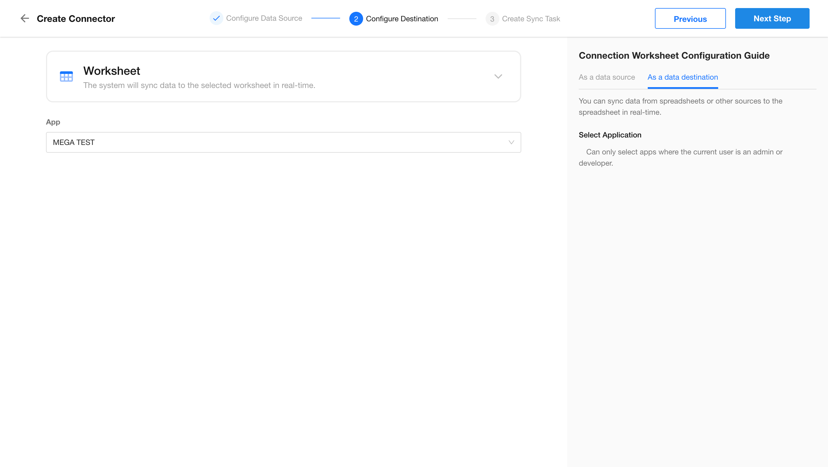

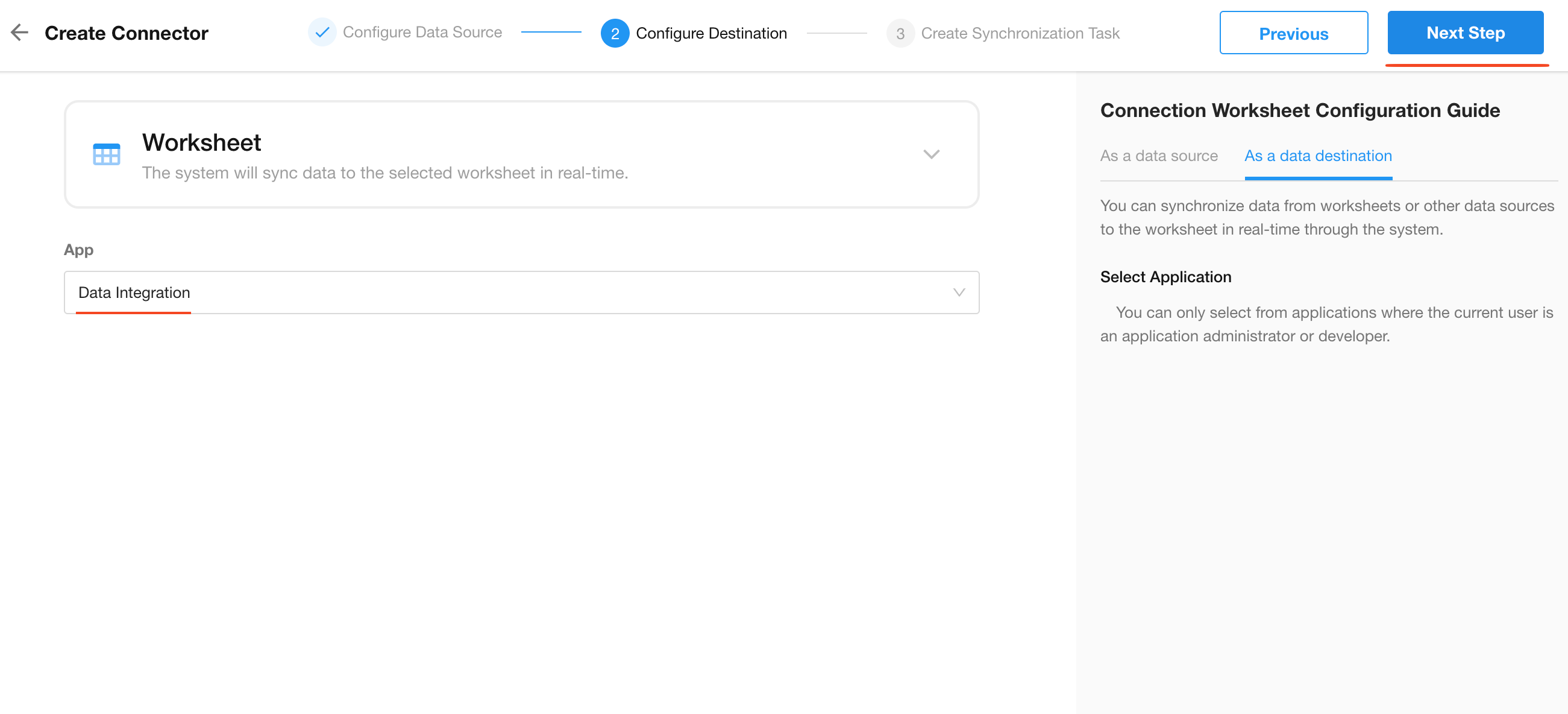

3. Select Destination Database
Choose the target database where the data will be synced.

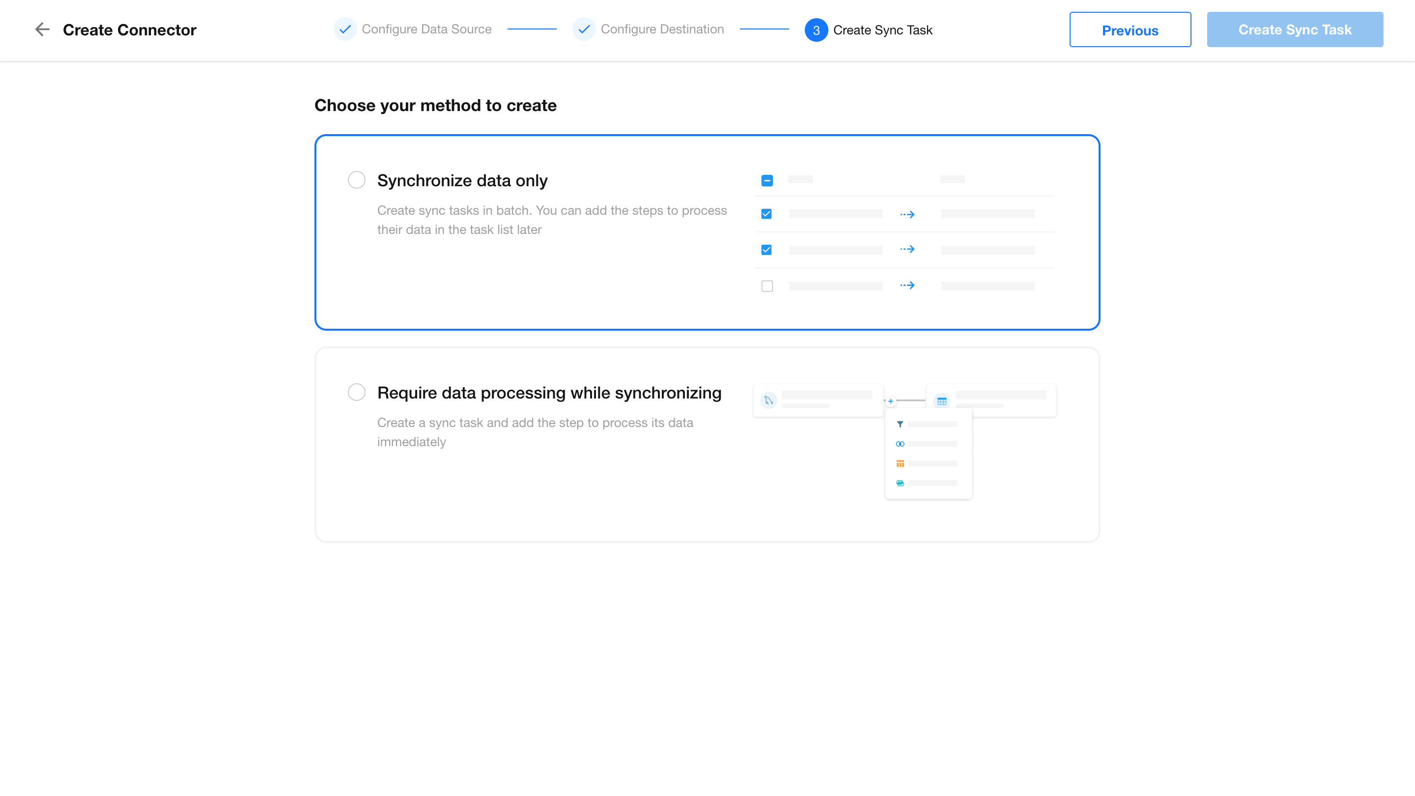

4. Choose a Sync Method
In this example, we demonstrate data-only sync.

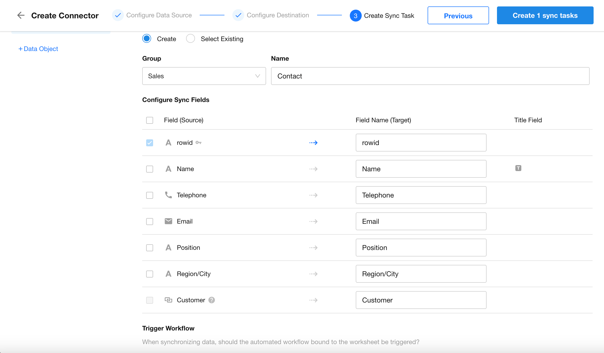

7. Configure Fields to Sync
Define the field mappings and other configurations. Once done, click the Create Sync Task button at the top right.
