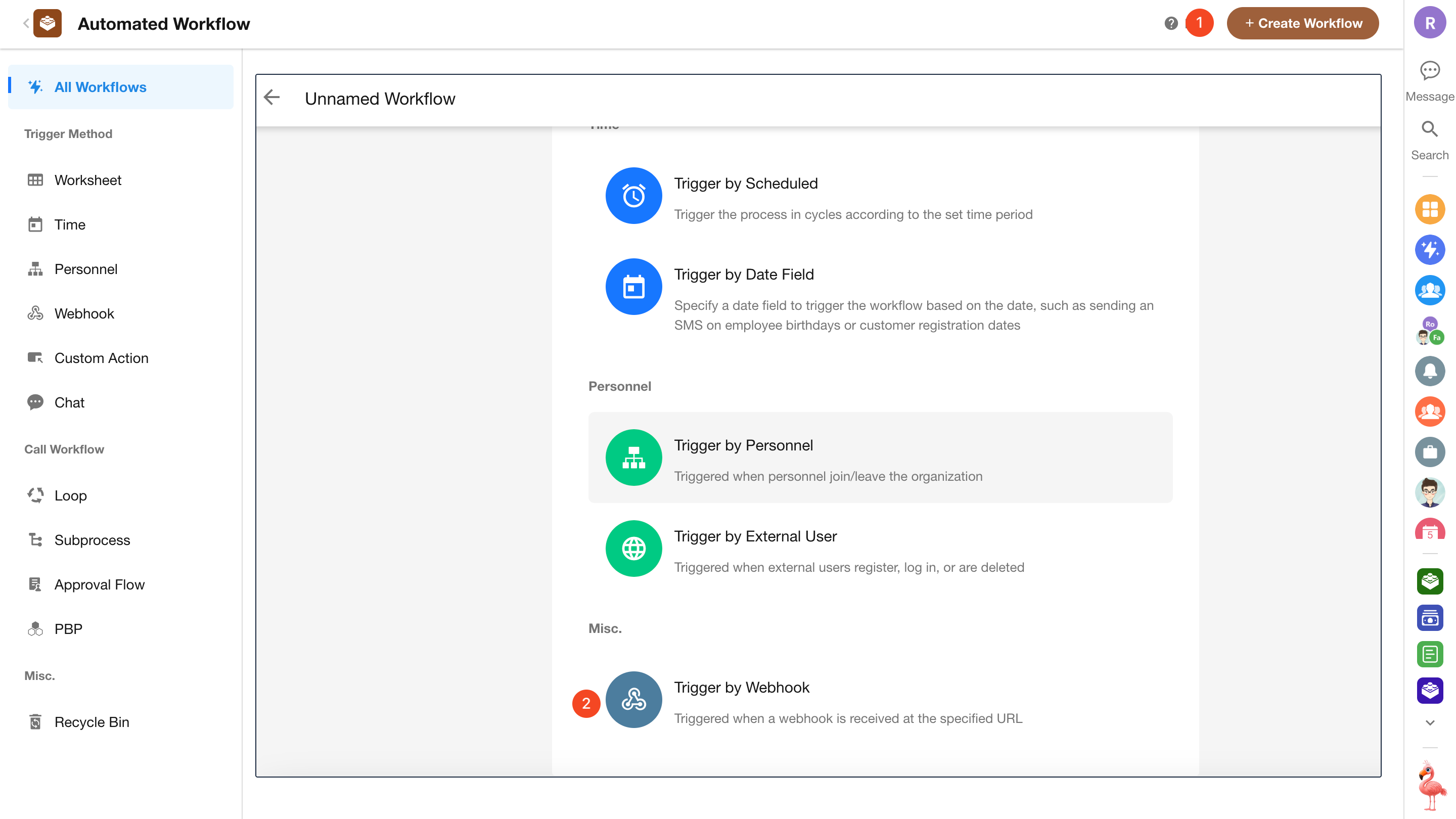

  1. Create a Webhook-triggered workflow
    In the app containing the Orders worksheet, create a workflow triggered by a Webhook. This workflow will receive and process data pushed from the external system.

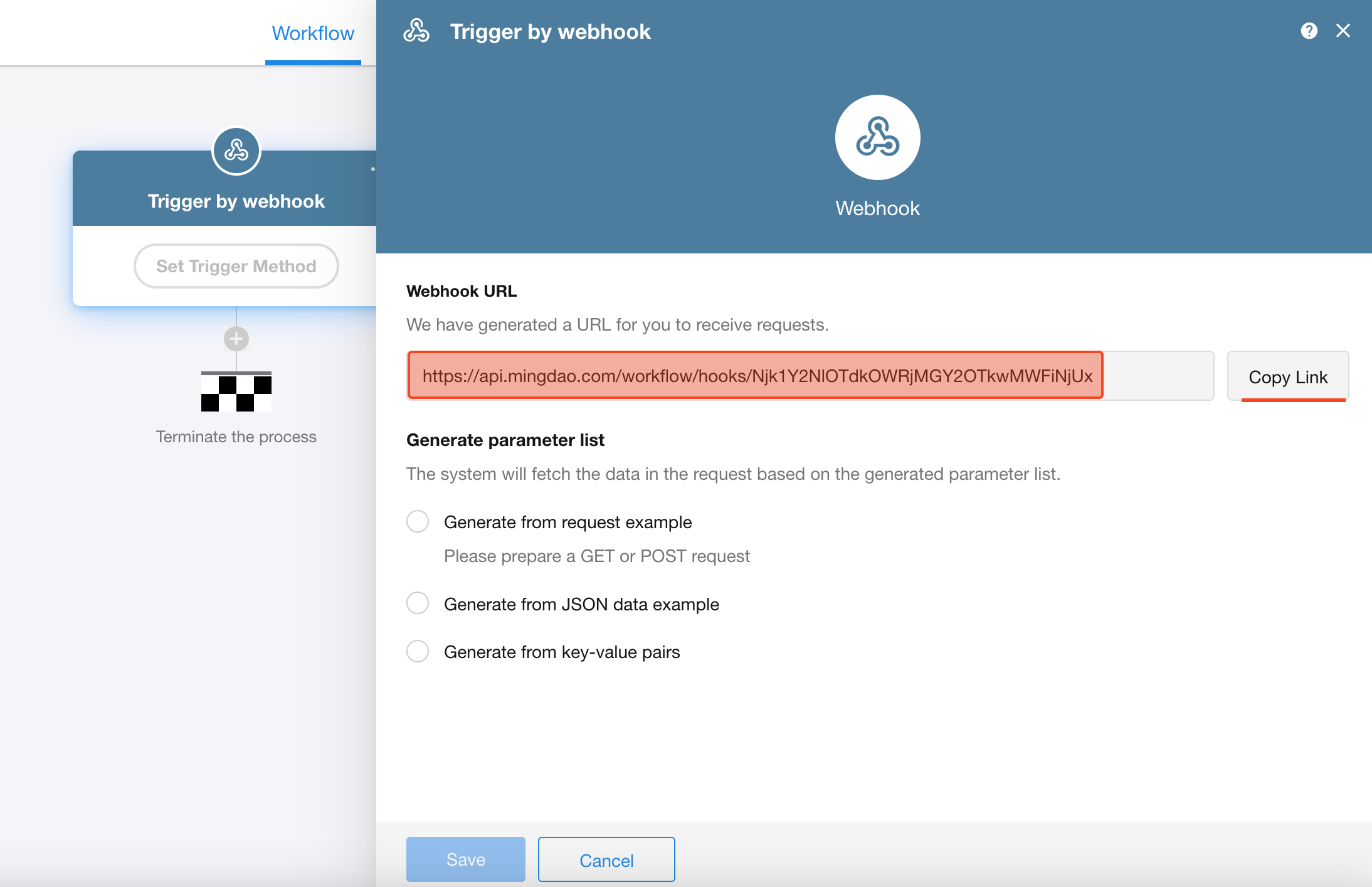

  2. Configure the Webhook
    We generate a Webhook URL to receive incoming requests. Copy the URL and configure it in your external system so that it can send data to HAP.

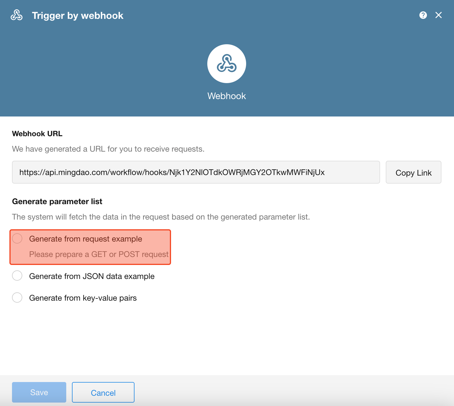

  3. Configure the request parameters

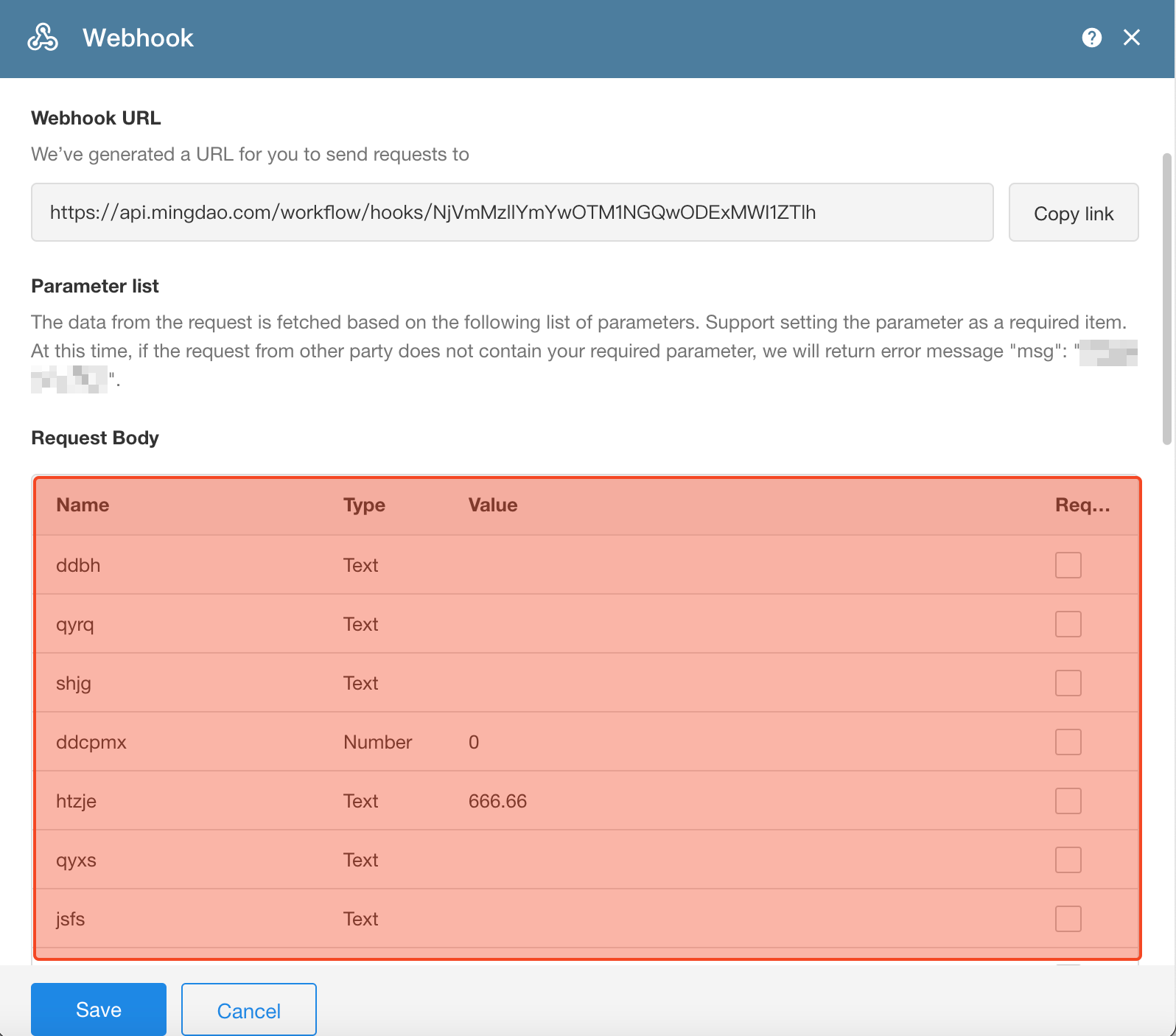

    Select Generate from Sample Request. Within 3 minutes, send a sample request to the Webhook URL from the external system.
    Once HAP receives the request, it automatically generates the corresponding parameters. Review the parameters, confirm them, and save the configuration.
