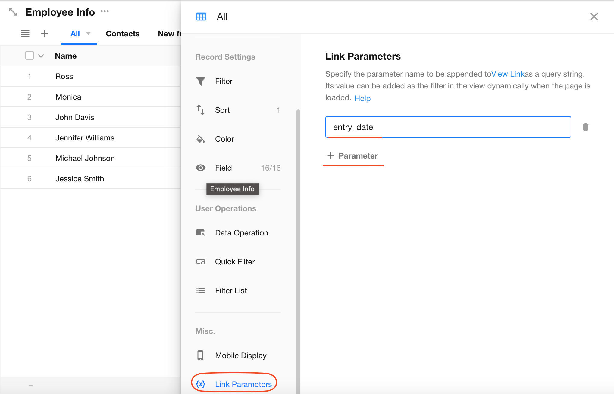

1. Define Link Parameters
For example, if you'd like to filter employee records based on their entry date, and only display those who joined after 2023-12-31, you can define a parameter called entry_date.

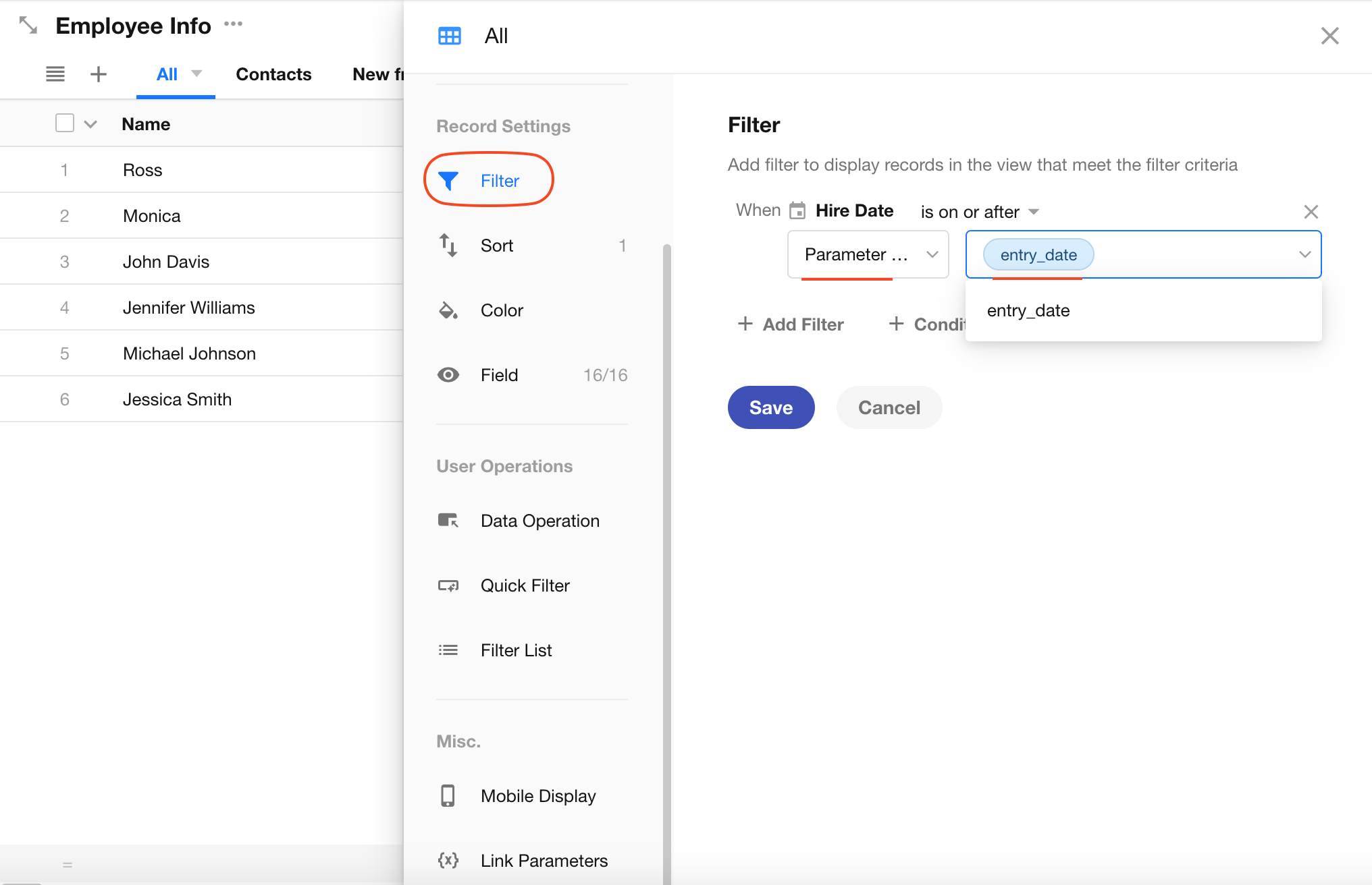

2. Use Link Parameters in Filters
While configuring filters for the view, choose Parameter Value as the condition type, and select a defined parameter name.
The "Parameter Value" option will only appear after parameters have been defined in the view.
If a parameter value is empty or no parameter defined, the condition will be ignored.
If the parameter value format is invalid, the condition will also be ignored.

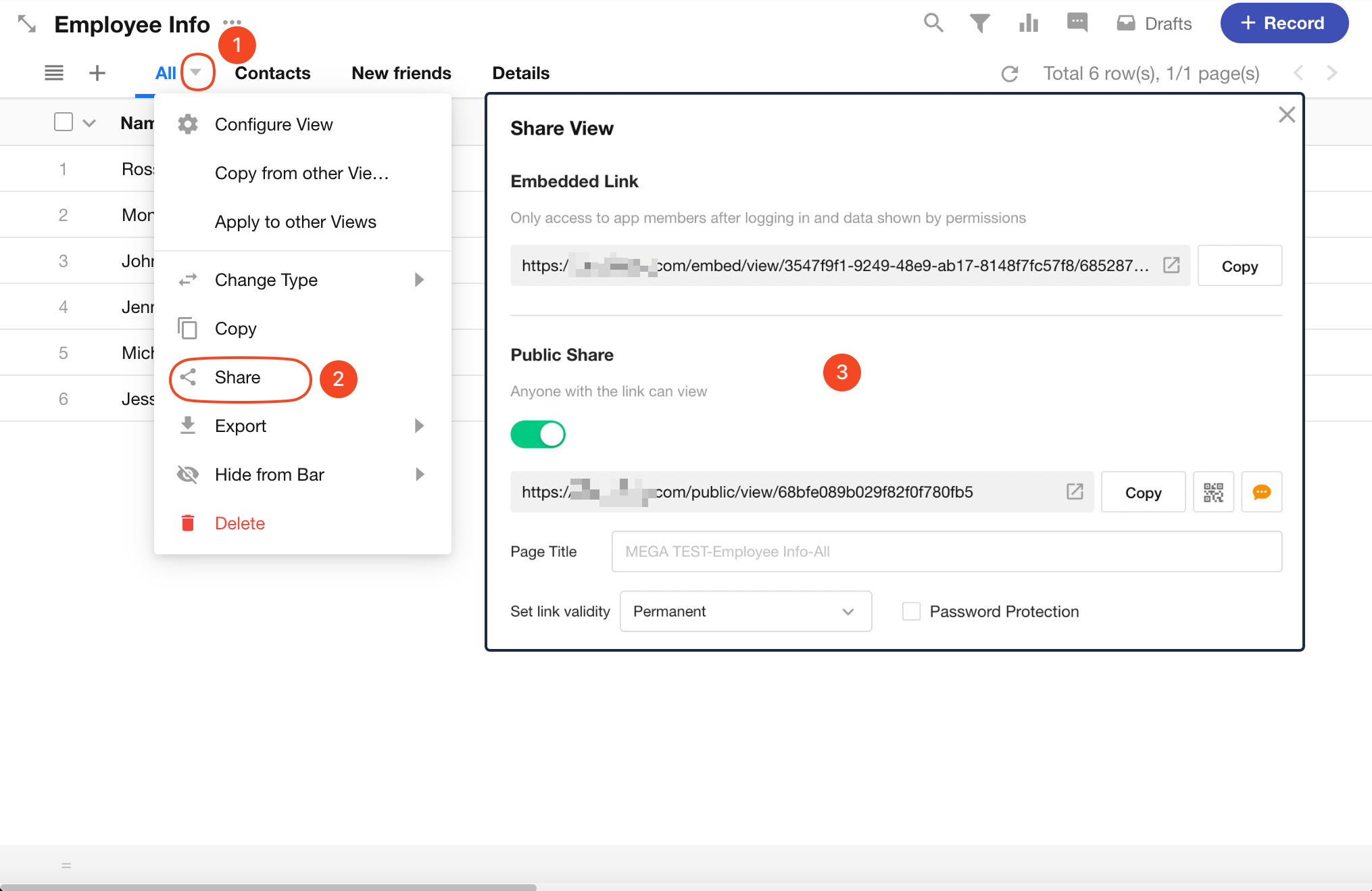

3. Get and Modify the View Link with Parameters
Get the public share link or embed link of the view.
For example, the view's public share link is:
https://www.mingdao.com/public/view/652398198b76fa276cdd95cc

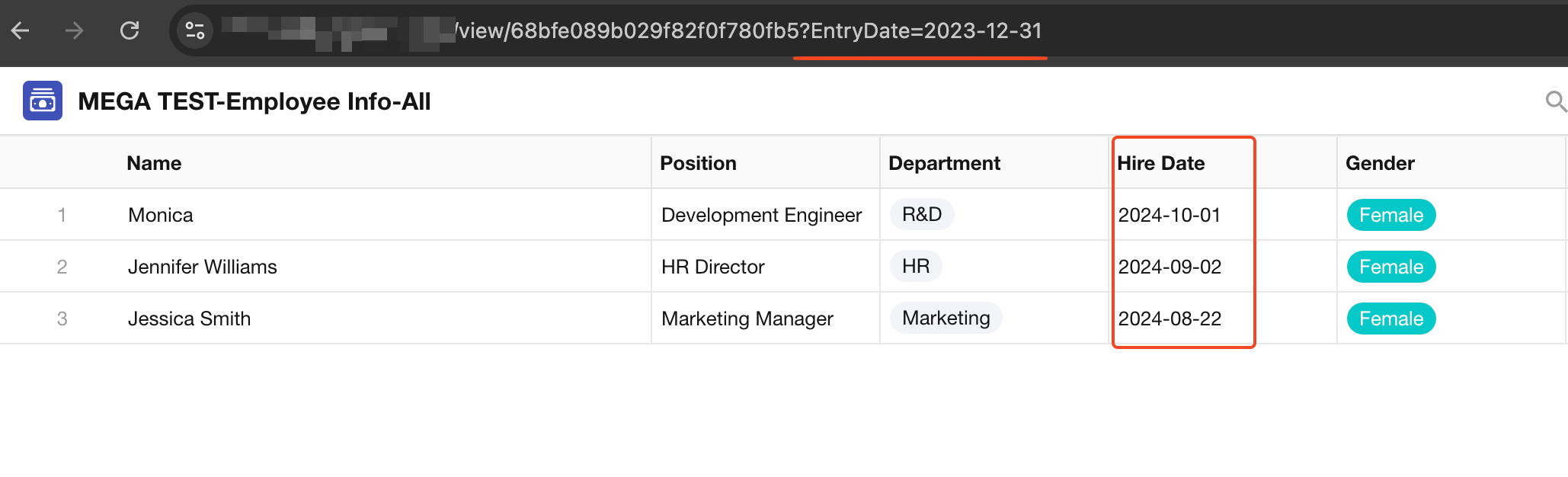

?EntryDate=2023-12-31https://www.mingdao.com/public/view/652398198b76fa276cdd95cc?EntryDate=2023-12-31
This link tells the view to display only employee records with an entry date after 2023-12-31.
