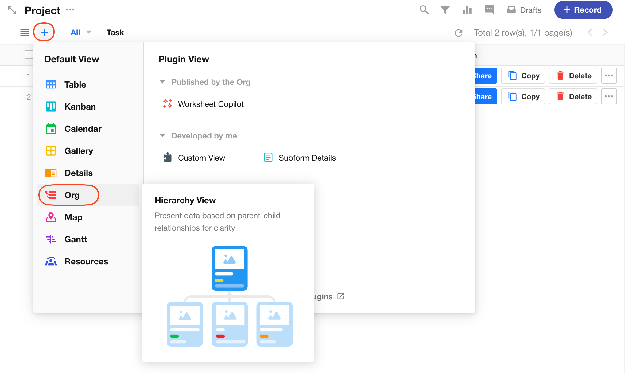

Create an org view with relationship between records in multiple worksheets​
Example: Create an org view to display projects, related tasks and subtasks.
First, make sure that the relationship has been established, meaning the project worksheet is related with the task worksheet, and the task worksheet is related with the subtask worksheet.
1. Create an org view​
2. Select [multiple forms]​
3. Set the worksheets for each level​
Configure the view in the project worksheet, so the first level is the project worksheet, the second level is the task worksheet, and the third level is the subtask worksheet.
