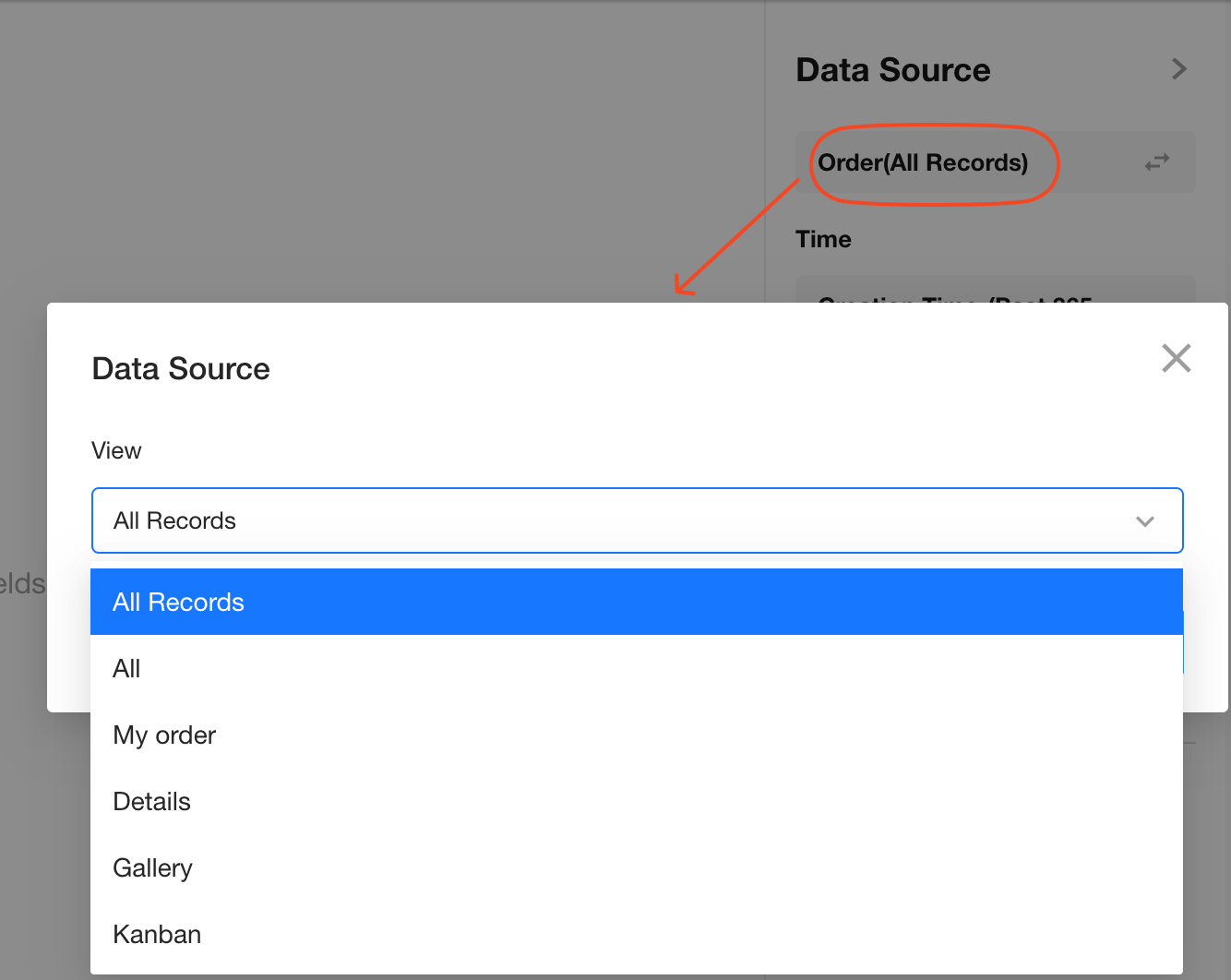

Step 1: Filter Data​

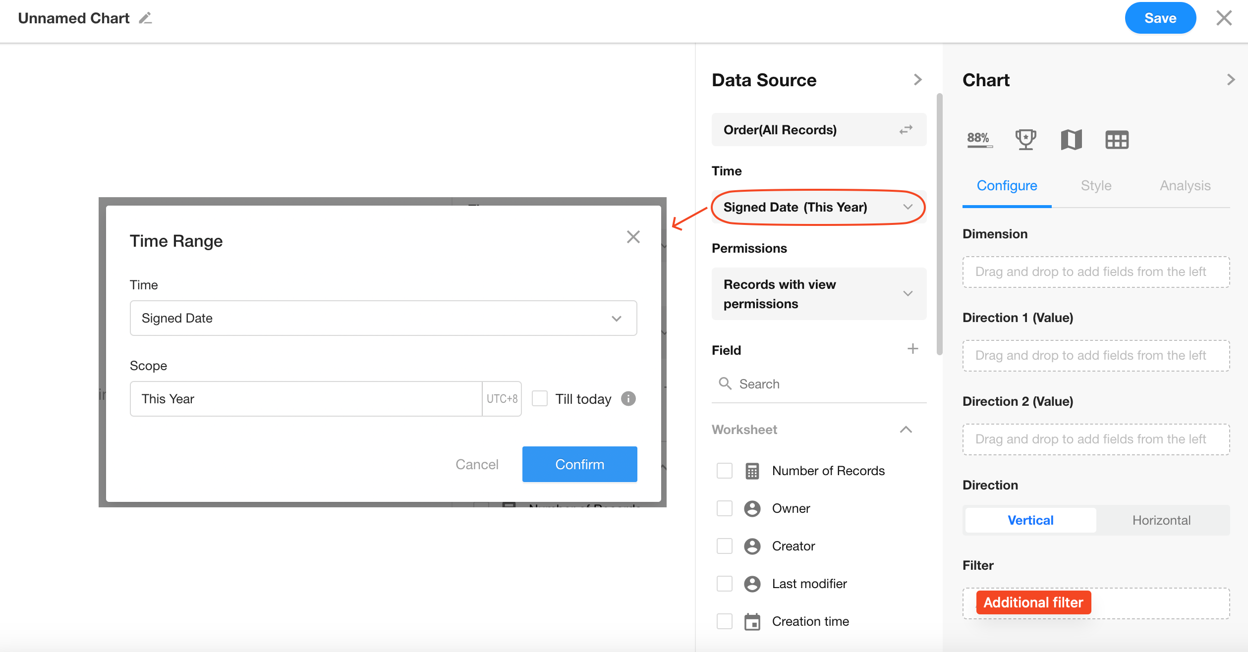

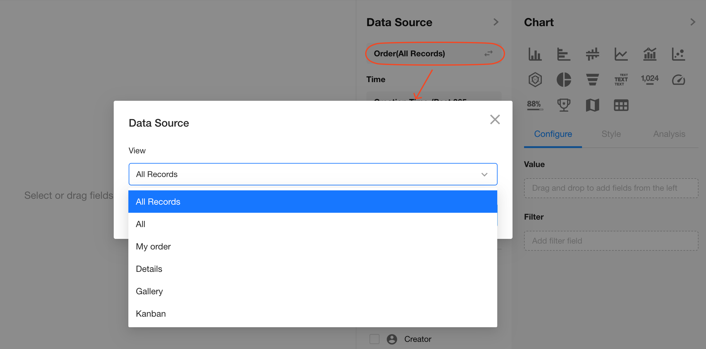

Before configuring the chart, define the data scope.
  • Action: In the Data Source, select all records and add a filter: set Sales Date to This Quarter.
  • Key point: Filtering ensures all calculations focus only on the current quarter, avoiding interference from historical data.

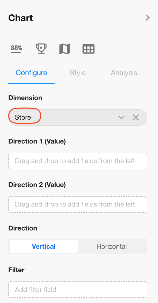

Step 2: Define Analysis Dimensions​
After selecting a symmetric bar chart, configure the axes.

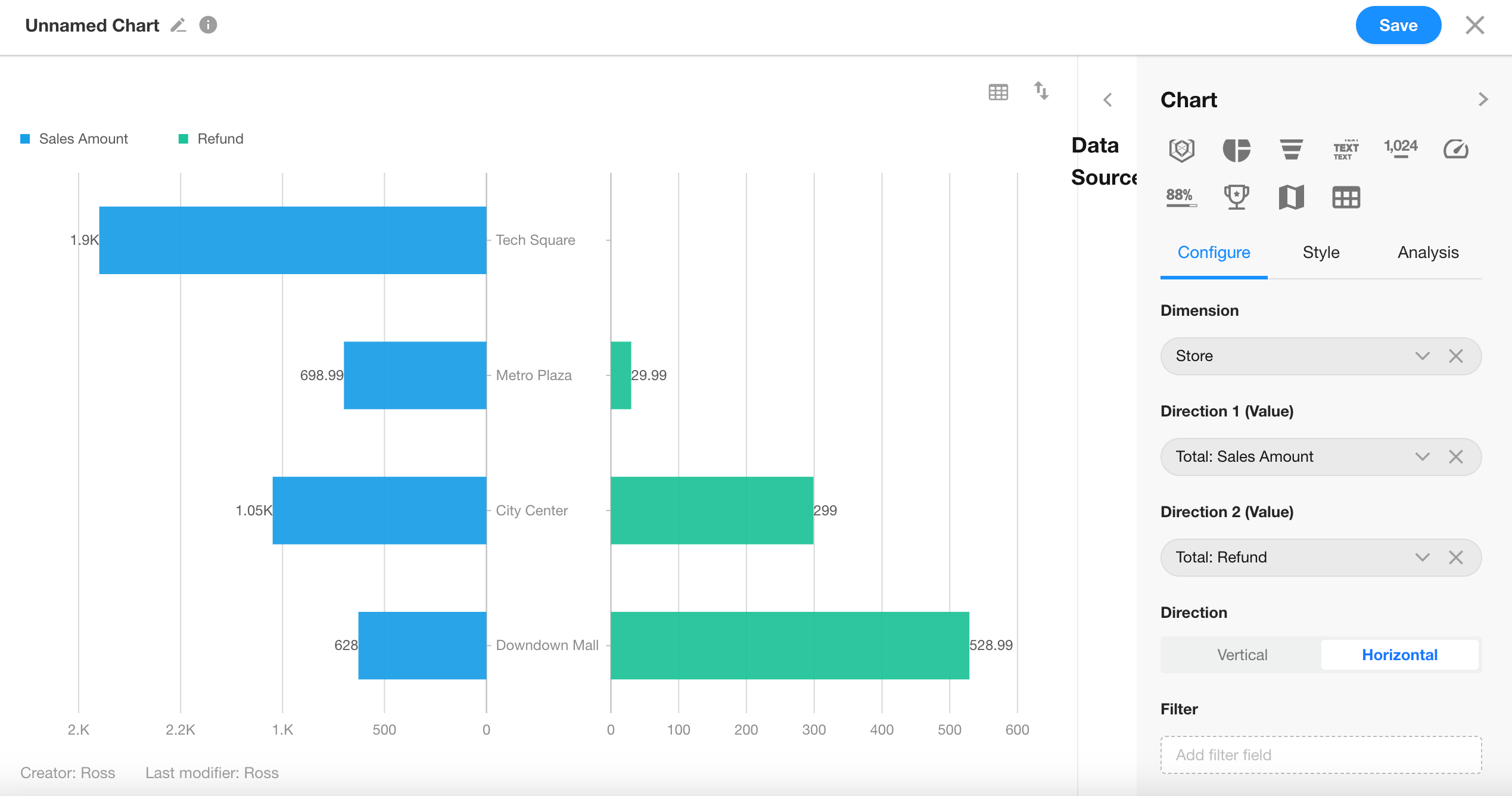

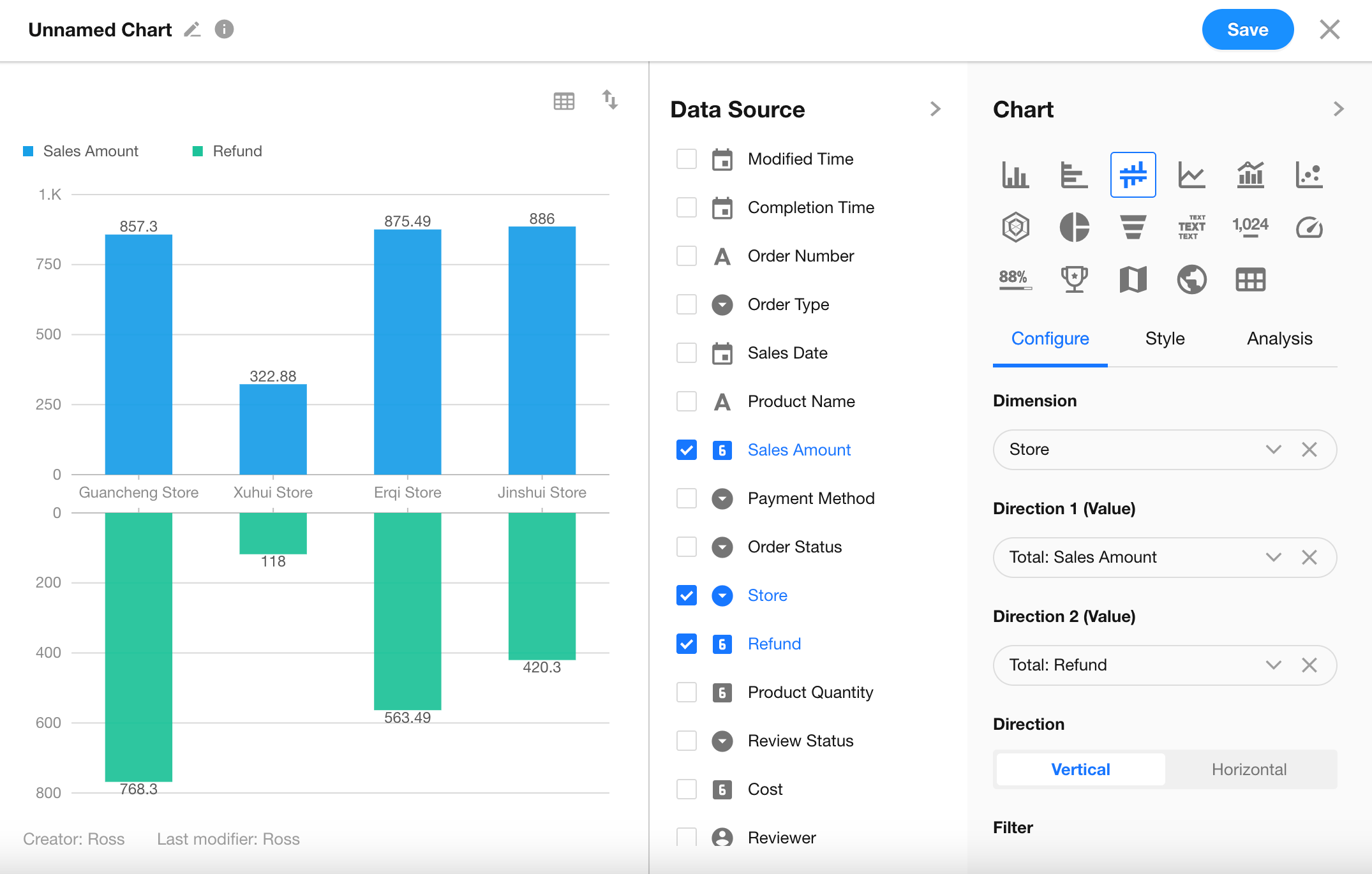

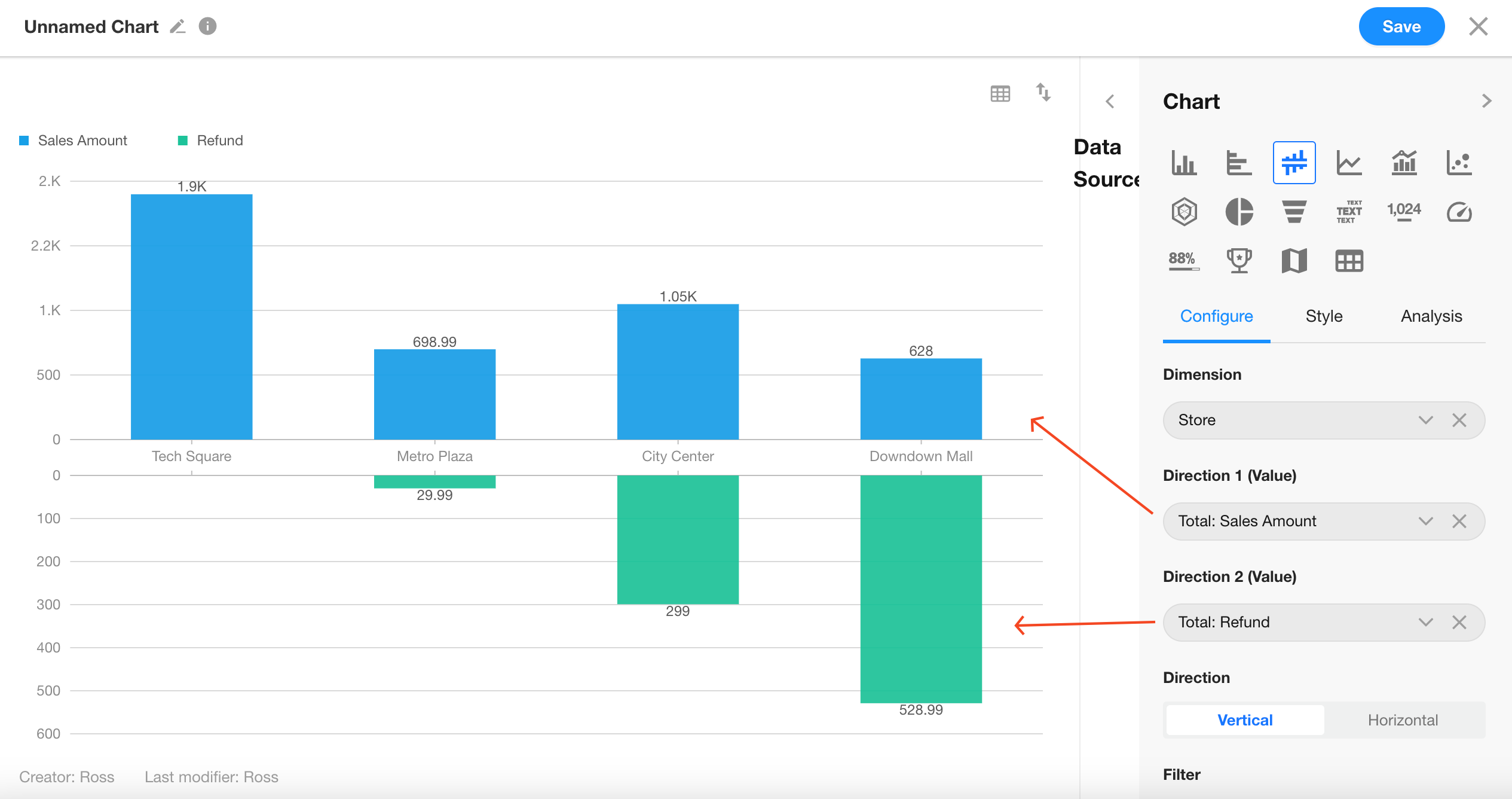

  1. Set Dimension: In Dimension, select the Store field.
  2. Set Metrics (Value):
    • Direction 1 (Value): Select Sales Amount, aggregation method Sum.
    • Direction 2 (Value): Select Refund, aggregation method Sum.

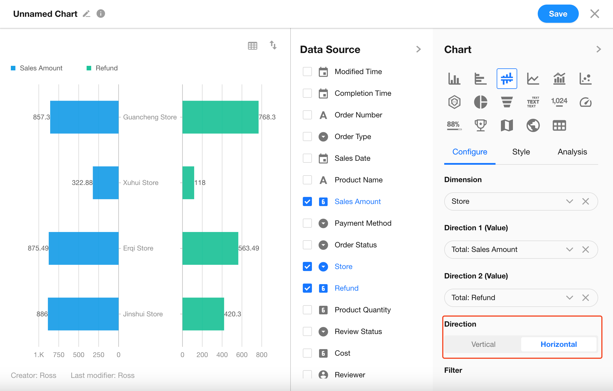

    At this point, bars will be aligned along the central axis, distributed by store.

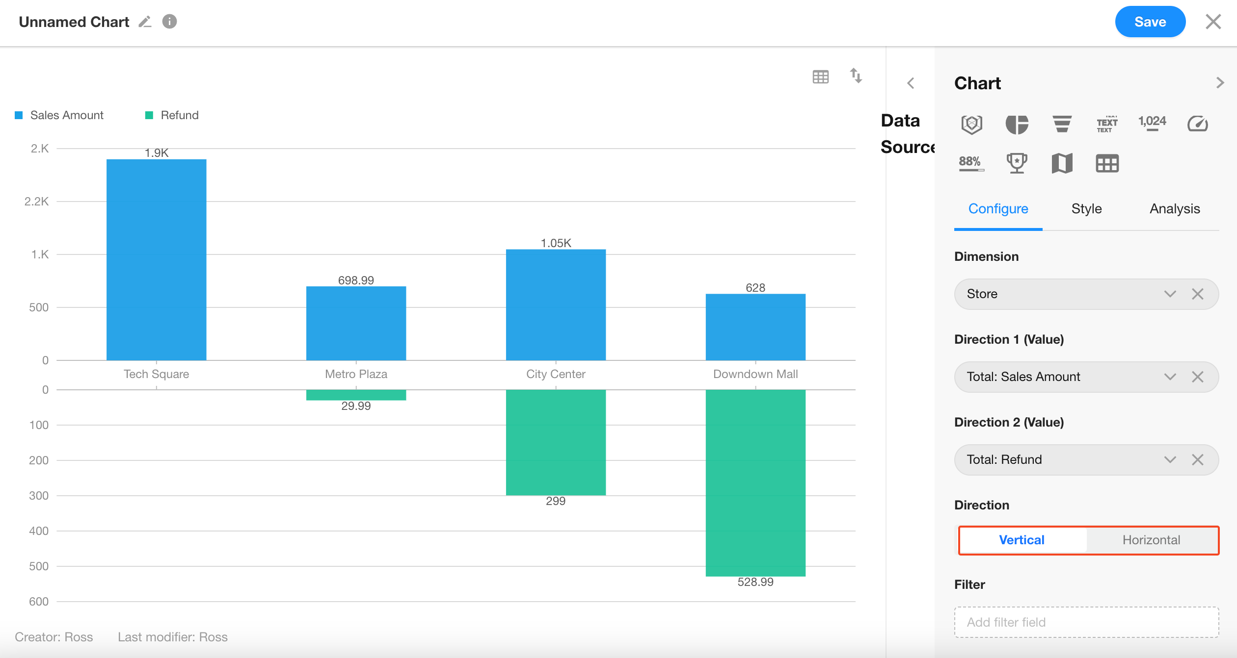

  1. Switch Orientation: In the configuration panel, locate the Direction option.
    • Vertical: Metrics are compared above and below the central axis.
    • Horizontal (Recommended): Metrics extend left and right, making it easier to view store rankings.

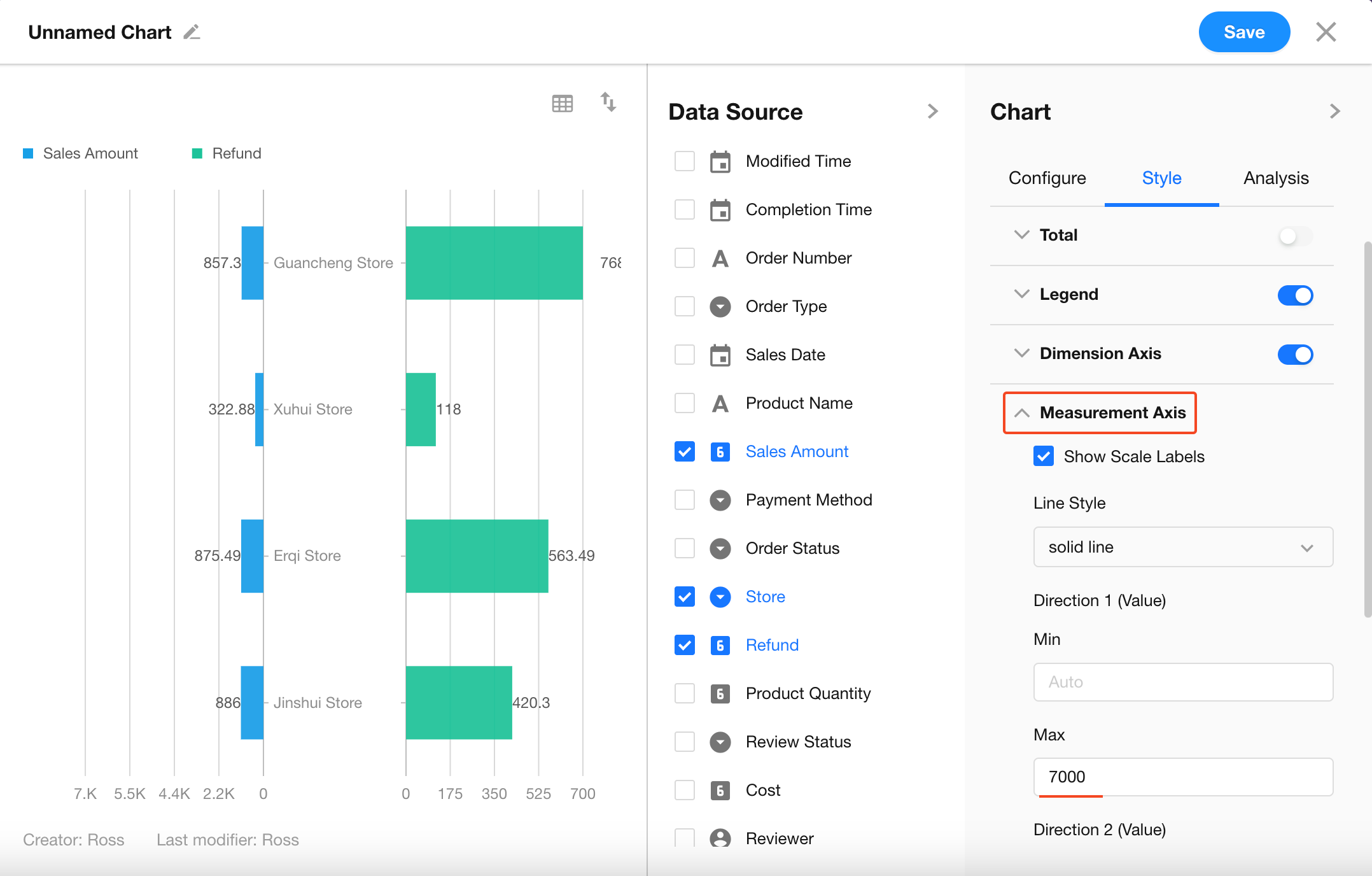

  2. Customize Axis Scale: In Style > Measurement Axis, manually set the maximum values for Direction 1 and Direction 2.
    Tip: Setting equal maximum values on both sides provides a more accurate visual comparison of refunds relative to revenue.

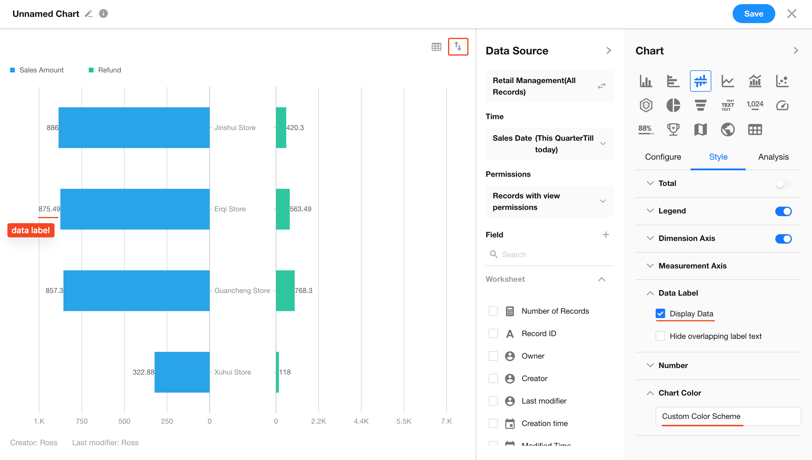

Step 4: Style Settings​
  1. Color Coding: In style settings, assign blue to Direction 1 and red to Direction 2.
  2. Data Labels: Enable Show Value Labels to display values at the end of each bar.
  3. Sorting Logic: It is recommended to sort by Direction 1 (Sales Amount) in descending order, so top-performing stores appear first.
