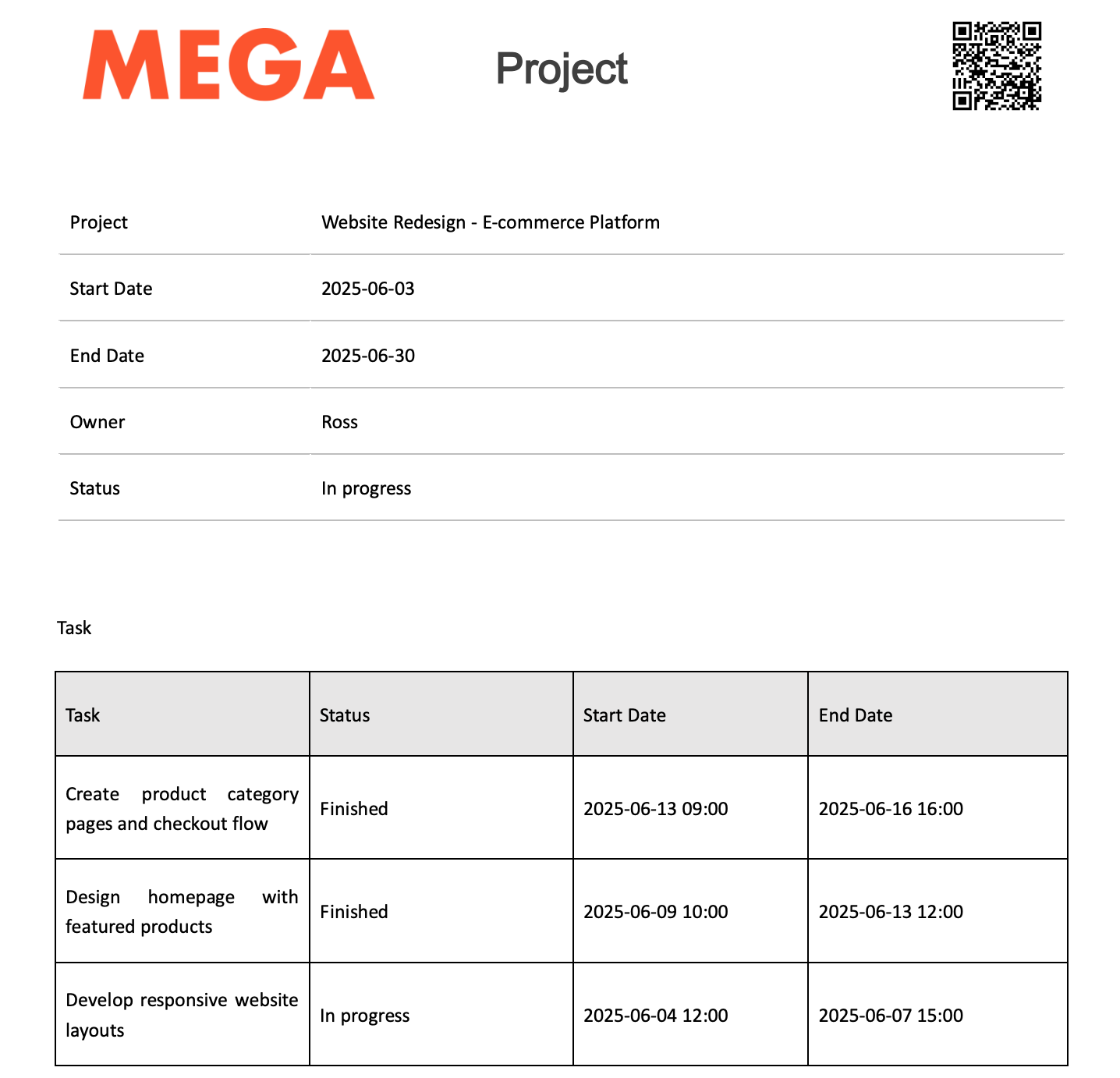

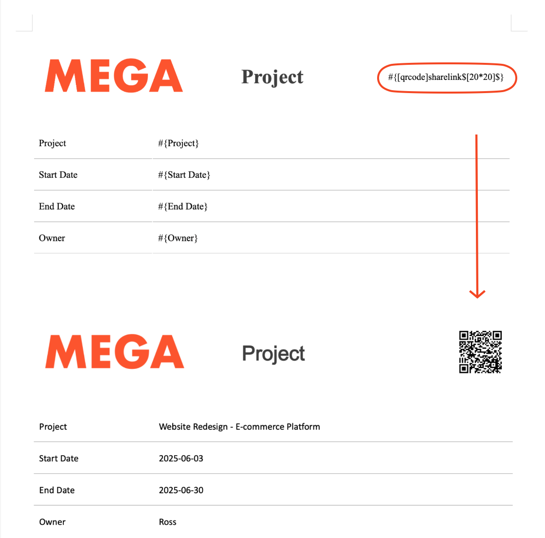

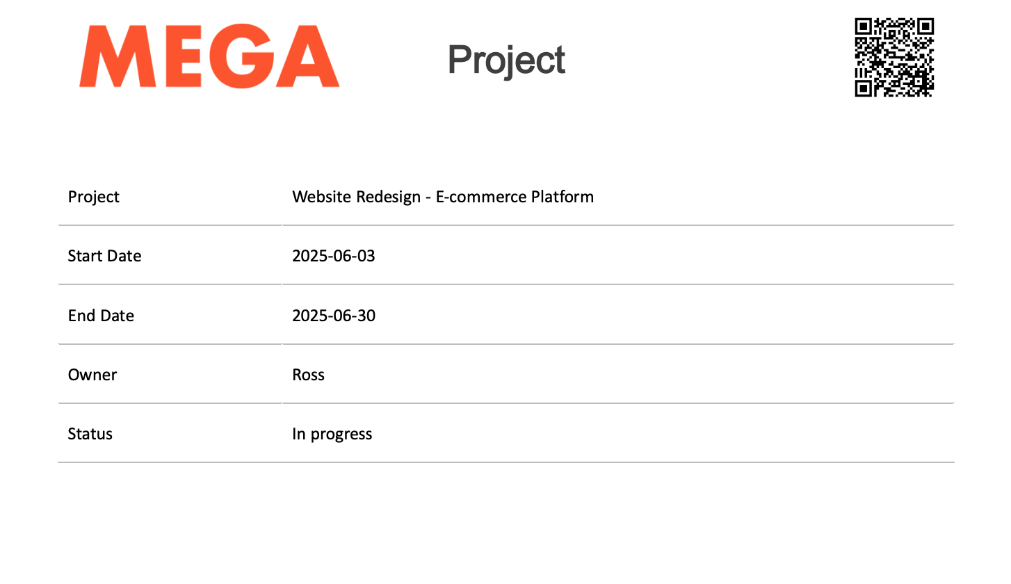

3. Print QR Codes/Barcodes for Fields​
You can generate QR codes or barcodes for specific fields using the following codes:
  • QR code: #{[qrcode]FieldName$[20*20]$}
  • Barcode: #{[barcode]FieldName$[40*10]$}
“FieldName” can also be the field ID. You may customize the dimensions, but do not modify other parts of the code.
QR codes use the QR-Code format, supporting up to 150 characters (including Chinese).
Barcodes use Code128 format, supporting up to 30 characters (letters, numbers, symbols only).
Example:

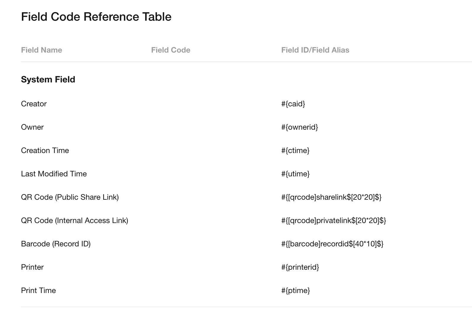

Field IDs for common system fields:
  • Public Share Link: sharelink
  • Internal Access Link: privatelink
  • Record ID: recordid

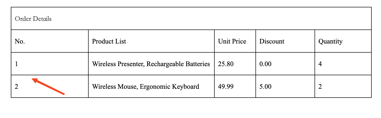

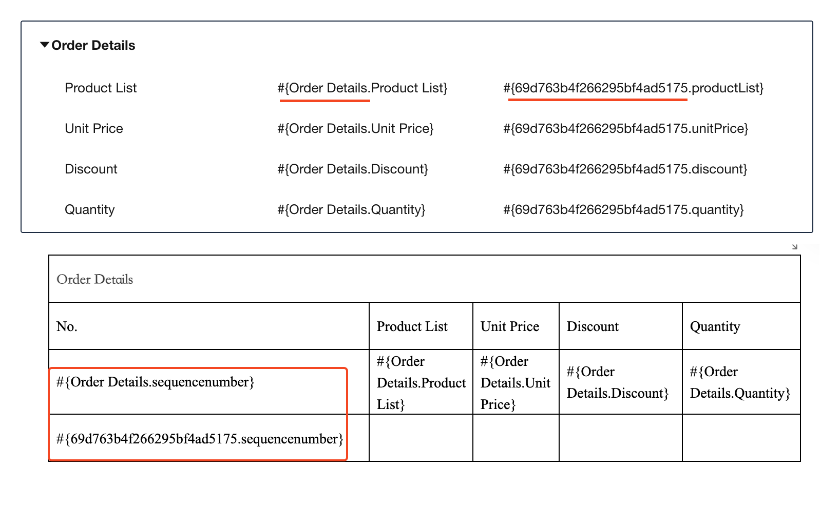

Row Numbers in Related Worksheets​
If you need to display row numbers when printing related worksheets or subforms, you can use the special code sequencenumber.
Format: #{DetailWorksheetName.sequencenumber} or #{DetailWorksheetID.sequencenumber}
Template Design:
Print Output:

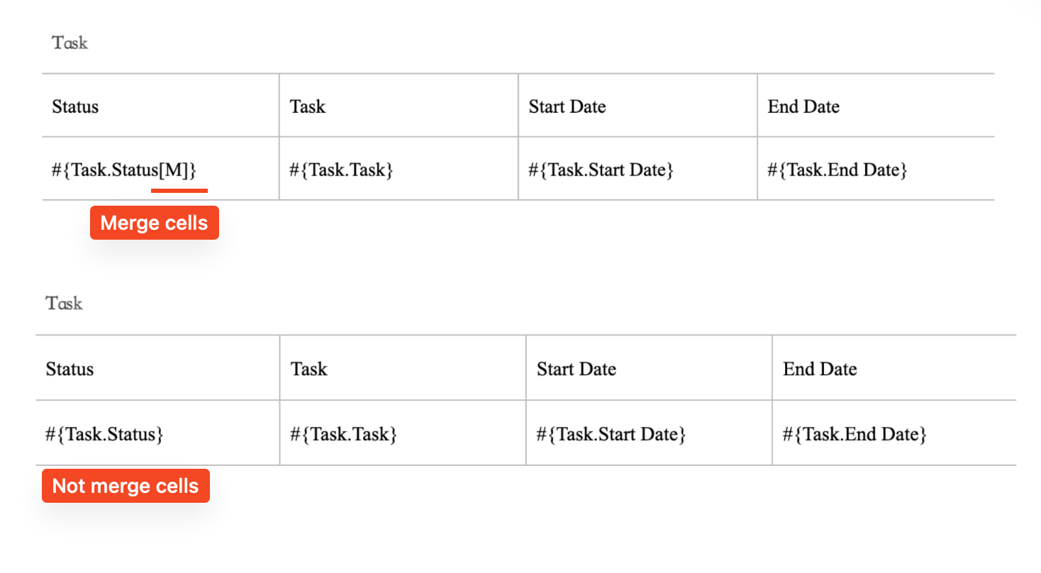

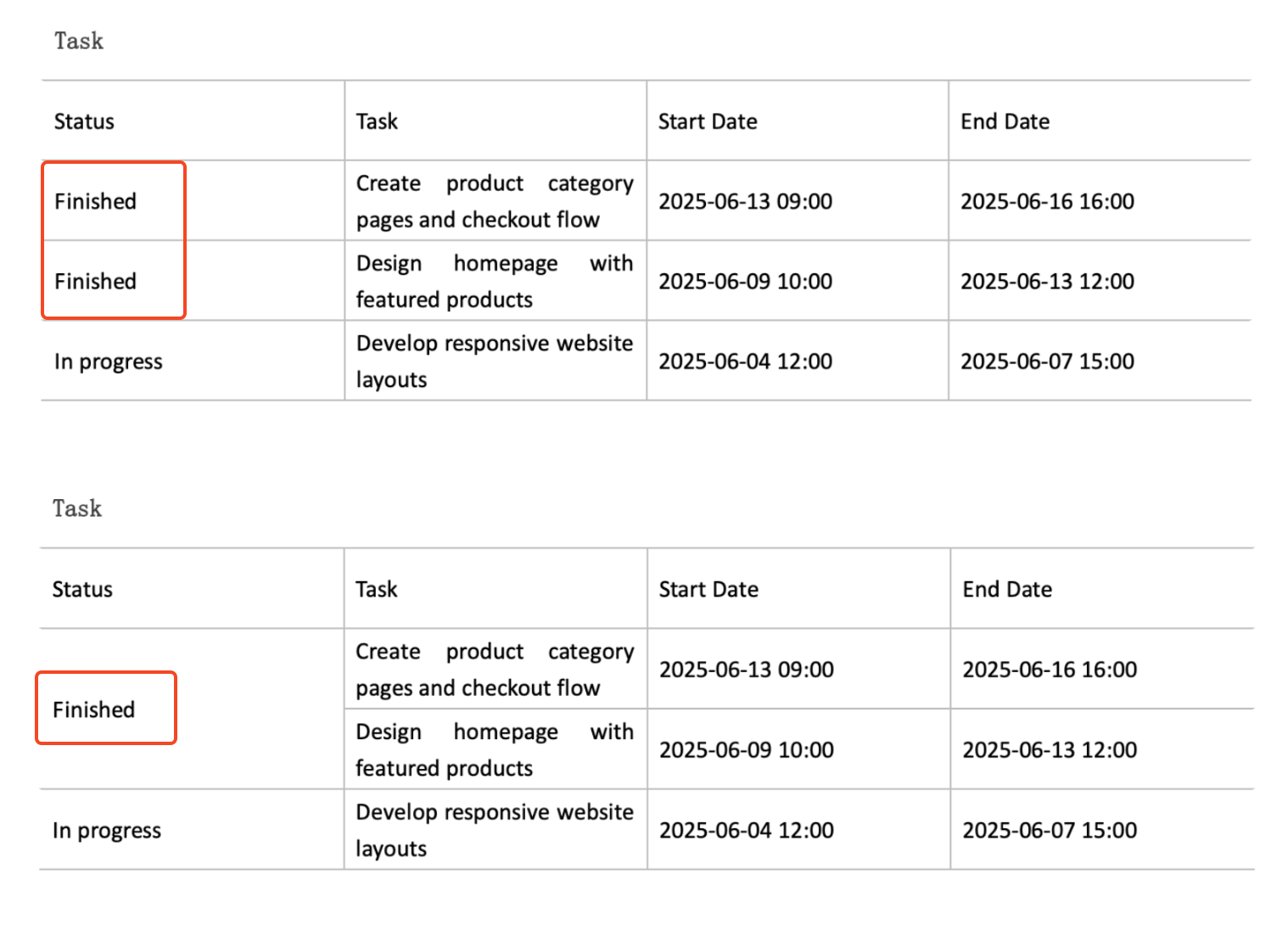

Merge Cells​
When cells in the same column have identical values across rows, they can be merged.
Field code for merging vertical cells:
#{SubformName.FieldName[M]}
Print Output:

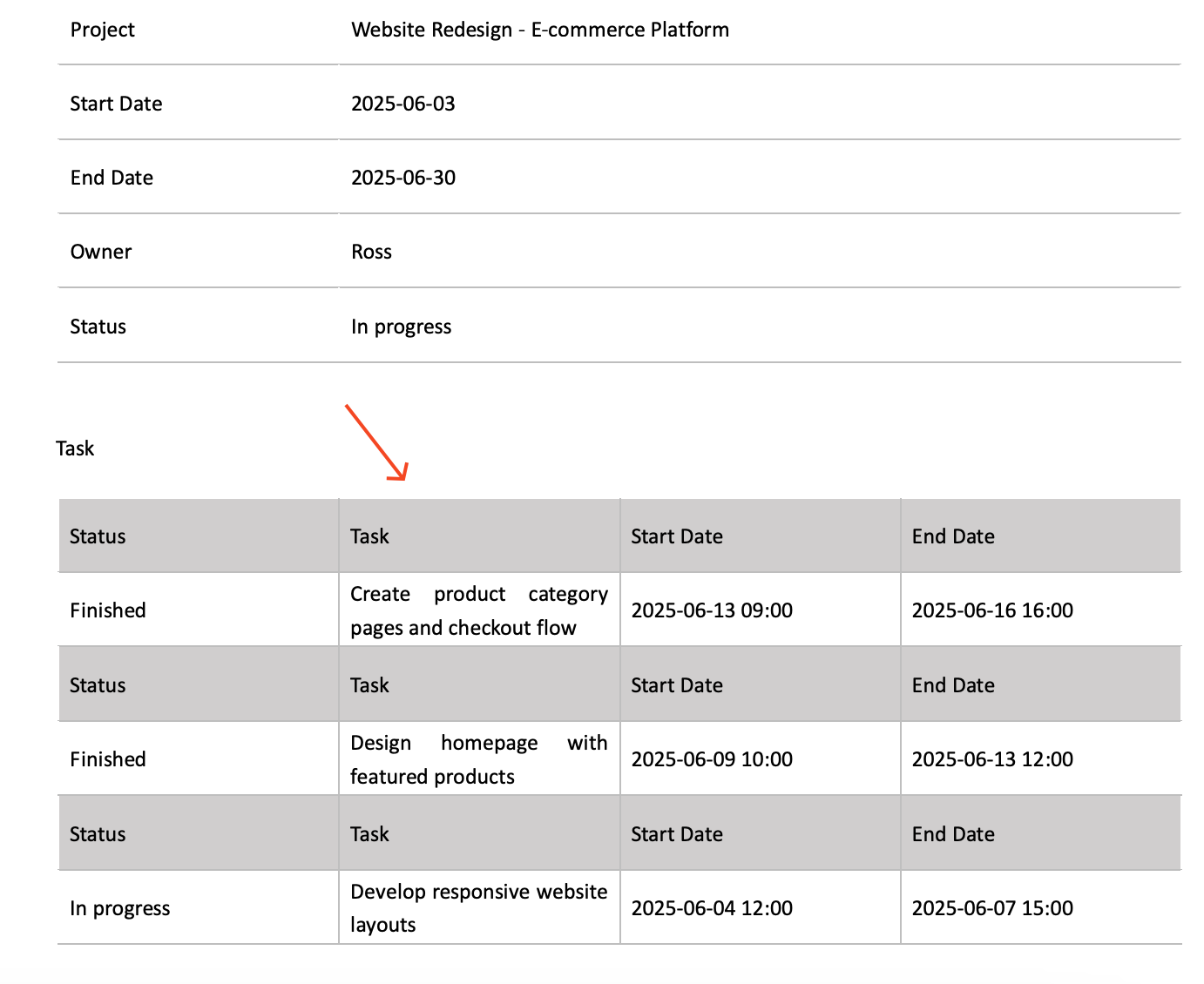

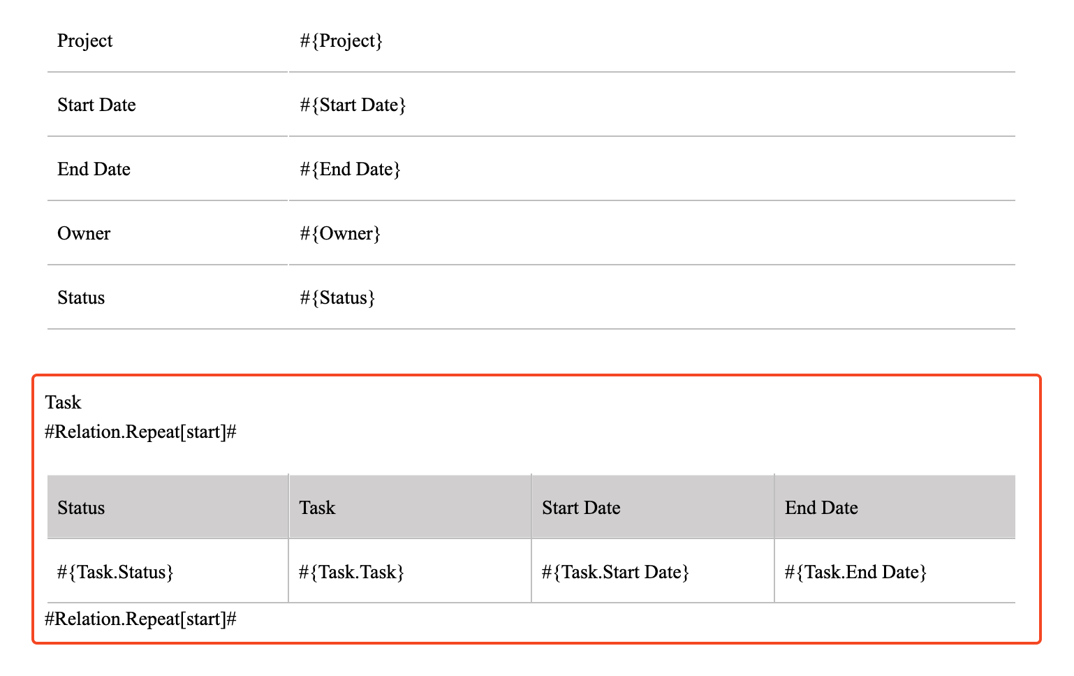

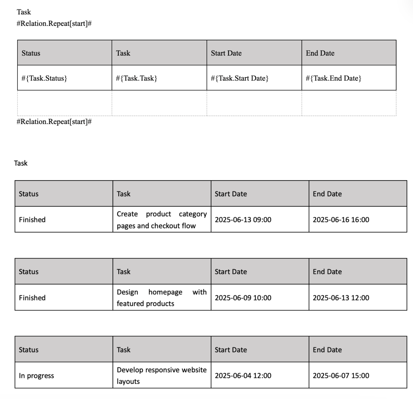

Method 2: Print Each Record Individually​
If you want to print each related record or subform entry separately (with headers repeated), insert the following tags:
#Relation.Repeat[start]#
#Relation.Repeat[end]#
These tags must be placed in their own rows, not within the same cell as other content.
For example: printing each order item record individually.
Template Design:
Print Output:
Tips:
If you want a blank row between records, insert one manually in the template and set its border to "none".

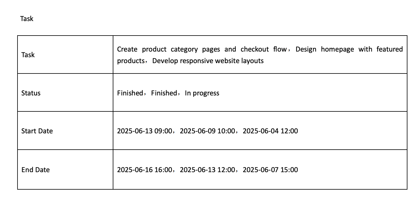

Method 3: Concatenate Values of a Field Across Records​
This method concatenates values of the same field across multiple records using commas. Just add [S] to the end of the field code.
Template Design:

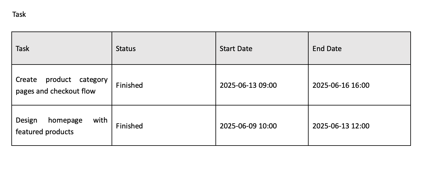

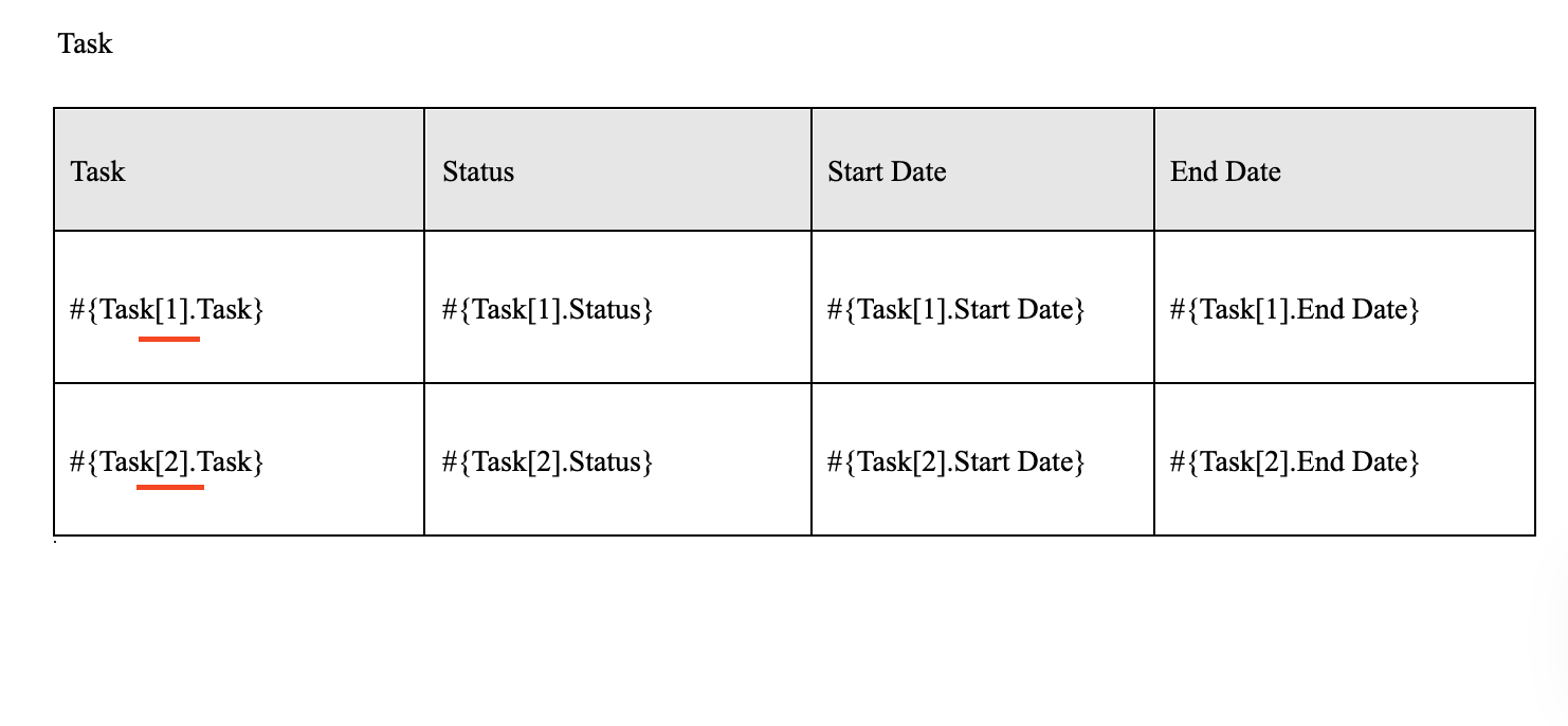

Method 4: Print Specified Records​
If the subform has 10 records but you only want to print the first few rows, you can append an index to the subform name.
Example below prints only the first two records:
Template Design:
Print Output:

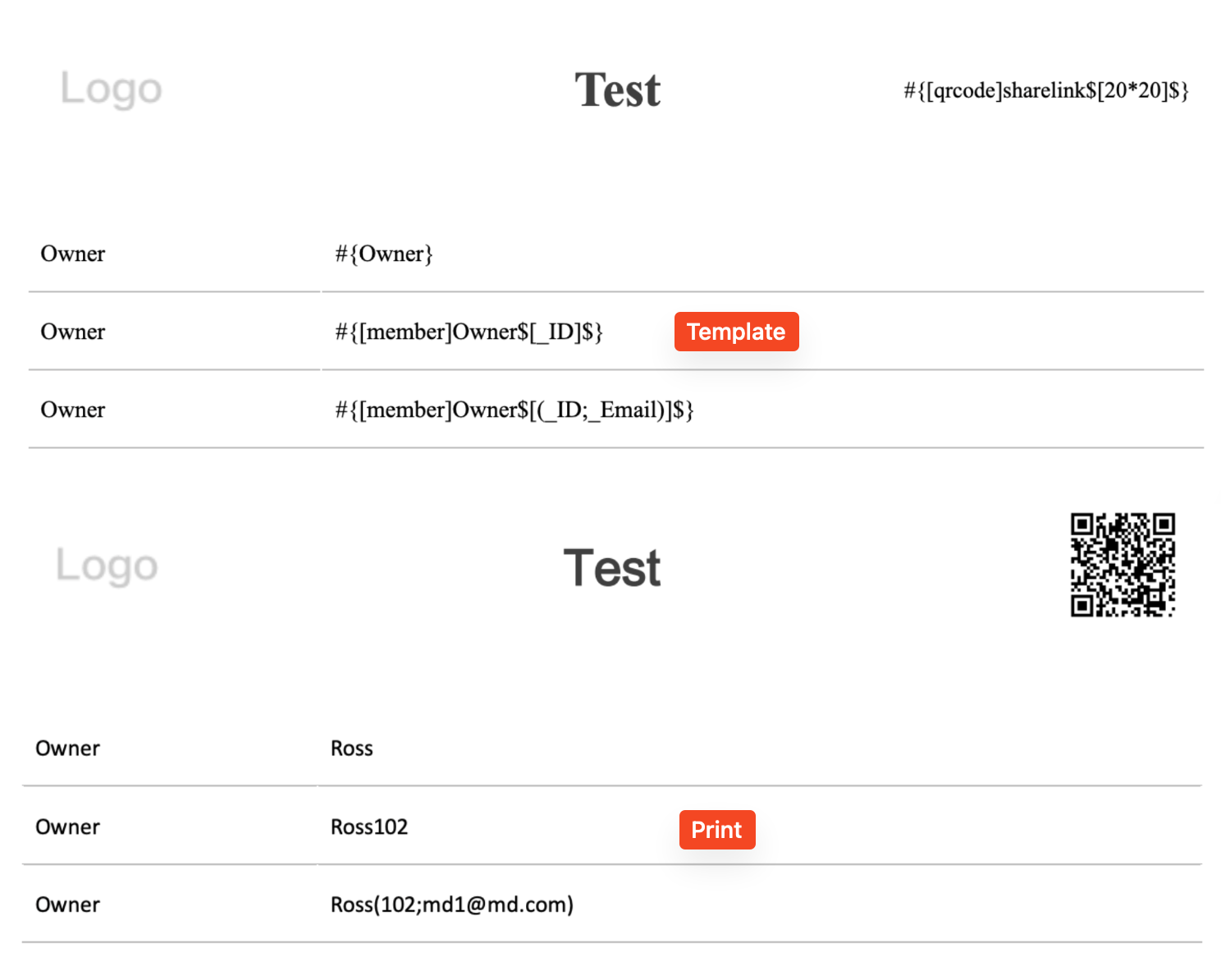

5. Print Phone/Email for Members Fields​
When printing members fields, you can include not only names but also Employee ID (_ID), Email (_Email), and Phone Number (_Phone). These can be inserted into the field code using a special format.
Format: #{[member]MemberFieldID$[AccountInfoCode]$}
Example: A members field "Owner" has the value Ross, with ID 102 and Email md1@md.com.
  • Print only name: #{Owner} → Output: Ross
  • Name + ID: #{[member]Owner$[_ID]$} → Output: Ross102
  • Name + ID + Email: #{[member]Owner$[(_ID;_Email)]$} → Output: Ross (102;md1@md.com)
Use () to wrap the extra info and ; to separate items.

7. Print Time/Printed By​
In addition to field data, you can also print metadata such as:
  • Print time
  • Printed by
  • QR codes
  • Barcodes
  • Creation time
  • Last modified time
Just insert the corresponding field codes or aliases into the template.
