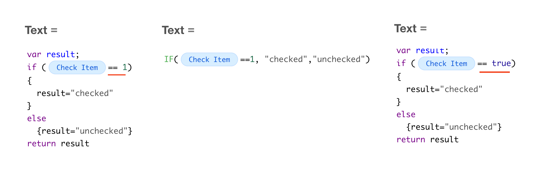

To retrieve or evaluate the value of a check item field, check whether the value equals 1 or 0, or true or false.

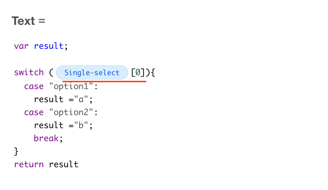

The value of a single select field is stored as an array containing a single element. To retrieve or compare the selected option in a formula, append [0] to the field reference.

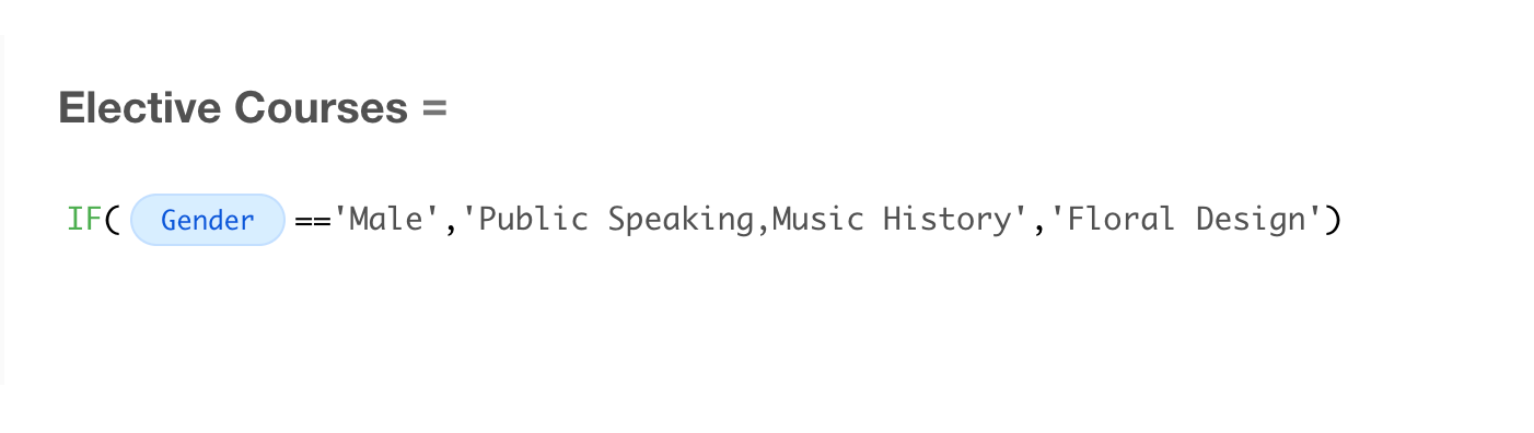

Method 1: Use a comma-separated text string.
To select Option 1 and Option 3 by default:
'Option 1,Option 3'

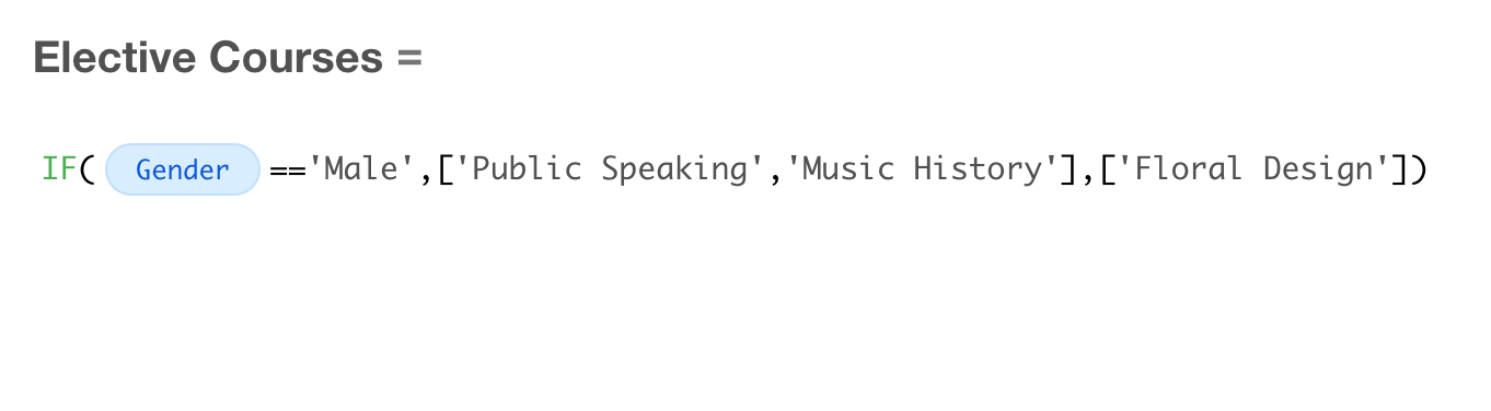

Method 2: Use an array.
To select Option 2 and Option 3 by default:
['Option 2','Option 3']
Example: If the Gender field is Male, the Elective Courses field defaults to Public Speaking and Music History. If the Gender field is Female, it defaults to Floral Design.
Method 1
Method 2
