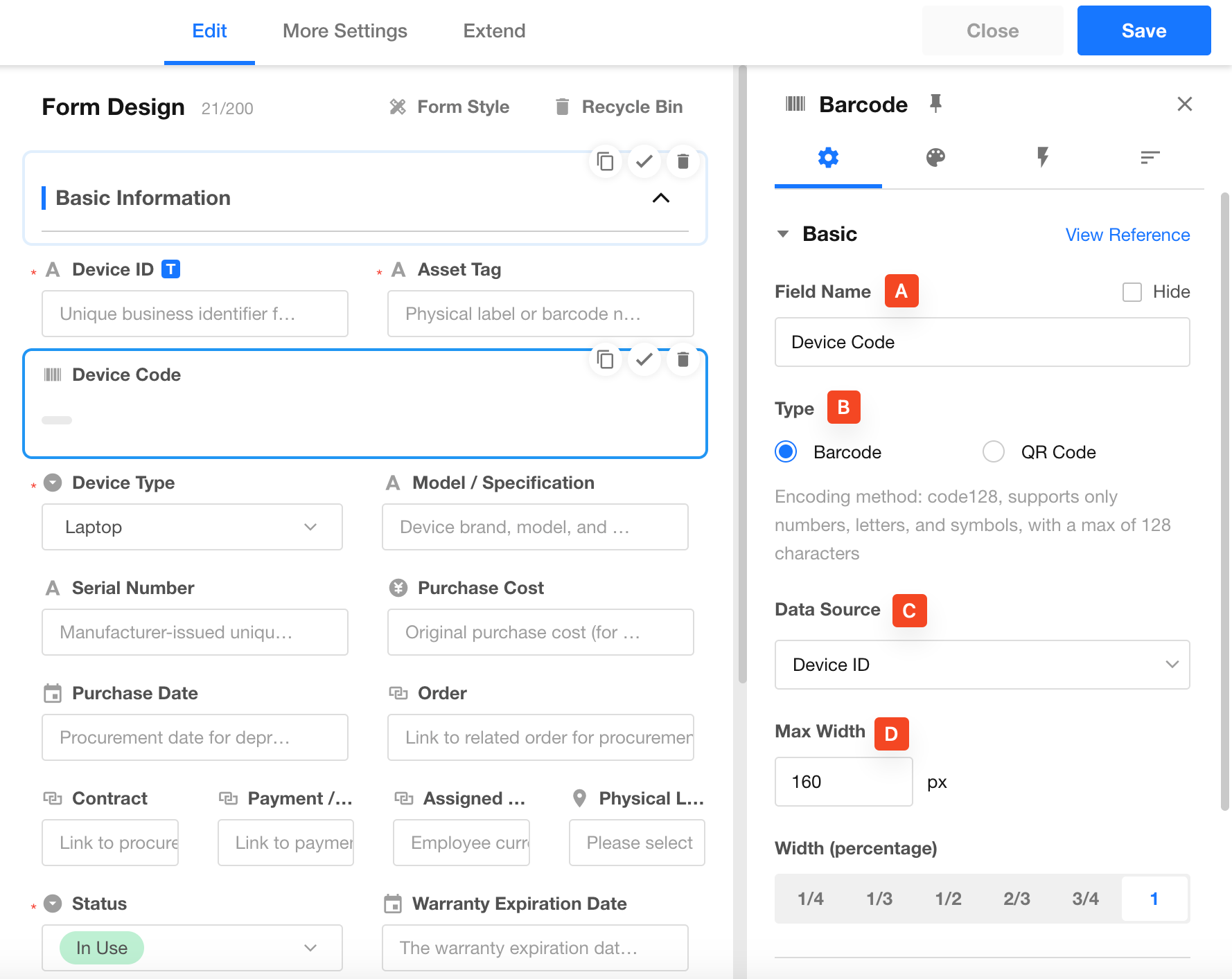

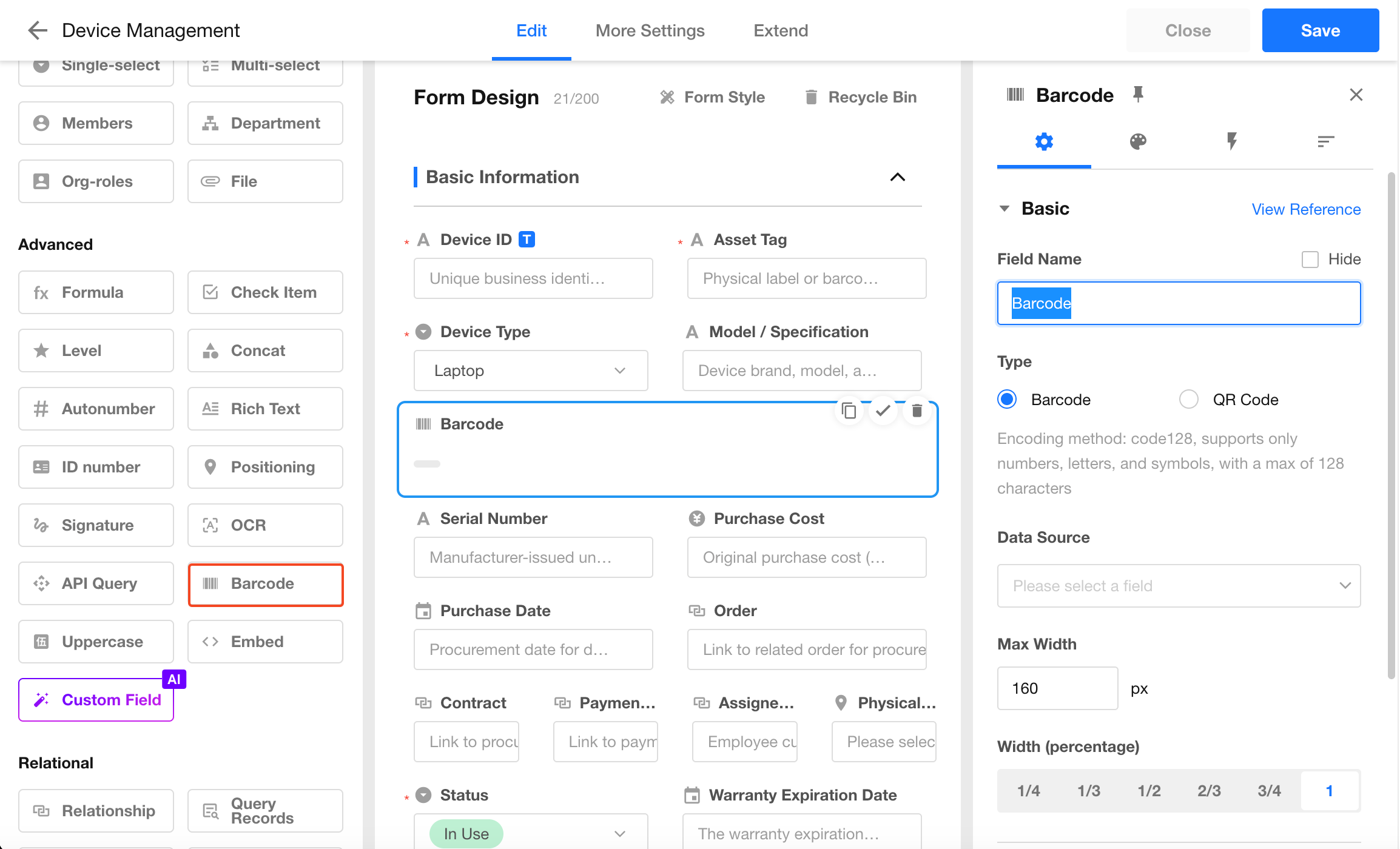

1. Add the barcode control
2. Set the barcode control
  • A Name: Modify it to Order Barcode
  • B Type: Select Barcode
  • C Data source:
    The data source refers to which field's content will be converted into a barcode. Here, select the Order NO. field.
    When selecting the data source, the first optional field is the row ID, which is a system field representing a unique code of the current record. Through this ID, the current record can be located. For more details about row ID, check out this article.
  • D Maximum width
    The maximum width at which the barcode is displayed on the page (height is adjusted proportionately).

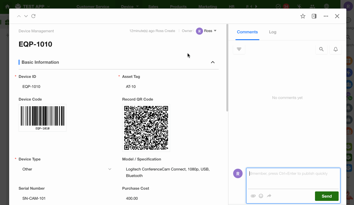

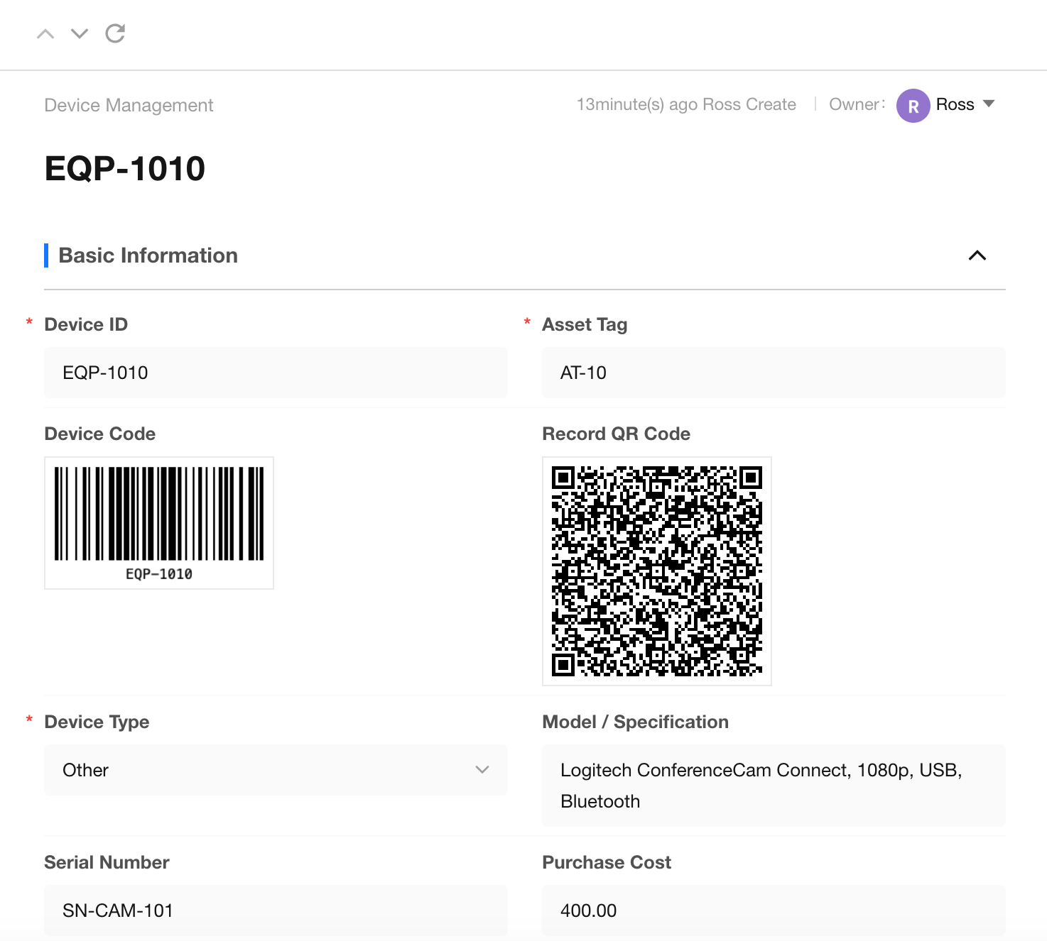

After saving the settings, you can directly open an existing record to view the Order Barcode field.

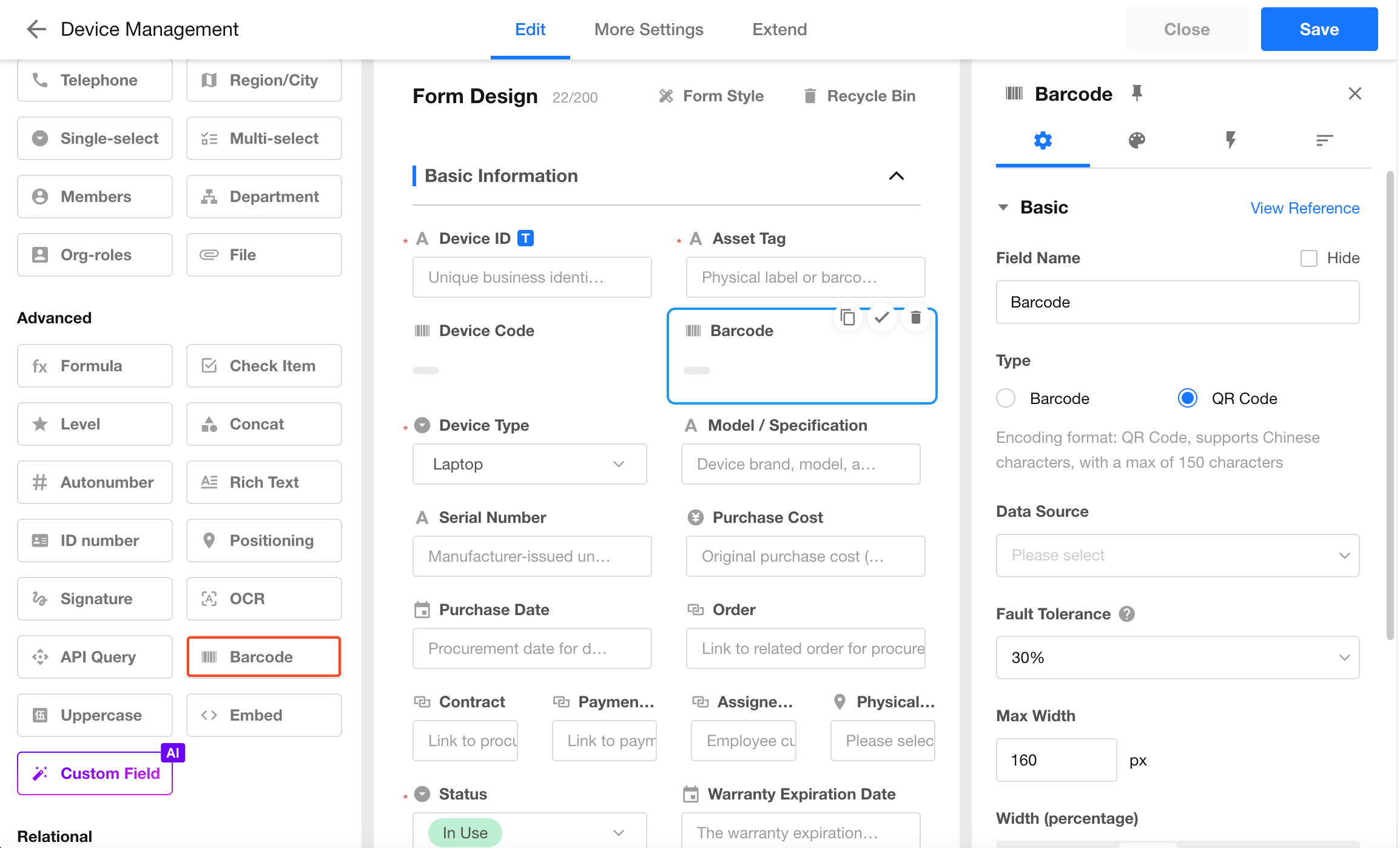

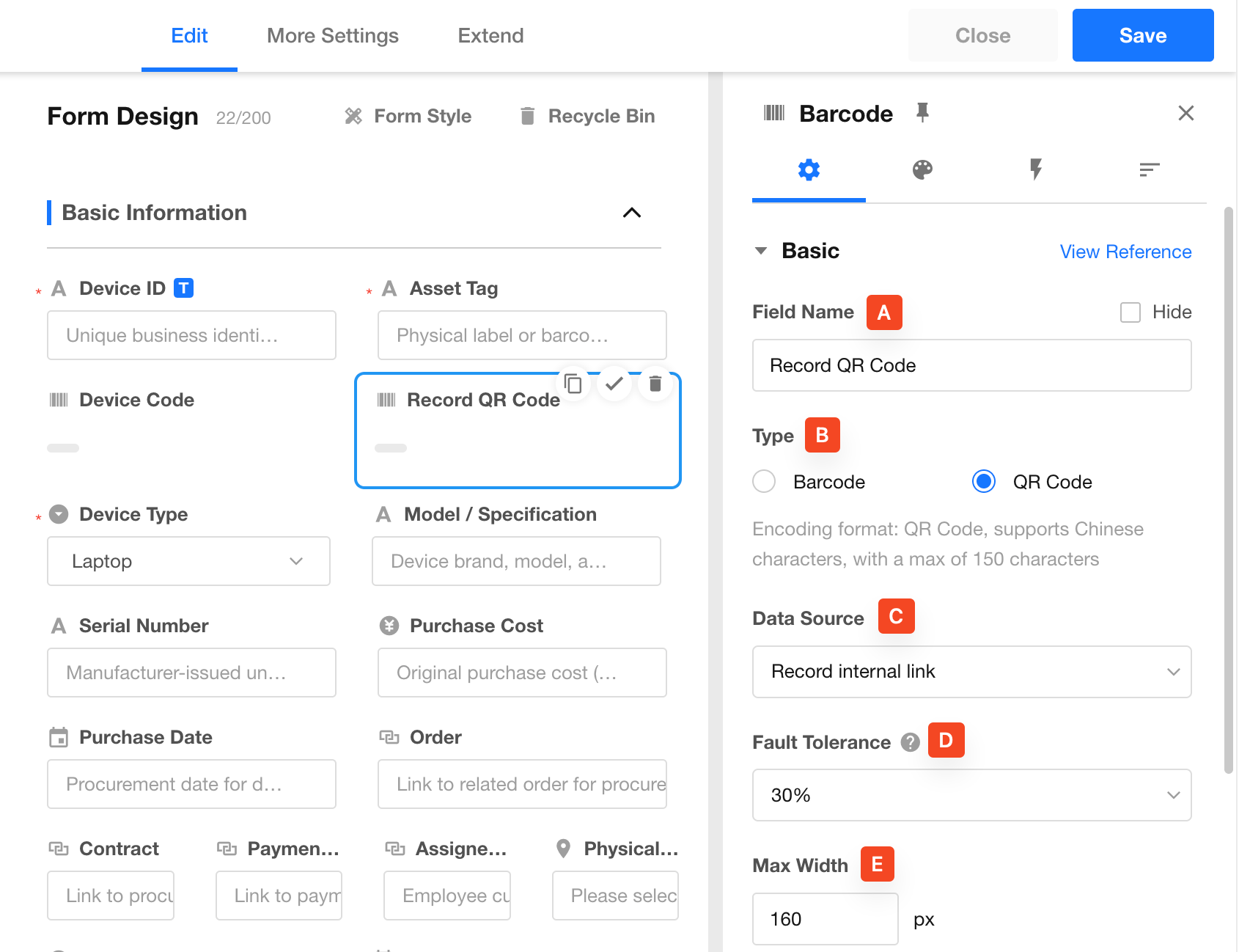

2. Set the control
  • A Field name: Order QR Code
  • B Type: QR code
  • C: Data source

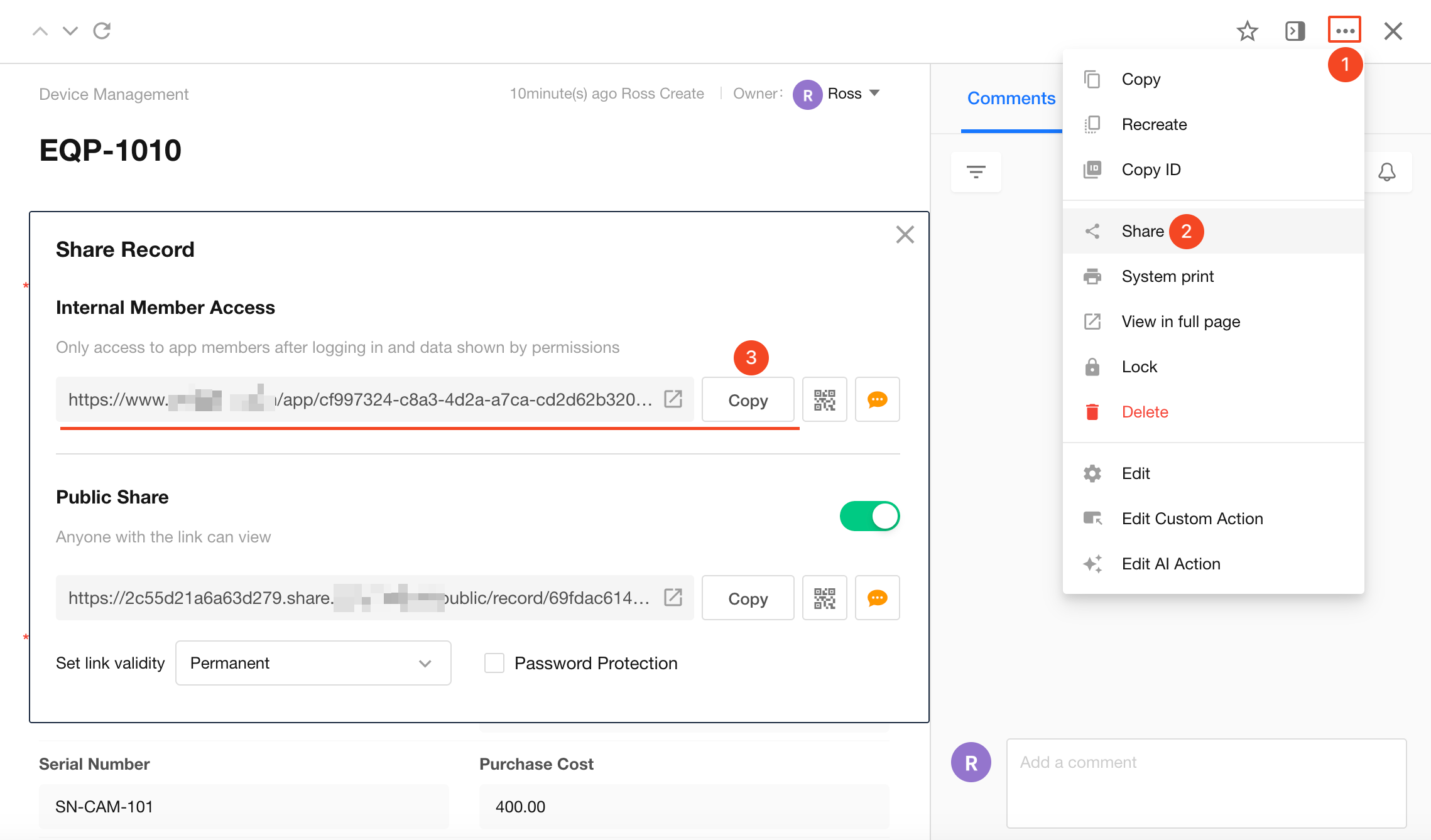

    For the data source of the QR code, you can choose a field or the internal link to the current record for application members. Here, we choose "Internal access link". The link here is the same as the one you get in the image below.
  • Fault tolerance
    Fault tolerance refers to the ability of the QR code to be scanned even when it is partially obscured. The higher the fault tolerance level, the easier it is to scan the QR code, and the more complex the QR code image will be.
  • Maximum width
    The maximum width at which the QR code is displayed on the page (height is adjusted proportionately).
After saving the settings, you can directly open an existing record to view the Order QR Code field.
