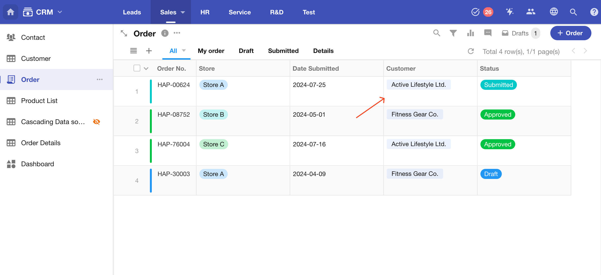

Use Case: As shown below, the Order worksheet is related to the Customer worksheet (a one-way relationship, meaning the Customer worksheet is not related to the Order worksheet). Now, we want to enable users to view all orders related to a specific customer directly in the Customer worksheet using the Query Records control.

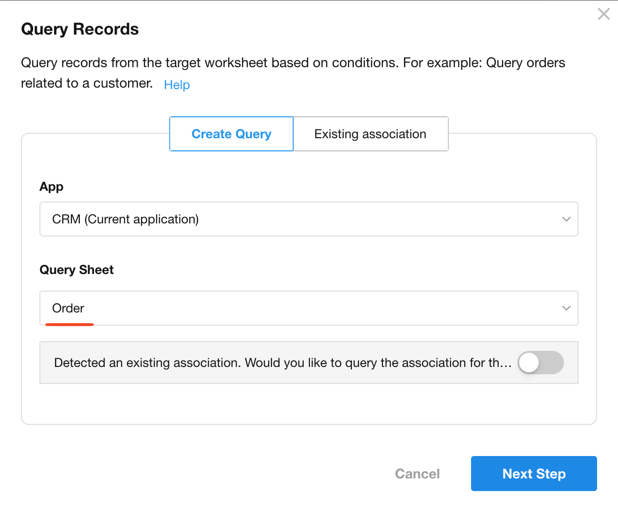

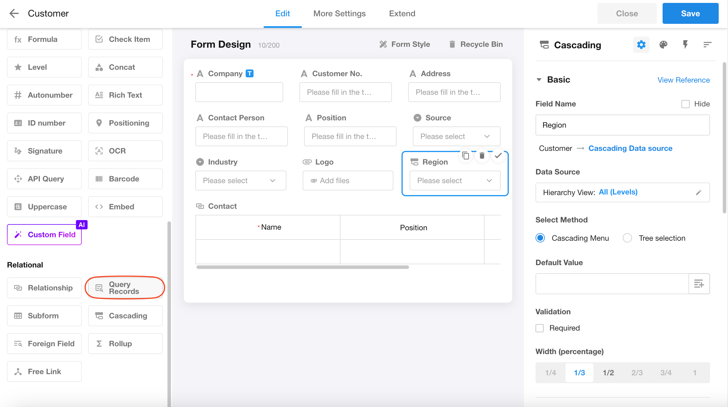

Add a Query Records control
In the Customer worksheet, add a Query Records control.

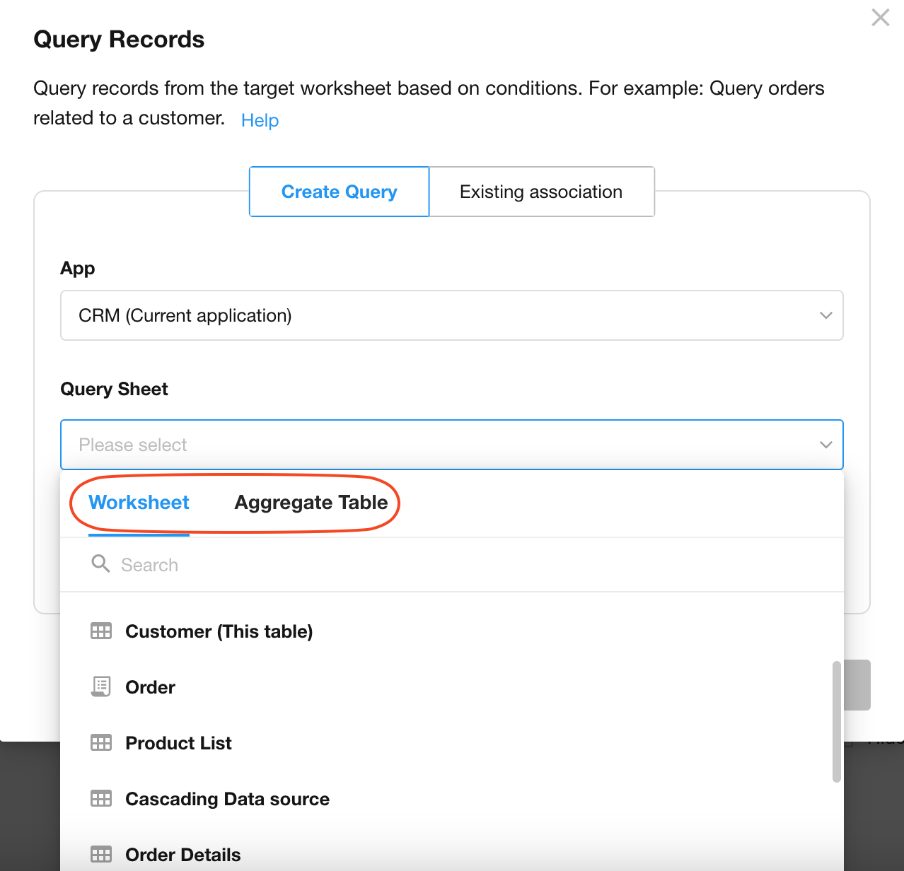

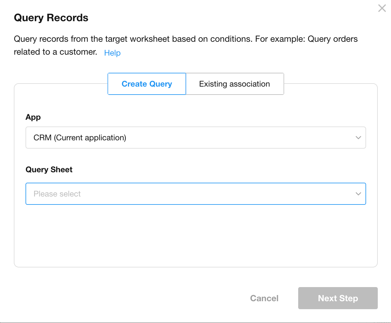

Select the worksheet/aggregate table to query
Here, we select the Order worksheet to query.
Configure query method and conditions
There are two ways to configure query conditions: Create Query and Existing Relationship.
Create query: Configure query conditions from scratch.
Existing relationship: Select an existing worksheet relationship and then refine the query conditions.

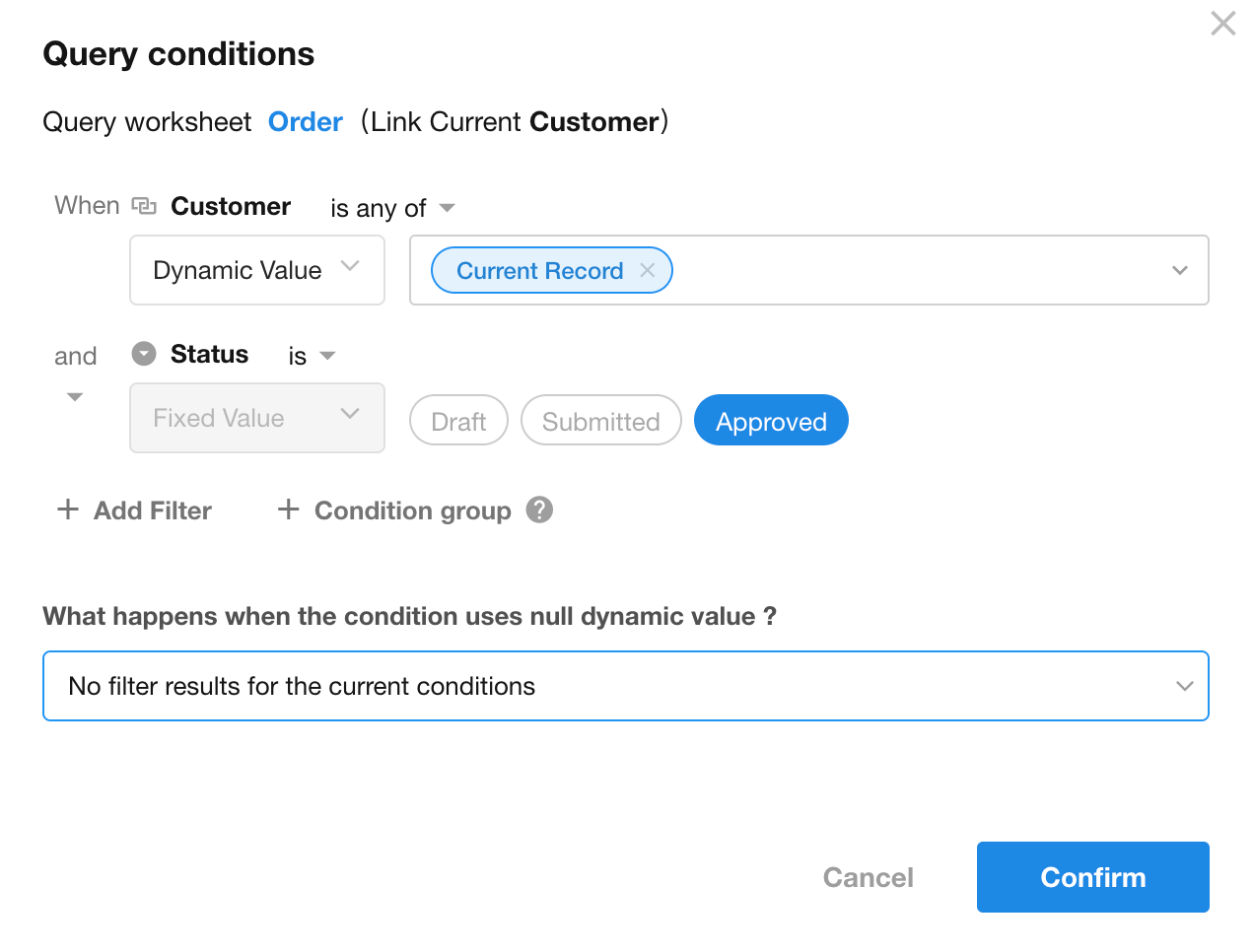

What happens when dynamic values used in query conditions are empty?
Create query

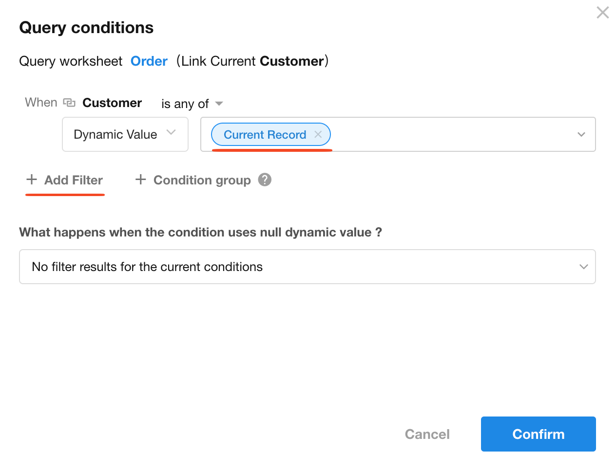

For example, to query the approved orders of the current customer, select the Order worksheet to query, then click Next to configure query conditions.
Configure Query Conditions:
Condition 1: The related "Customer" field in the order record is any of the current record.
Condition 2: The "Status" is "Approved".
Click Confirm to complete the condition setup.

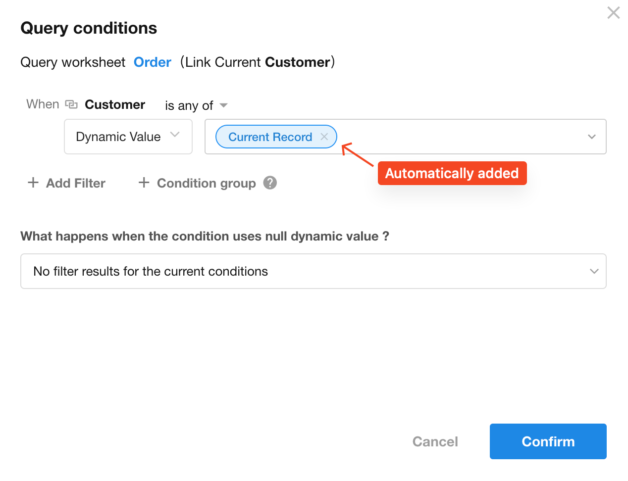

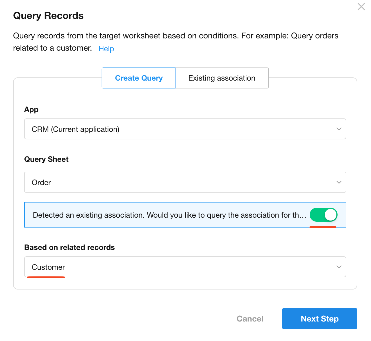

Note: Since the Order worksheet is already related to the Customer worksheet, the system will prompt whether to use the existing relationship to configure query conditions when selecting the Order worksheet.
After selecting the worksheet relationship and clicking Next, the system will automatically create a query condition involving the relationship field. Users can further refine conditions as needed.

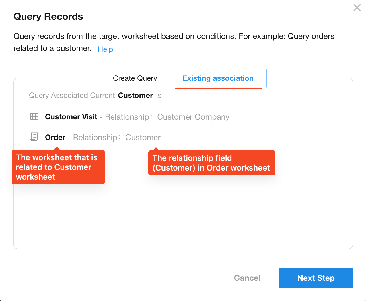

Use an existing worksheet relationship to quickly create query conditions. Select the worksheet relationship of the current worksheet, then click Next.
The system will automatically add a query condition (e.g., "The related Customer is any of the current record"). Additional conditions can be added as required.

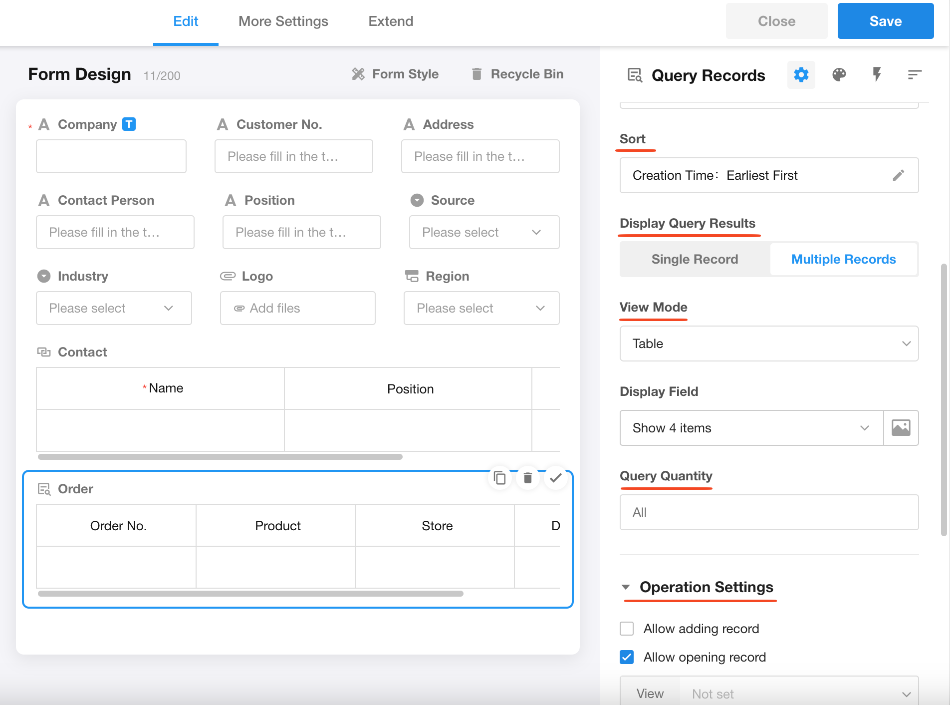

After configuring the query conditions, you can set more features for better performance.
Sort
The queried records will be displayed according to the sorting rules configured here.

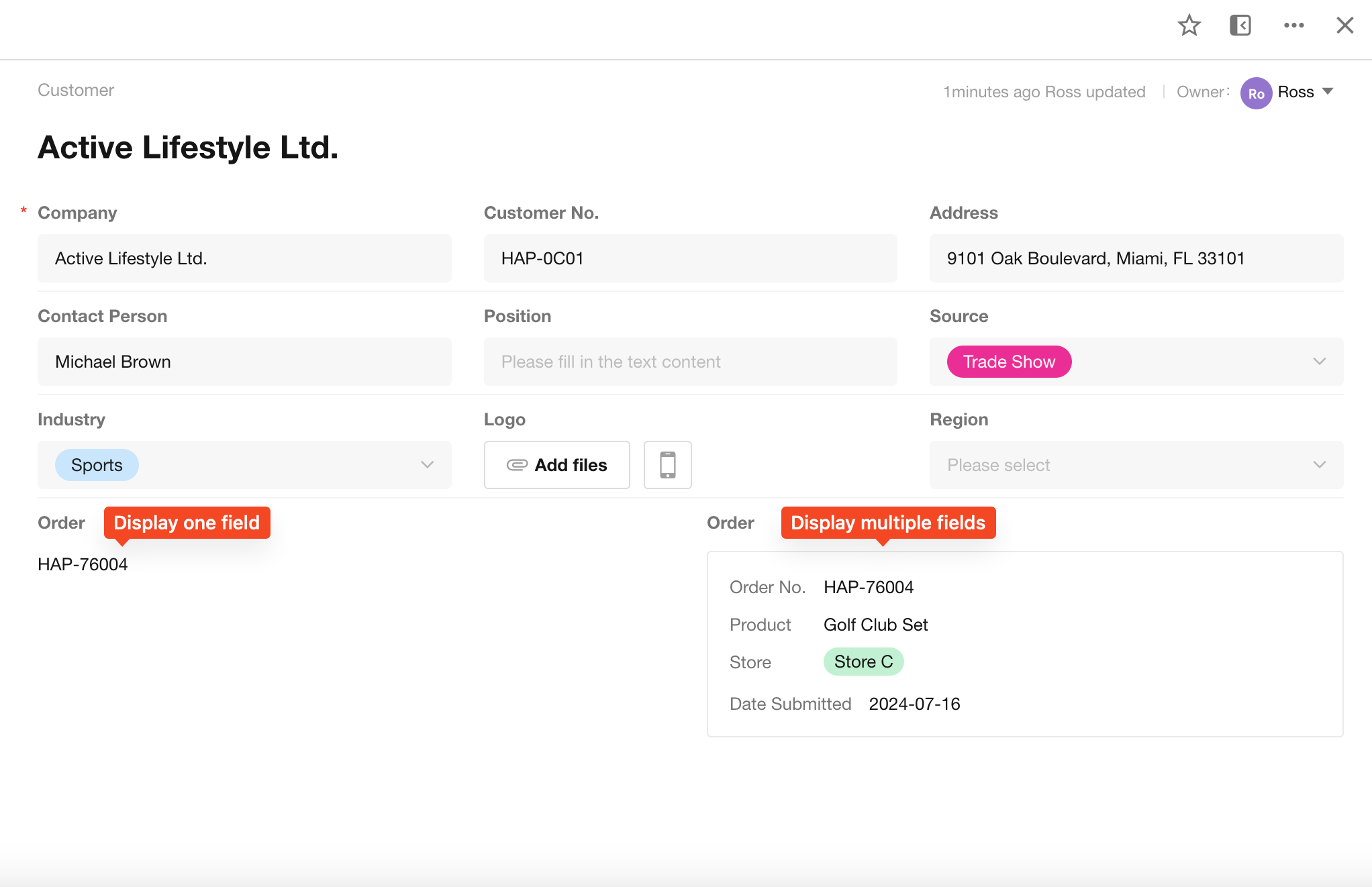

Display single record
If "Single record" is selected, the first record from the queried results (based on the sorting rules) will be shown. You can specify which fields to display, and all fields will be presented in card.
Display multiple records
Number of records to query
You can set the number of records to be queried. For example, if you only want to query and display one record or consistently show the top 5 records.
If this setting is not configured, all matching records will be queried.

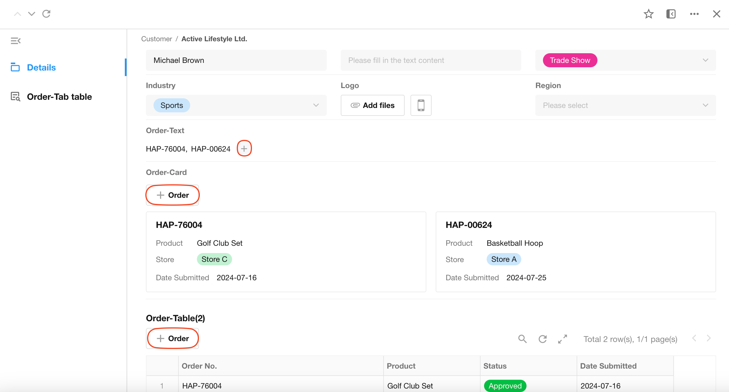

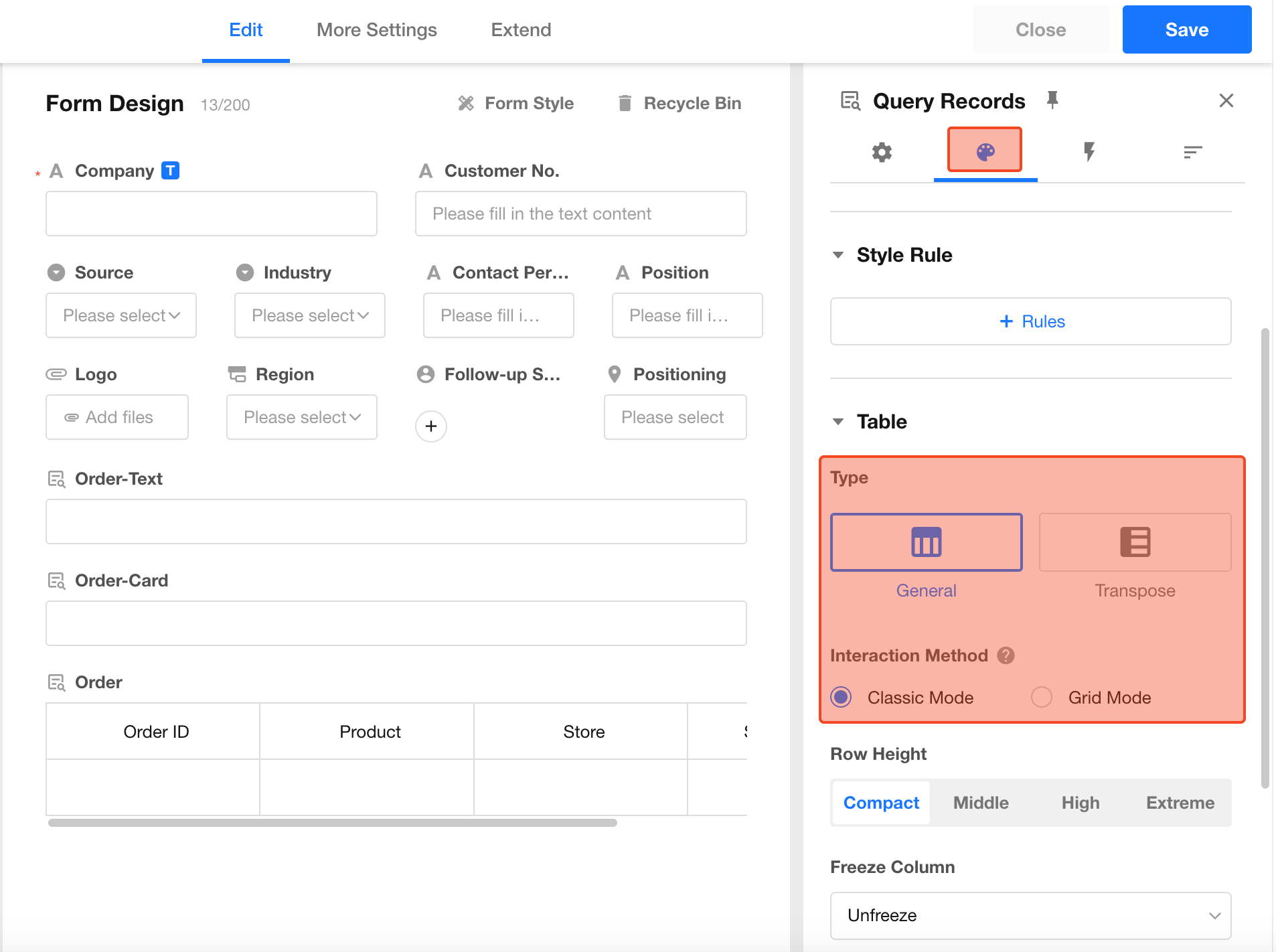

Display mode

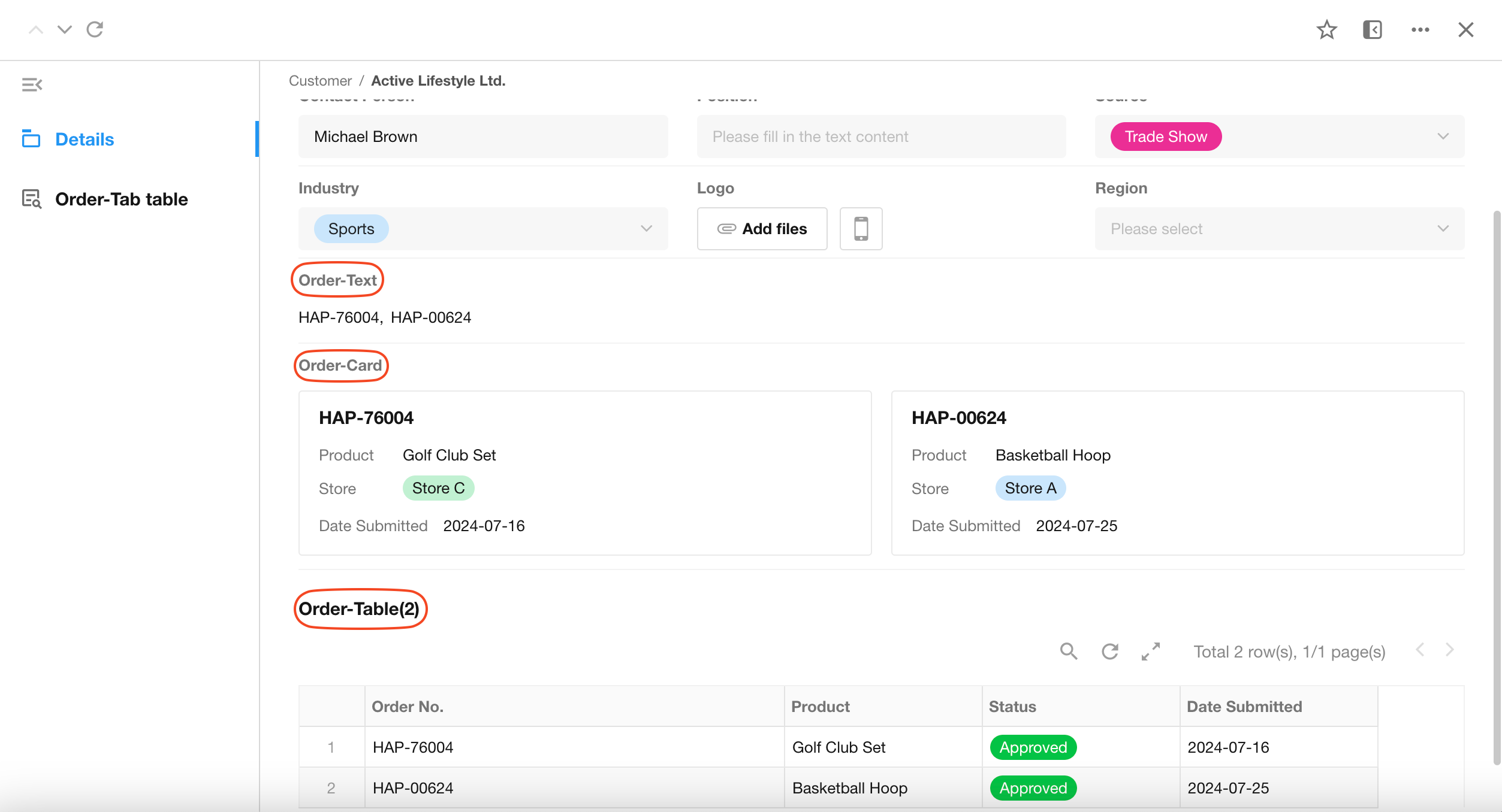

There are four primary ways to display the queried records in the current record:
Text (Default mode, displays up to 50 records)
Card
Table (Can be placed anywhere on the page or within tabs)

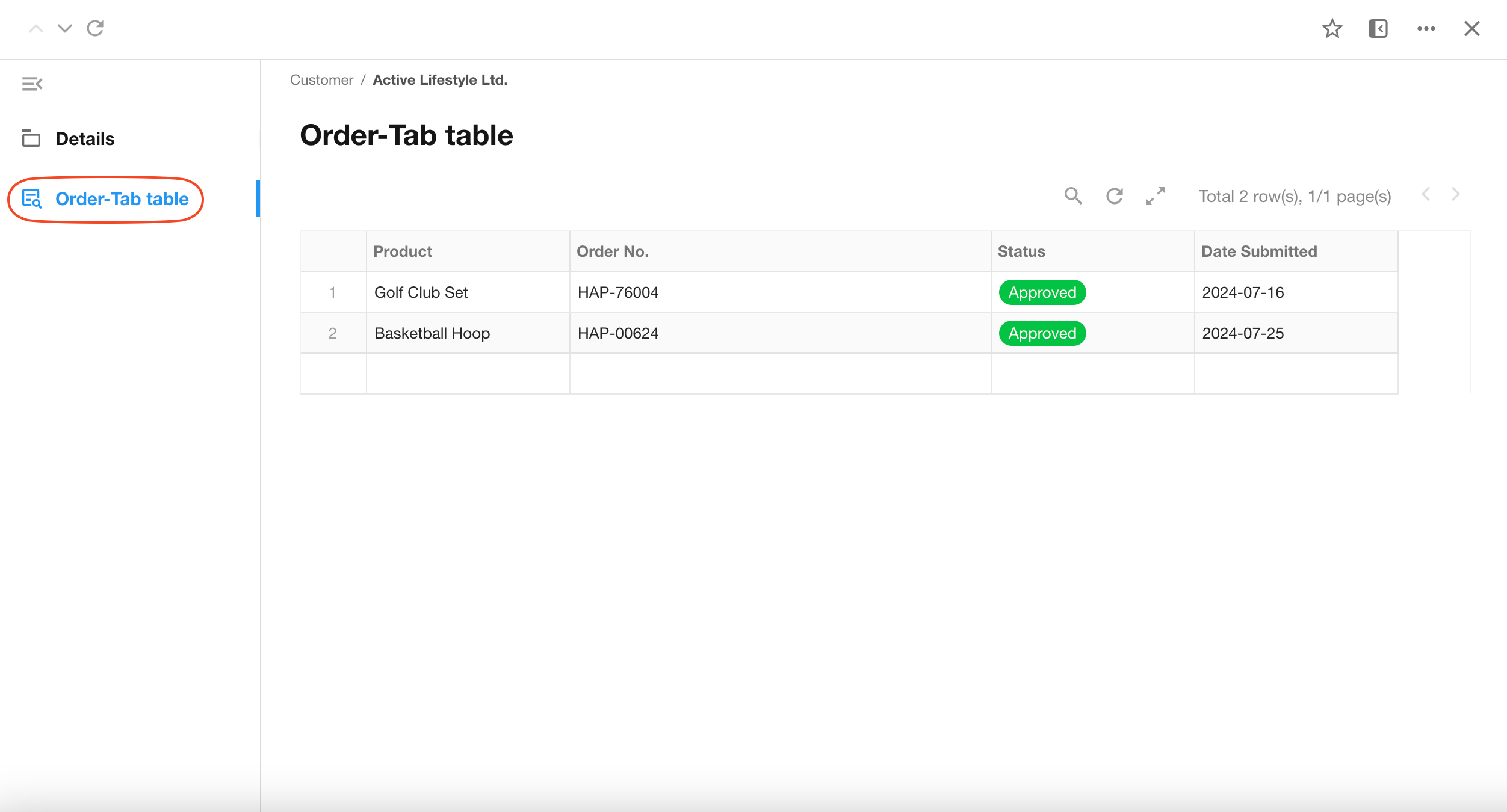

Tab table (Displayed at the bottom of the page, aligned with tab fields)
To demonstrate these four display modes, we created four query record fields for comparison:
Allow adding record
If enabled, an "Create Record" button will be displayed, allowing users to directly create records.
Allow opening record
If enabled, clicking a record will open its details. You can select a specific view to display the record based on the view's configuration.

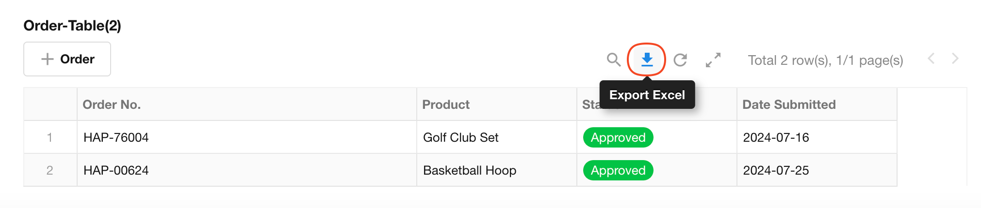

Allow export
If enabled, users can export the visible queried records to Excel (up to 10,000 records maximum).

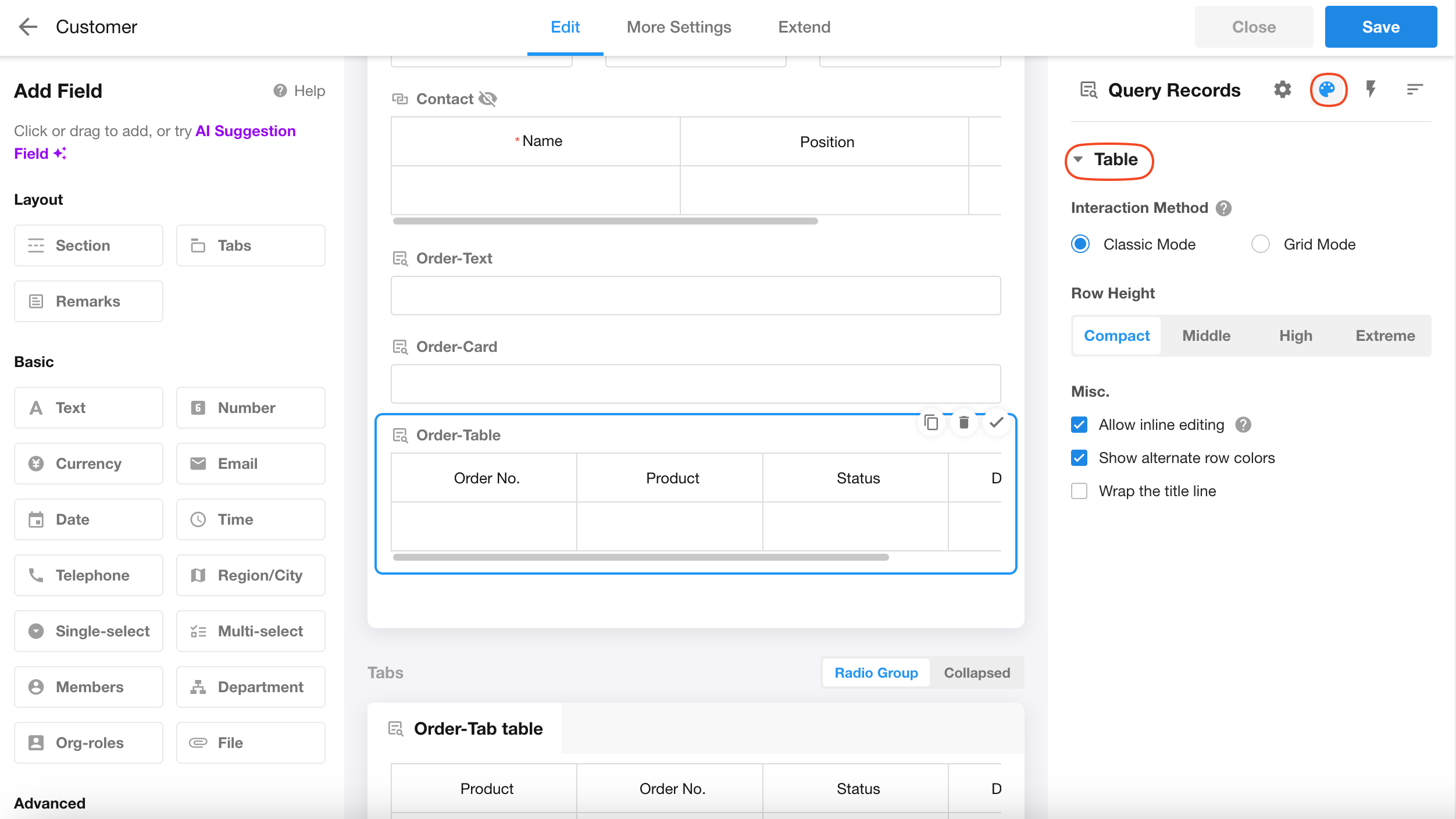

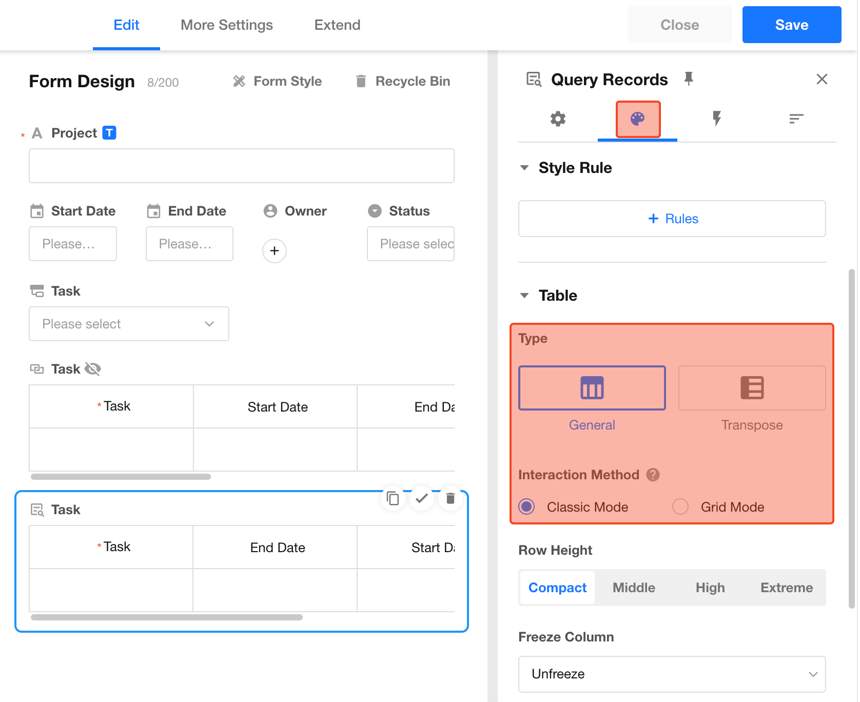

Table settings
Table settings are only available for the Table and Tab table display modes.

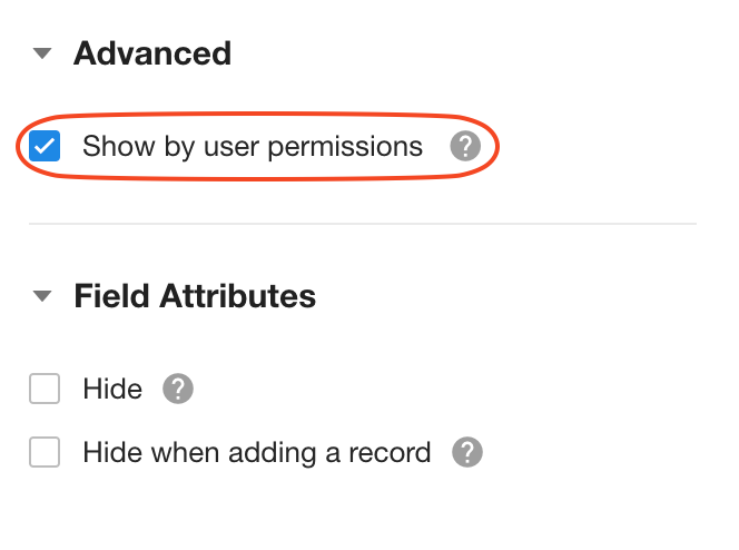

Show by user permissions
If disabled, all records matching the query conditions will be displayed. If enabled, only records that the current user has permission to view (as configured in the Order worksheet's permission settings) will appear in the query results.
