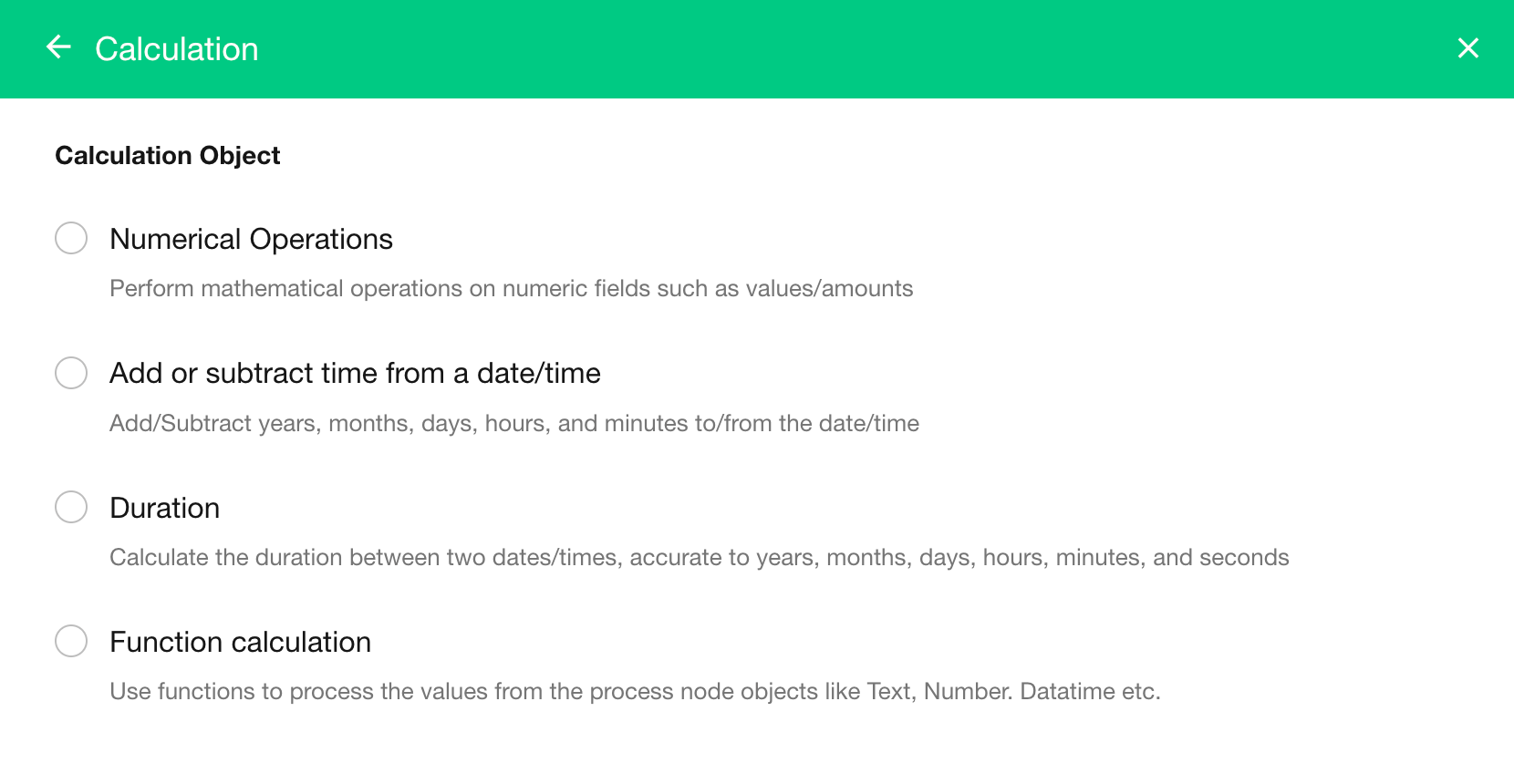

Supported Calculation Types
  • Arithmetic operations between number or currency fields
  • Duration calculation between two date fields
  • Date adjustment: add or subtract time from a date to compute a new date
  • Data processing using functions

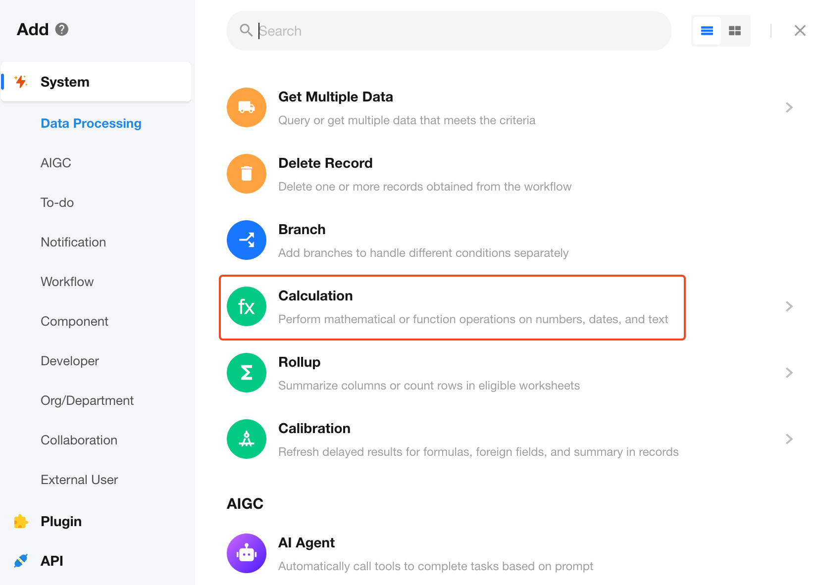

Configure the Calculation Node
1. Add a Calculation Node and Choose Numeric Operation

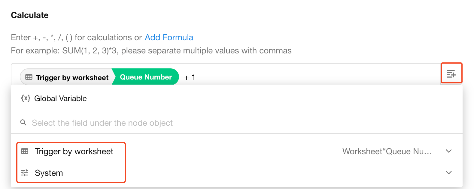

2. Select Fields for the Calculation
You can select numeric or currency fields from previous nodes in the workflow.
You can also calculate using constants directly.

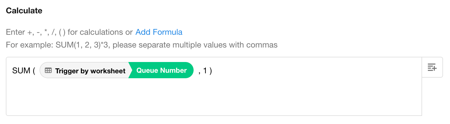

3. Define the Formula

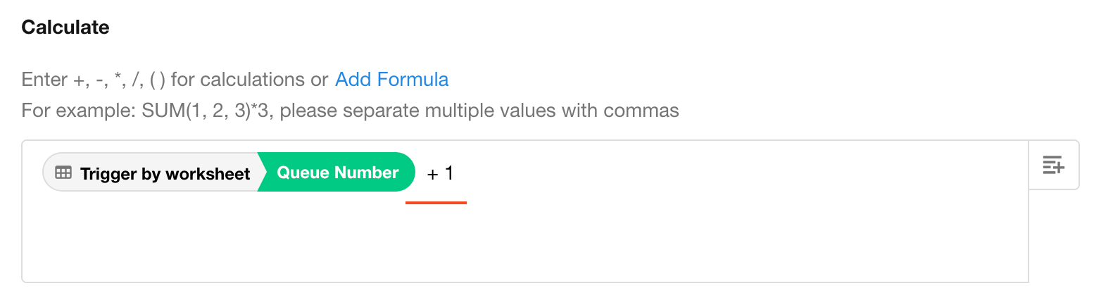

You can either manually enter a formula using operators (+, -, *, /, ()),
or use a built-in system formula. In this example, both methods work to calculate the next queue number.
  • Custom Formula

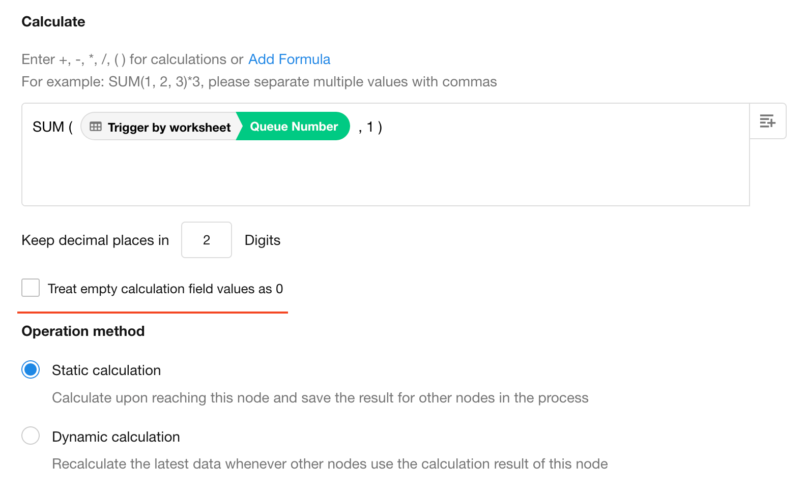

  • System Formula
Tips:
  • Decimal results are rounded to 2 decimal places by default.
  • When using system formulas, separate fields inside parentheses with commas (,); When writing custom formulas, make sure to include valid operators.
  • If any field involved in the calculation is deleted, the result will be empty.
4. Treat Empty Fields as Zero
When using a custom formula like Field 1 + Field 2 + Field 3, the result will be empty if any field is empty.
Enable the "Treat empty fields as 0" option to ensure calculations still return valid results.

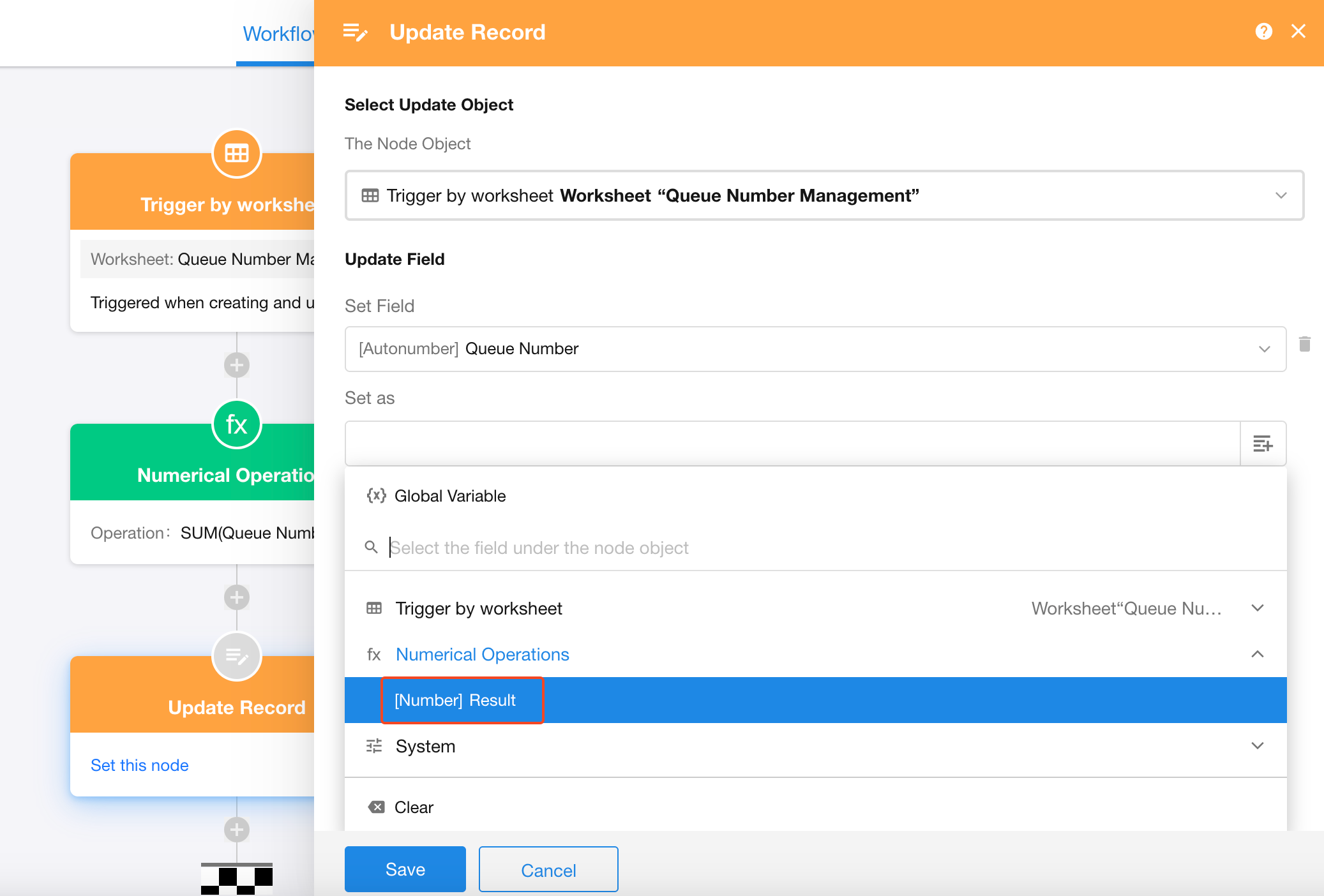

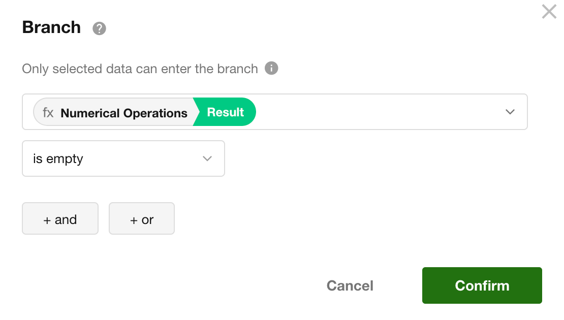

5. Use the Calculation Result in Downstream Nodes
Subsequent nodes can directly reference the result from this calculation node.
If the result may be empty, consider using a conditional branch to handle different outcomes.

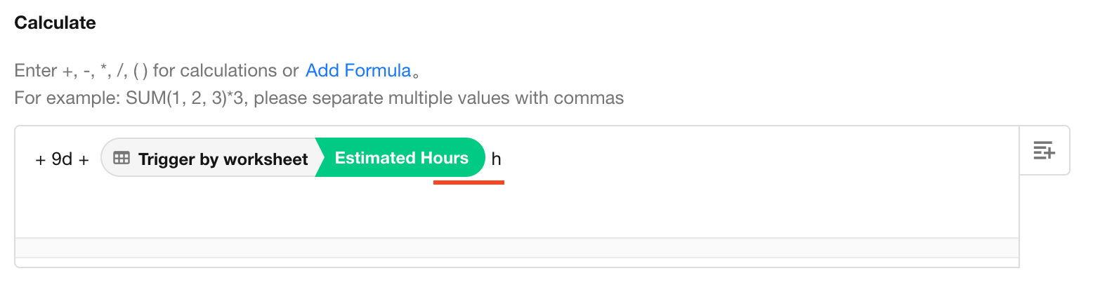

  • Each number must be preceded by an operator and followed by a unit.
    For example: +8h+1m is valid.
  • If you're referencing a numeric field from another node, just append the unit directly — no operator or symbol in between.

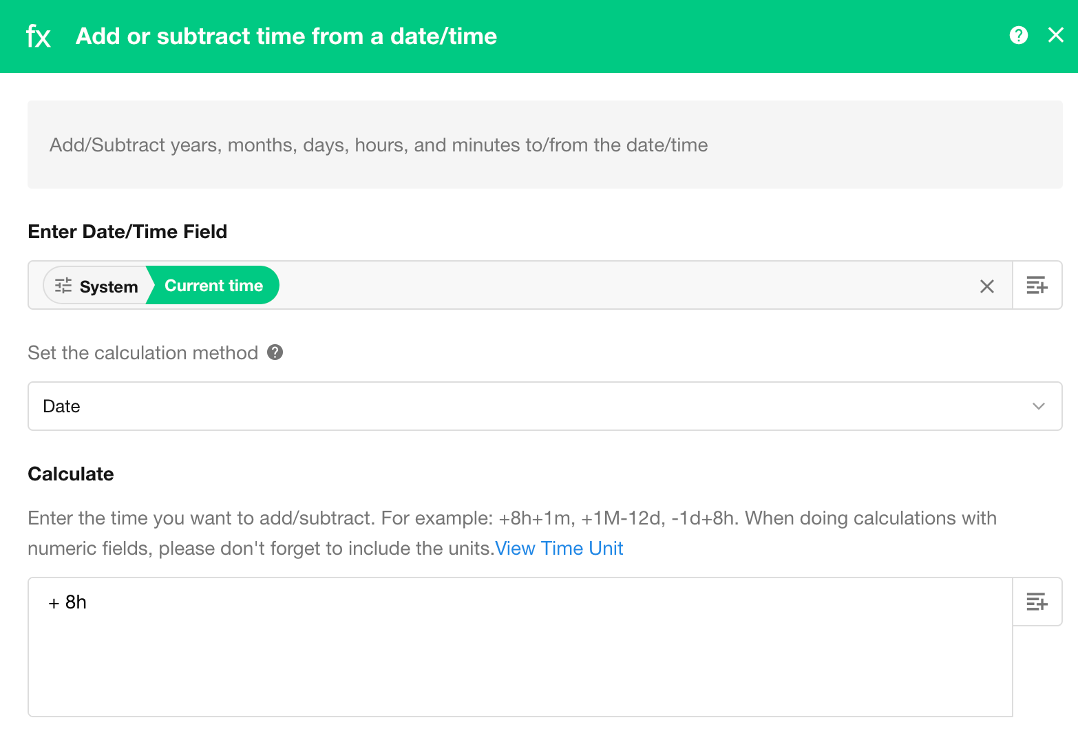

Example 3: Get 8:00 AM of the Current Day
If the system time when the calculation node executes is 2020-12-21 14:37:
  • Format: Date → base becomes 2020-12-21 00:00
  • Formula: +8h
  • Result: 2020-12-21 08:00

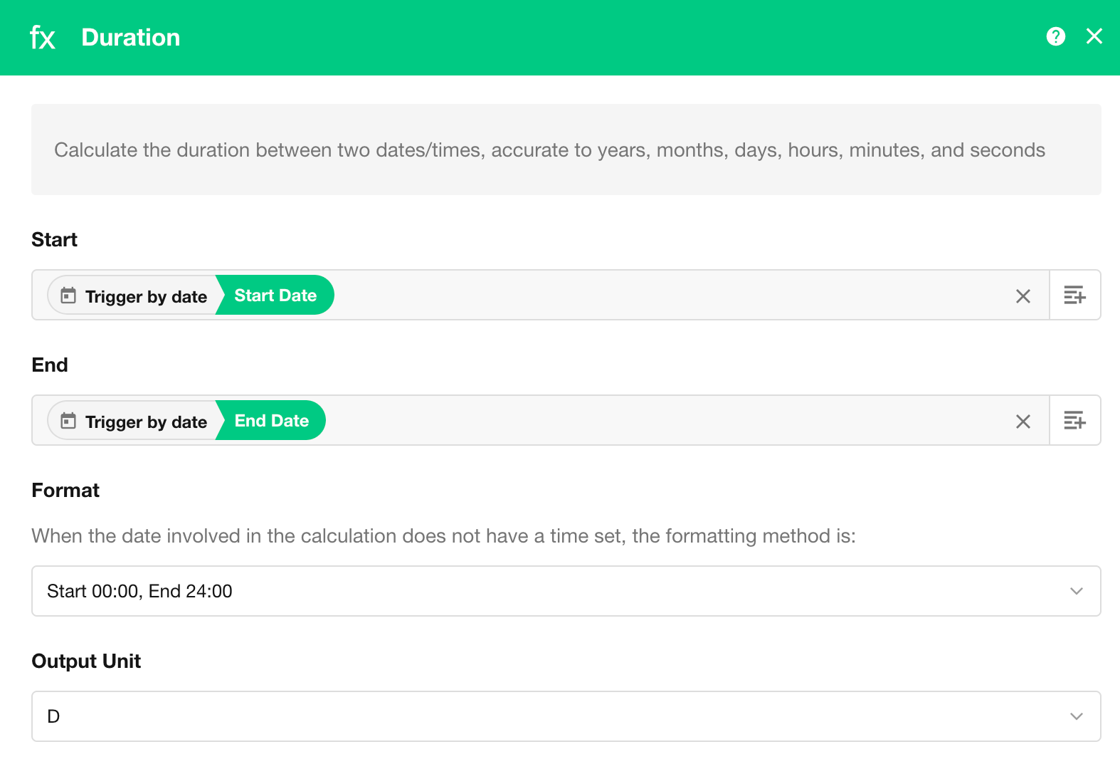

3. Calculate Duration Between Two Dates
This function works similarly to using a formula control in a worksheet to calculate the duration between two dates. You specify the start date and end date fields, then define the format to be used in the duration calculation.
  • Format 1: Start at 00:00, End at 24:00
  • Format 2: Start at 00:00, End at 00:00
If the selected fields are date-only (without time), a default time will be appended as per the format selected. If the fields already contain timestamps, the calculation uses the actual datetime values.

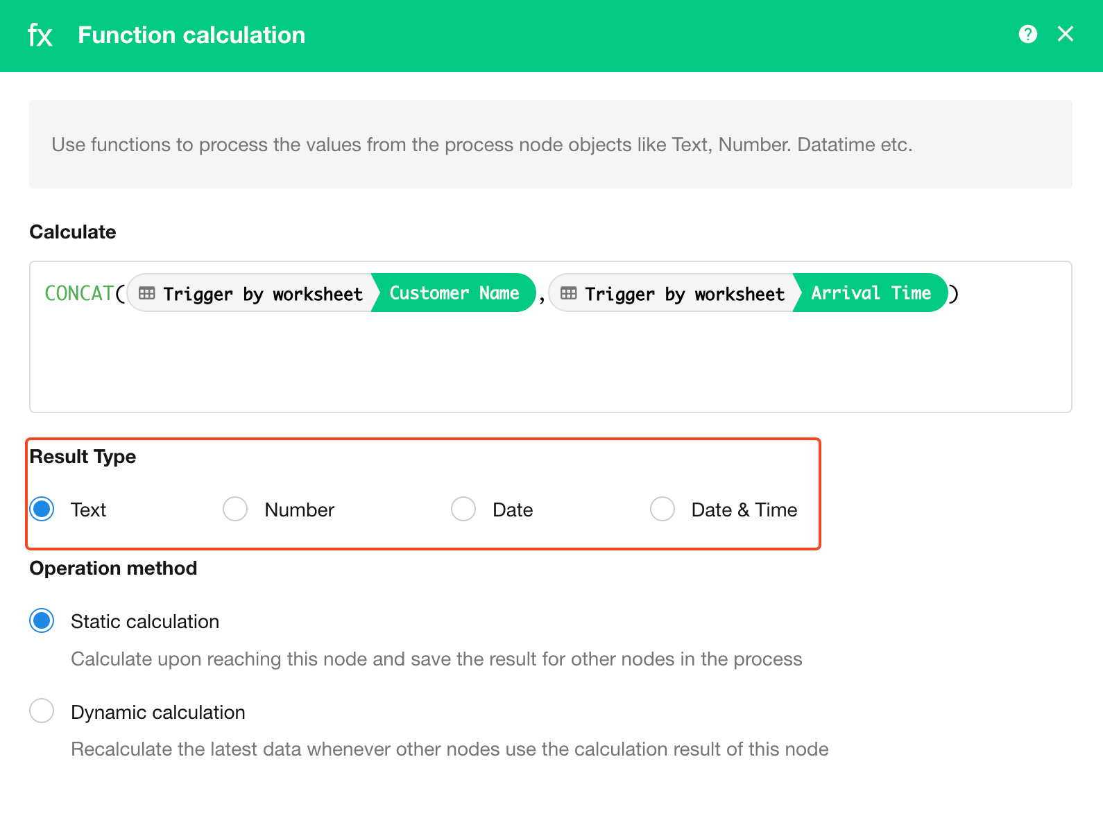

4. Function Calculation
Using functions, you can process the values of node objects such as text, numbers, or dates and return results in the desired format. Common examples include:
  • Using the YEAR() function to extract the year from a date.
  • Using the REPLACE() function to remove the +86 prefix from a phone number.
  • Using the DISTANCE() function to calculate the distance between two location fields.
1. Add a calculation node and select the "Function" option
2. Define the function formula
For a full list of supported functions, see Learn more about functions
3. Select the output data type for the calculation result

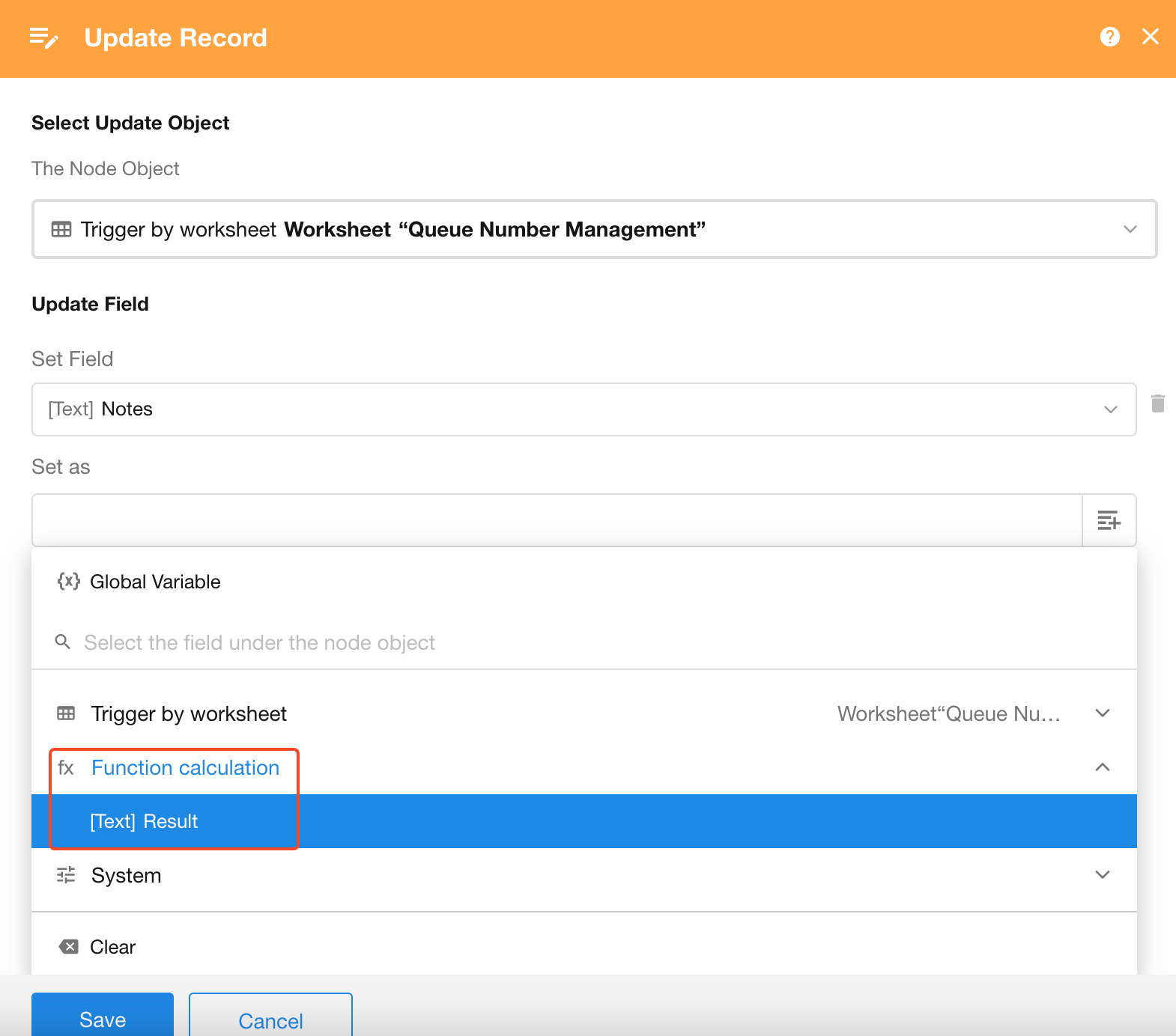

4. Use the result in subsequent workflow nodes
