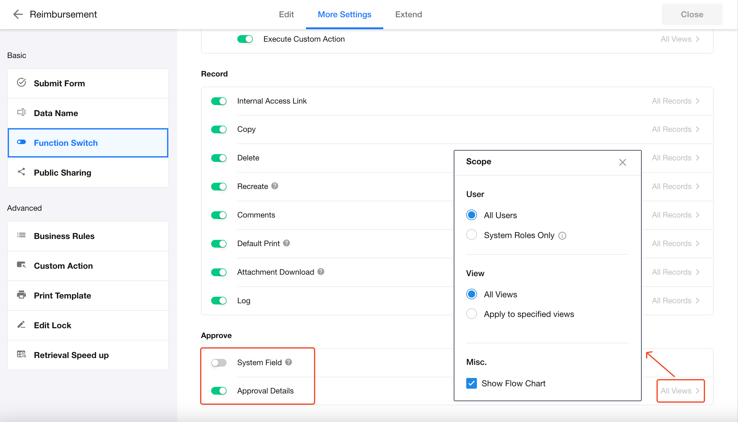

II. How to view and process the approval in worksheet​

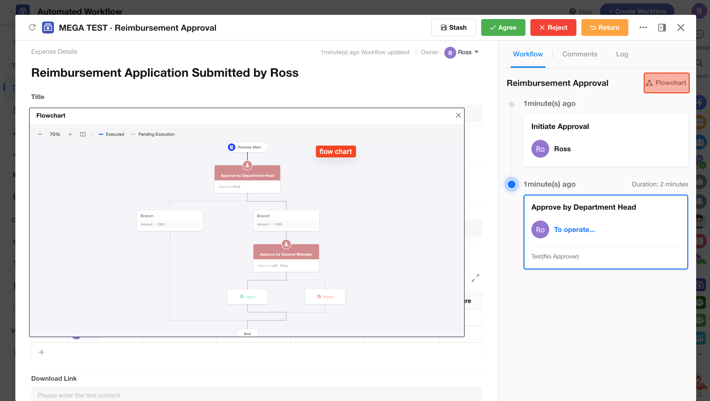

The status of the current approval, the approver, and the flowchart can be displayed directly in the view. You can check the flow status, or process the approval when you view the record. As shown below:
1) Enable Approval System Fields and Flow Chart in the Worksheet​
Go to the "Function Switch" page of the worksheet and enable both the approval system fields and the approval details.
The approval system fields include:
  • Workflow Name
  • Status
  • Approval Completion Time
  • Node Owner
  • Node Start Time
  • Node Remaining Time
  • Initiator
  • Initiation Time
If "Show Flow Chart" is unchecked, the entry point for the flow chart will not be displayed in the approval card within the worksheet.
