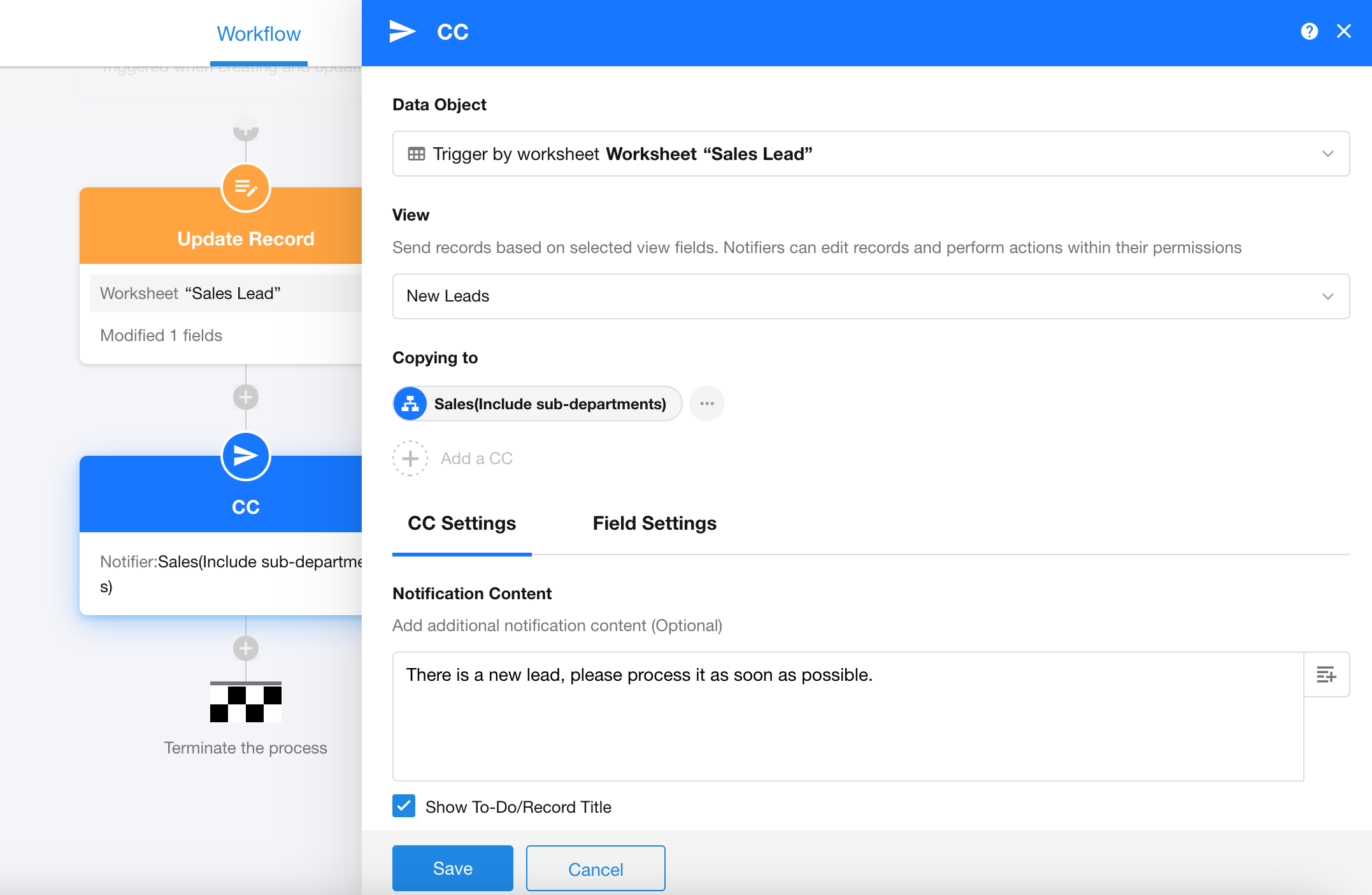

Use Case: When a new lead is added to the worksheet, a notification is instantly sent to the sales assistant for immediate follow-up. Upon receiving the message, the sales assistant can not only view the notification details but also conveniently click on the link to quickly access comprehensive information about the lead. Furthermore, they can effortlessly assign the lead to the appropriate representative with a single click on the customized button, streamlining the entire process.
  1. Select the data object
    Select the record to be sent. In the above example is the added lead record, which triggered the workflow.
  2. Select the view
    Since the fields and custom buttons are already configured in the view, you can select a view directly. When viewing a record, records are presented based on the view and the user’s permissions.
    a. When the CC recipients have permission to access the view
    If the CC recipients have permissions to direct access to the view through the worksheet, opening a record via the CC message will have the same effect as opening the record directly in the view (subject to the users' roles and permissions). The recipients can edit fields and click custom buttons.
    Even if the attached record is not included in the selected view, it will still be treated as a record within the view.
    b. When the CC recipients do not have permission to access the view
    If the CC recipients do not have direct access to the view through the worksheet, opening a record via the link will result in all fields being read-only. The visibility of fields will be determined by the configuration in the view, and custom buttons will not be displayed.
  3. Select the CC recipients
    You can choose users from Contacts or select them based on their organizational roles.
    Notifications can be sent to a single recipient or a group of people. For instance, if you select a department field, all members within that department will receive the notification.
    When a message is CC'd to multiple recipients, the notification will appear in each person's [To-do]. To clear the pending task count, each recipient must individually click and view the message.

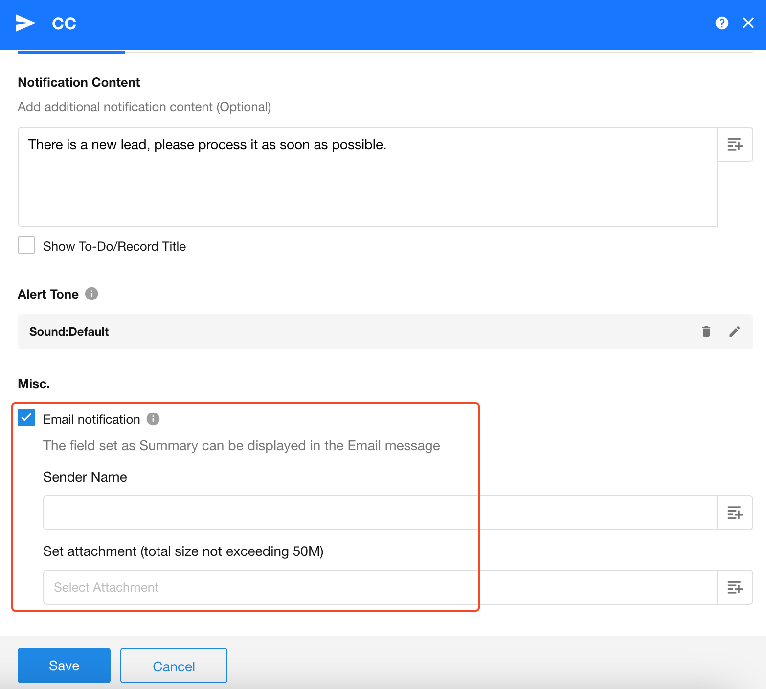

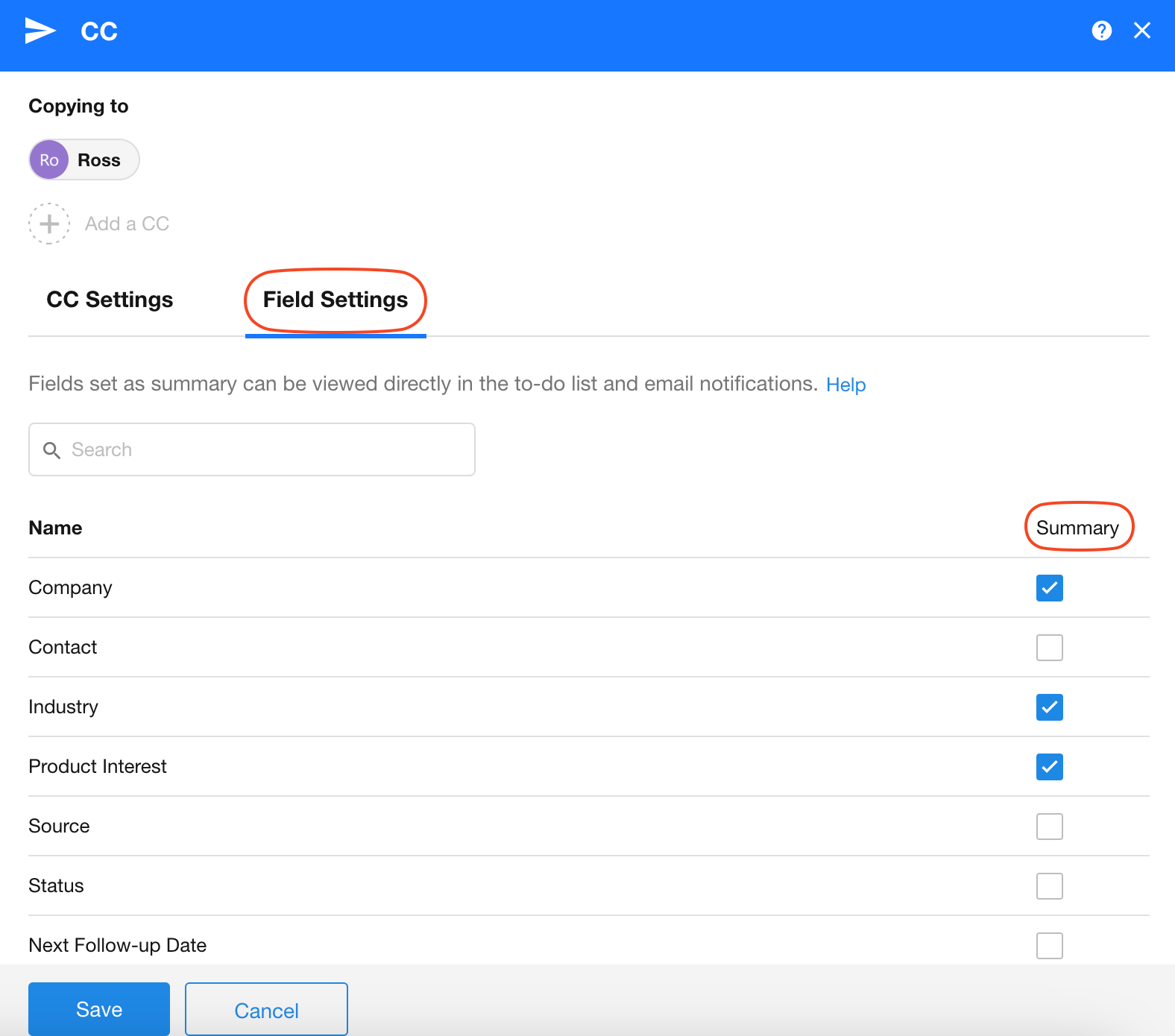

  4. Edit the notification
    Notifications can contain fixed text, with the same content sent each time. You can also create dynamic notifications by incorporating fields from the node.
    If the [Show record title] option is not checked, a "View details" link will be shown at the end of the notification.
    The "CC" label at the beginning of the notification message displays the name of the CC node. If the node name is modified, it will be updated here accordingly.

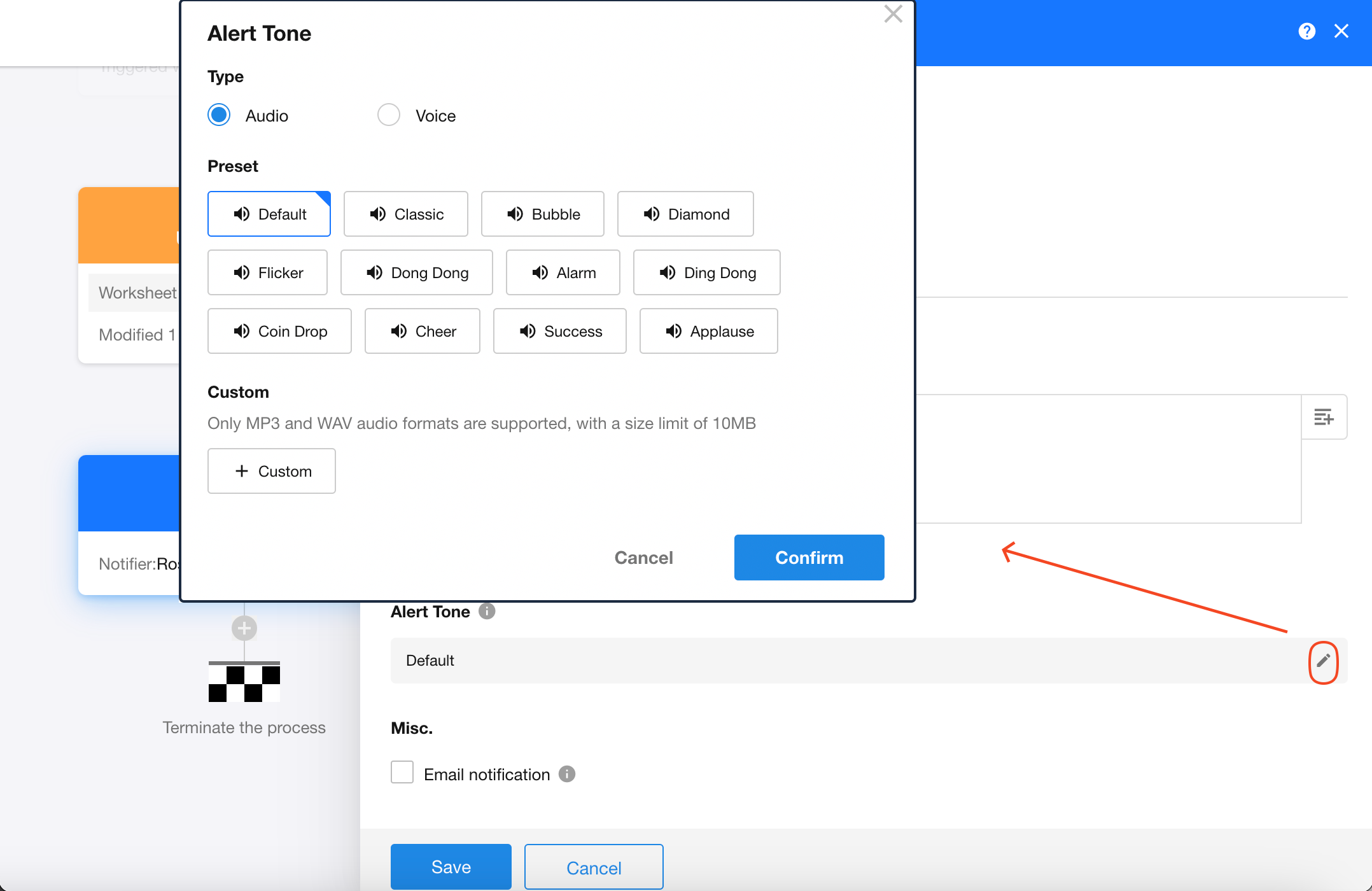

CC messages will appear both in the chat and in your [To-do]. The to-do count will only decreaseafter you view the record details.
To process these messages, you can either:
  1. Click on the record details in the message notification.
  2. In the [To-do], click "Read" or "Check All" to quickly acknowledge the CC notifications. Or, click on the card to check the detailed record.
