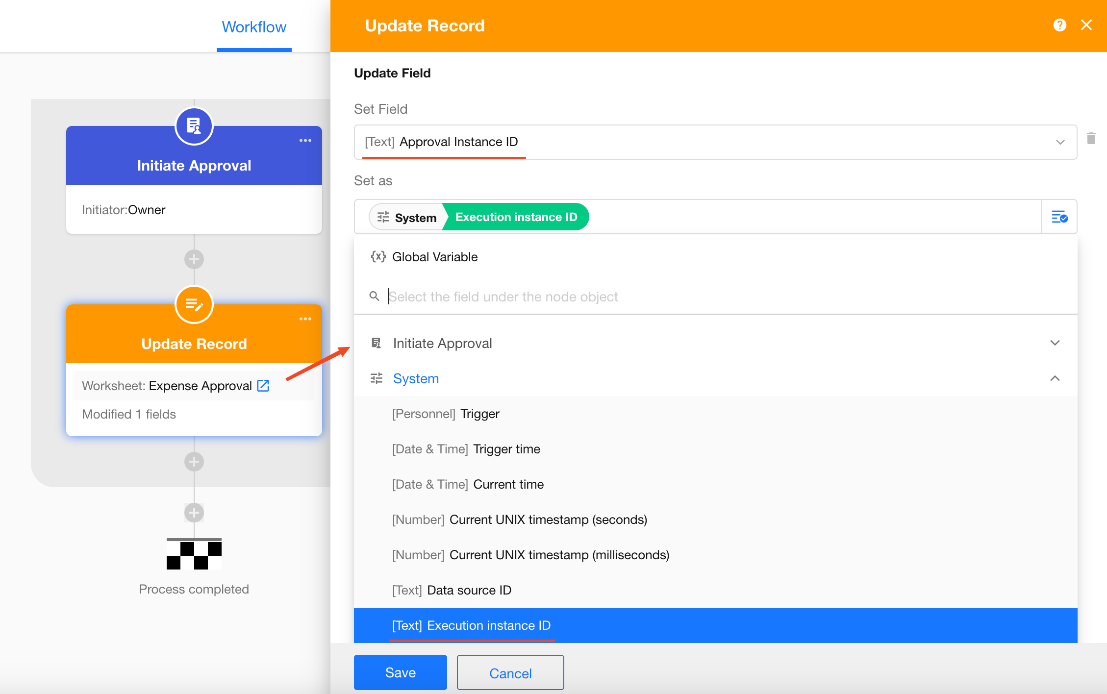

2. Get the instanceId​
The instanceId (workflow execution instance ID) is the unique identifier for each workflow run.

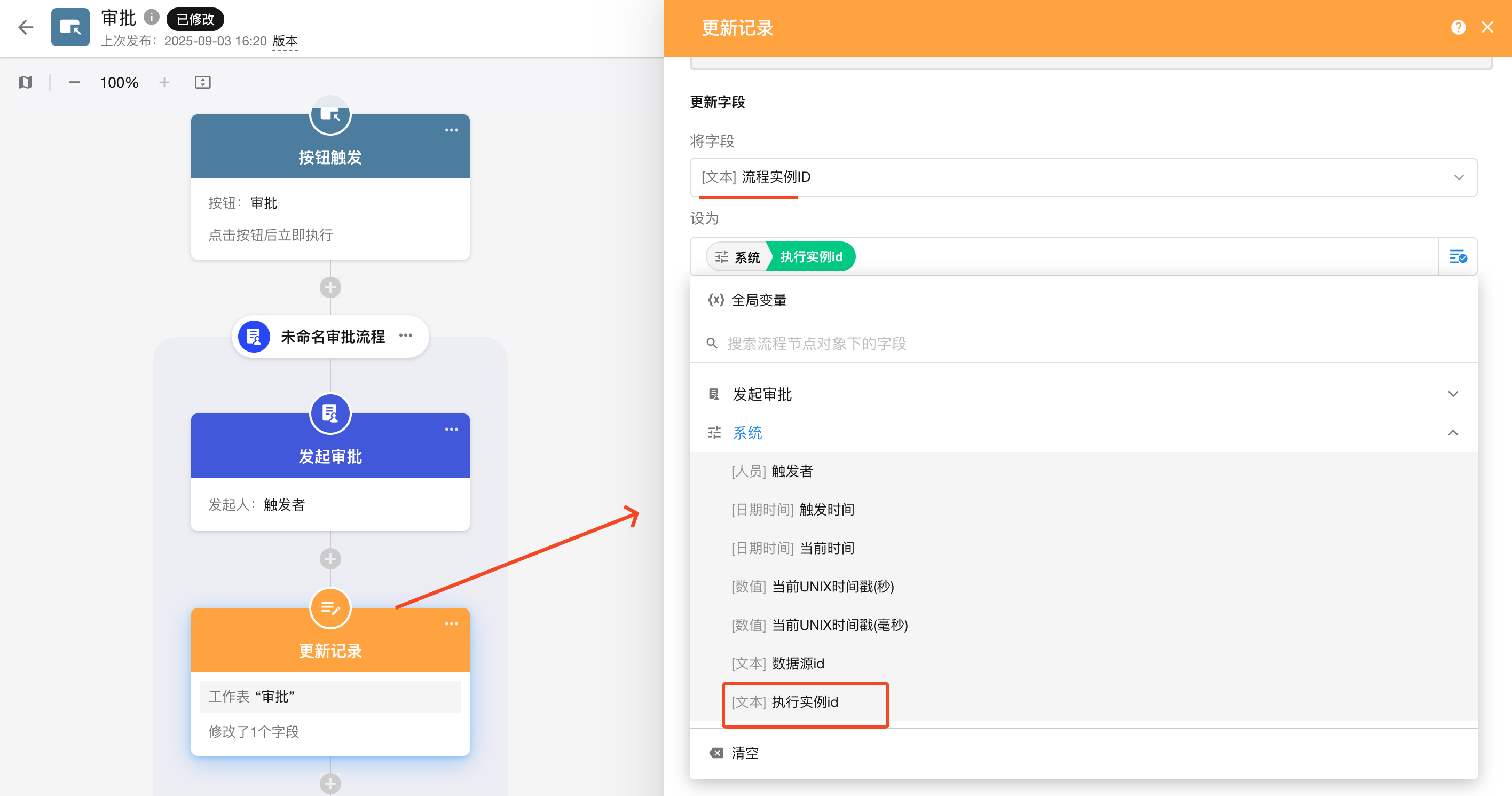

It is recommended to add an Update Record node immediately after the Initiate Approval Flow node, and write the current instanceId into a field in the record (e.g., “c”). This allows the value to be used later when calling the workflow termination API.
Configuration example:

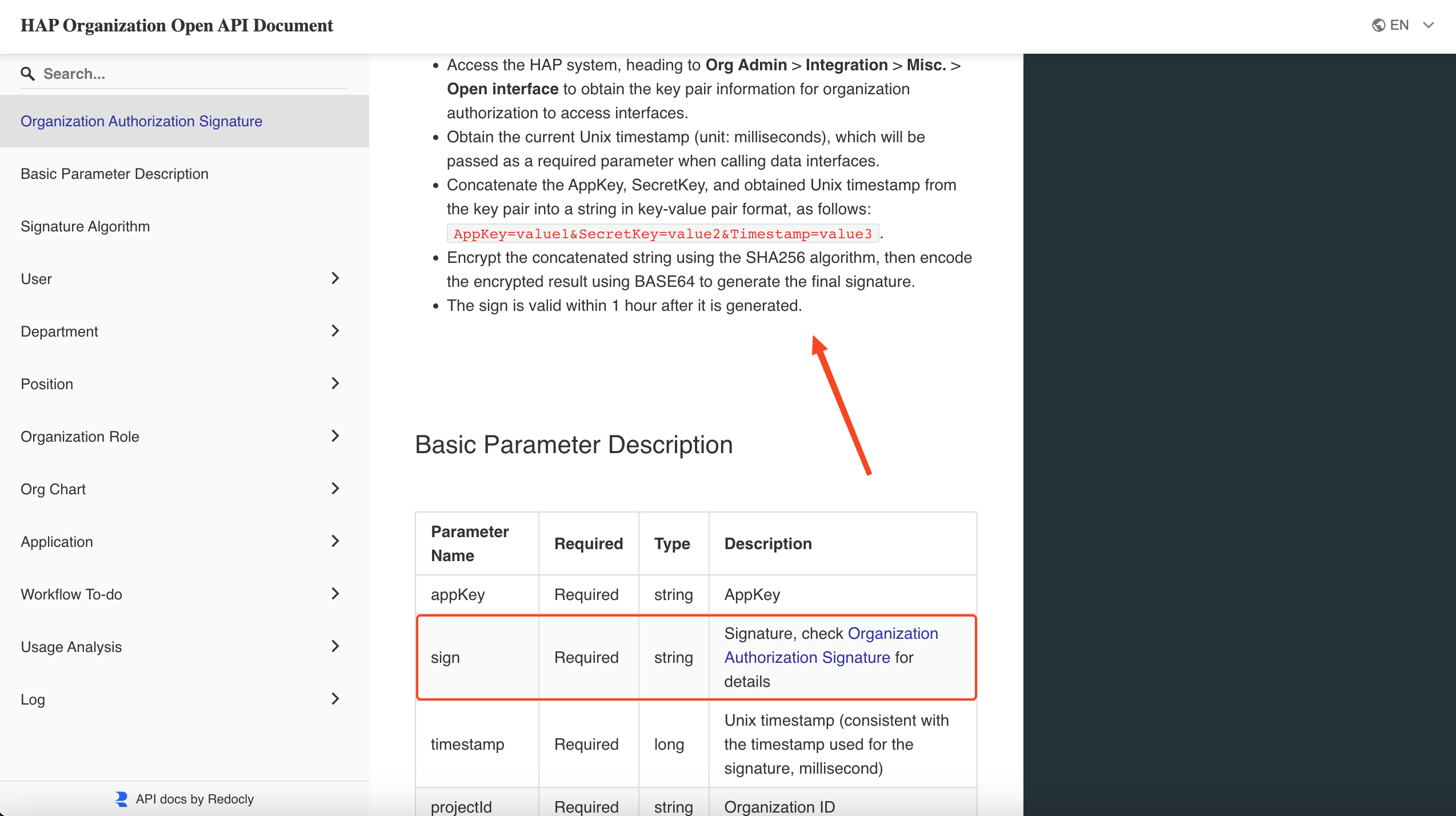

How to Generate sign​

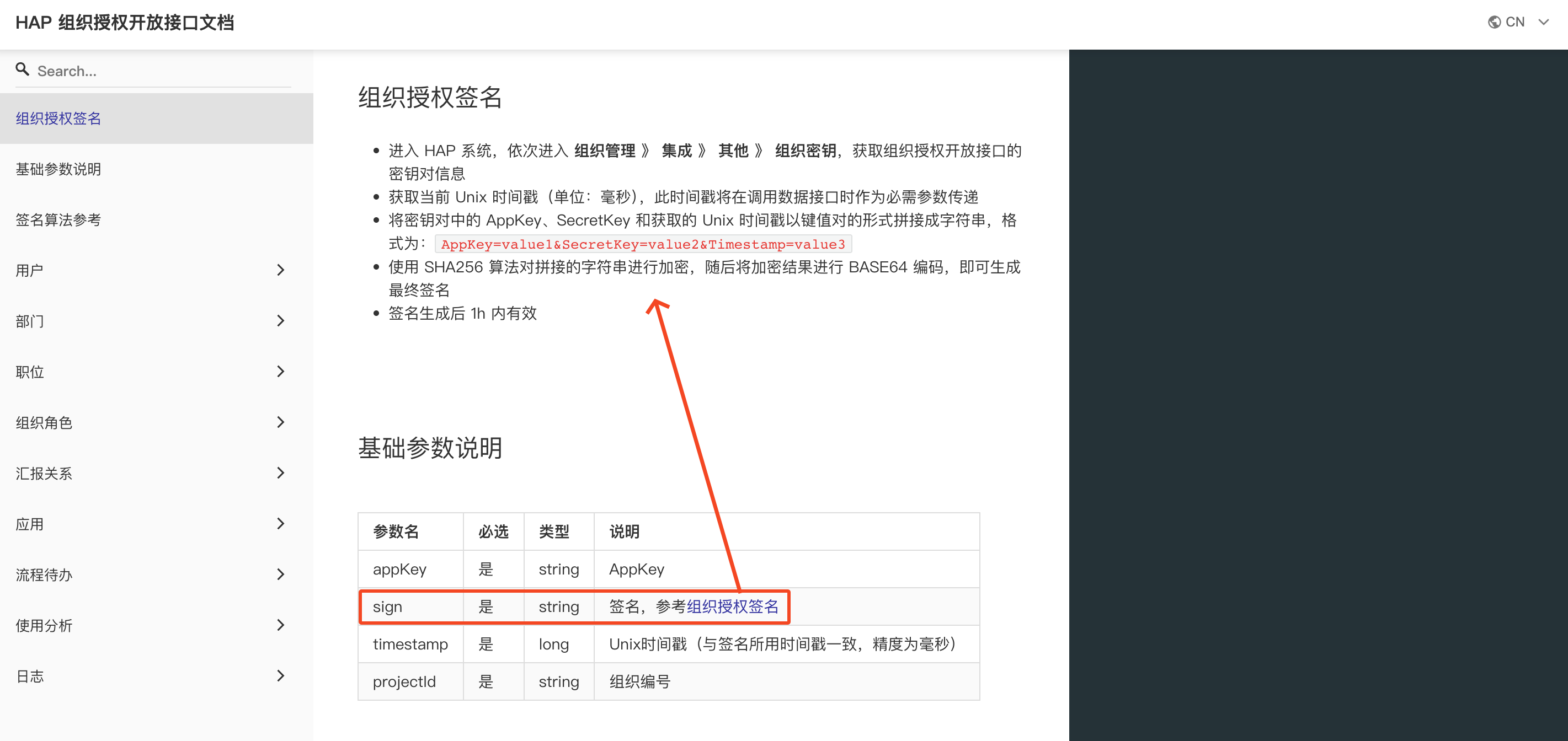

The API documentation explains how to generate the organization-level sign in the introduction section.
To generate sign, you need:
  • AppKey
  • SecretKey
  • timestamp

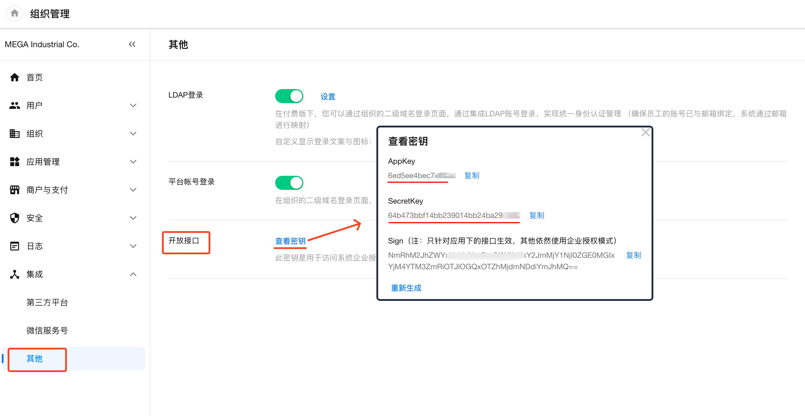

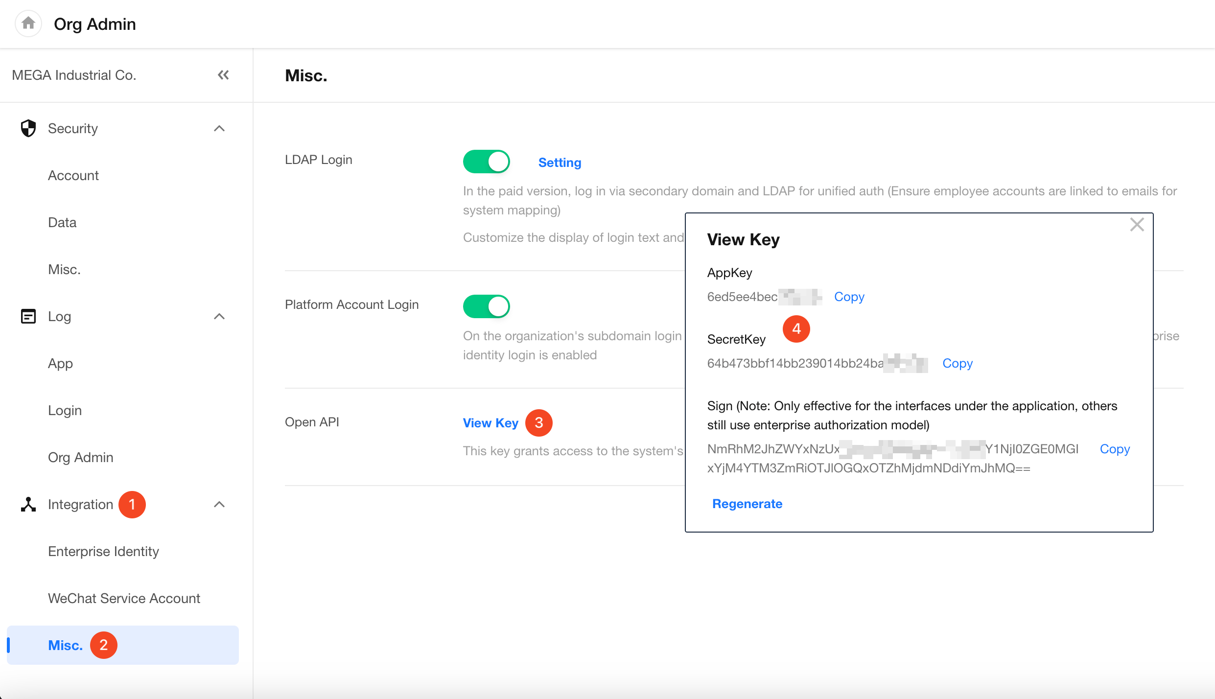

Get the AppKey and SecretKey​
Organization administrators can go to the Organization Admin Console, then navigate to [Integration] > [Misc.] to view the organization’s key information, including AppKey and SecretKey.
Record the retrieved values:

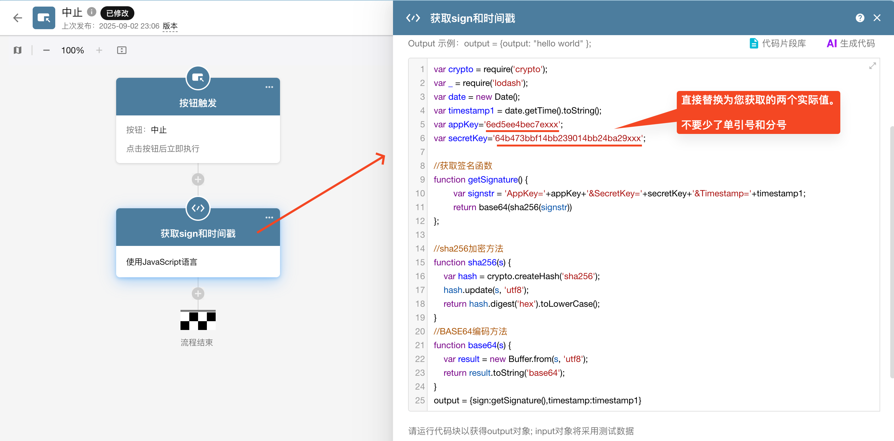

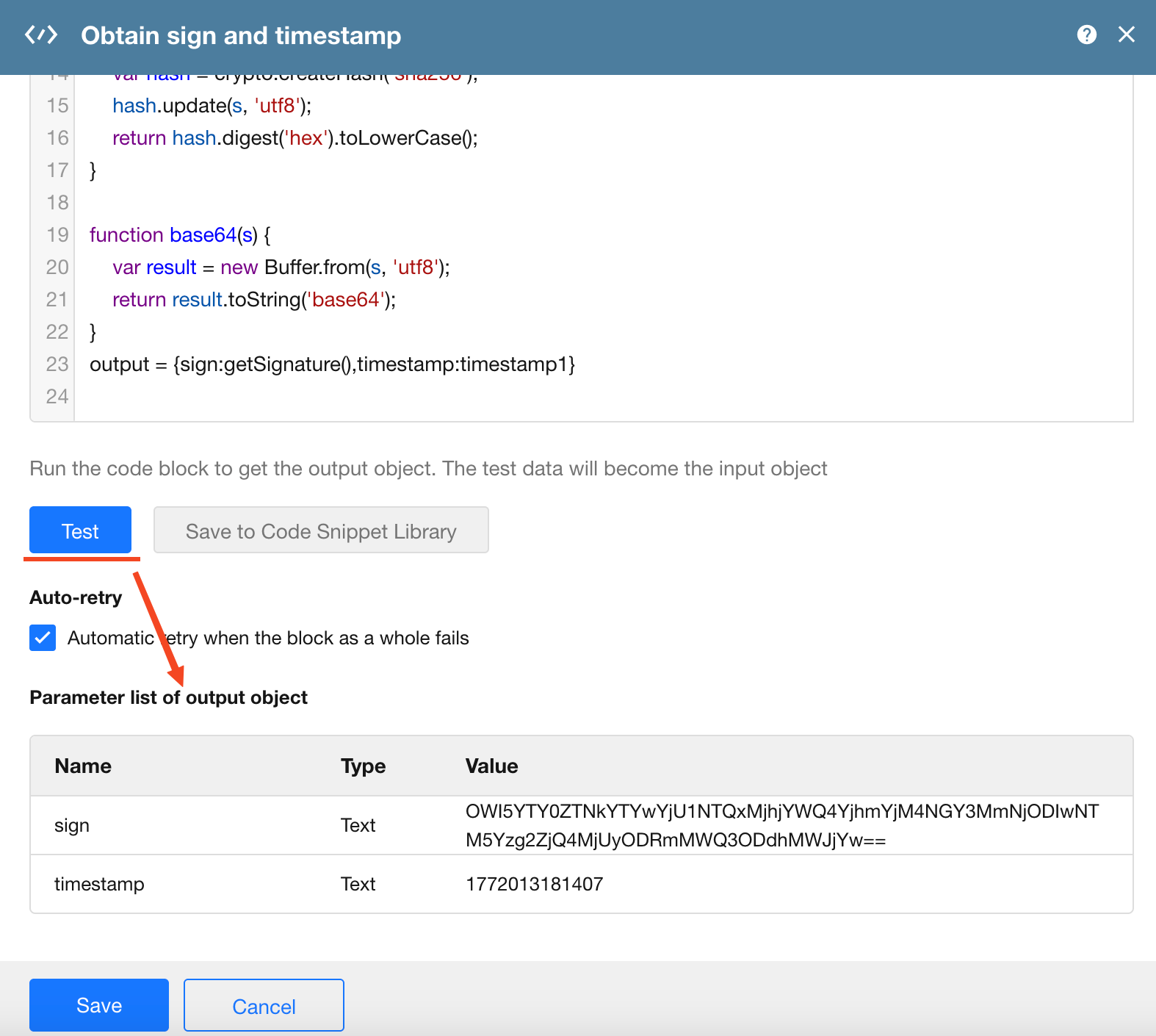

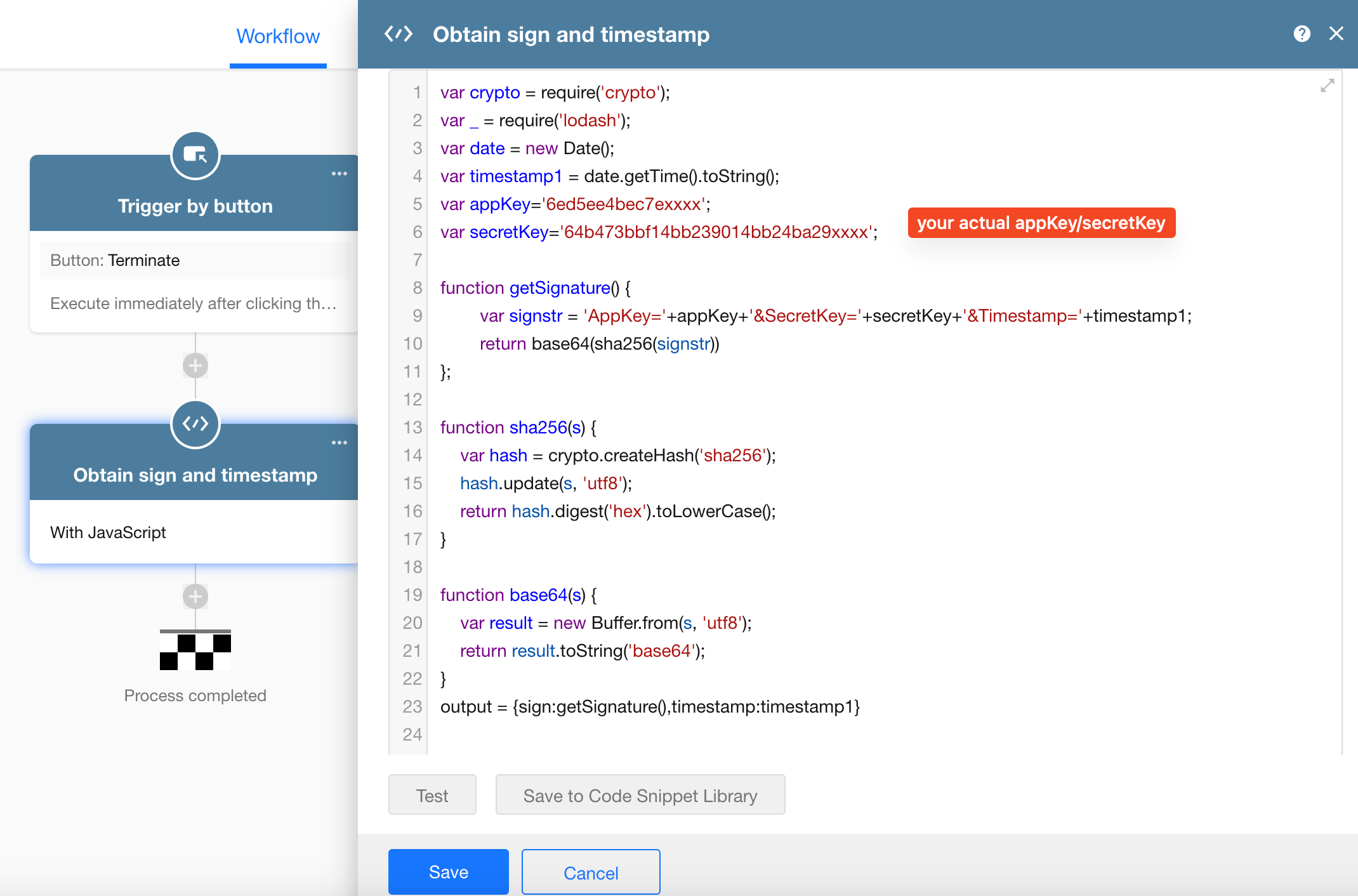

Use a Code Block Node to Generate sign and timestamp​
Add a “Terminate” button and configure the associated workflow.
After the workflow starts, add a Code Block node to generate sign and timestamp based on the existing parameters.
Copy and paste the following code into the Code Block node, and replace AppKey and SecretKey with your actual values.
var crypto = require('crypto');
var _ = require('lodash');
var date = new Date();
var timestamp1 = date.getTime().toString();
var appKey='6ed5ee4bec7exxxx';// your actual appKey
var secretKey='64b473bbf14bb239014bb24ba2xxxx'; //your actual secretKey
function getSignature() {
        var signstr = 'AppKey='+appKey+'&SecretKey='+secretKey+'&Timestamp='+timestamp1;
        return base64(sha256(signstr))
function sha256(s) {
    var hash = crypto.createHash('sha256');
    hash.update(s, 'utf8');
    return hash.digest('hex').toLowerCase();
function base64(s) {
    var result = new Buffer.from(s, 'utf8');
    return result.toString('base64');
output = {sign:getSignature(),timestamp:timestamp1}
Click the Test button in the Code Block node to output the generated sign and timestamp, then save the node configuration.

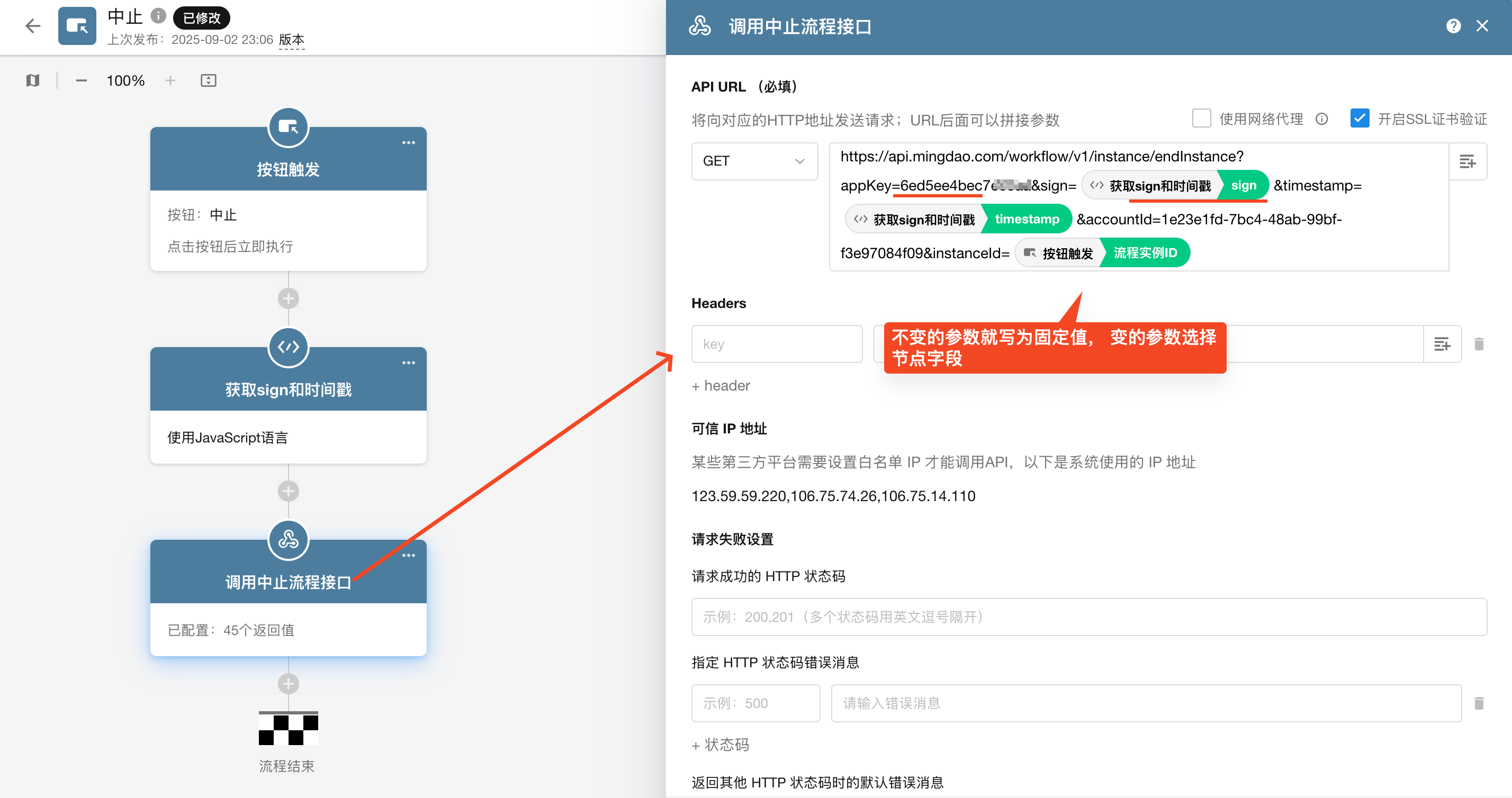

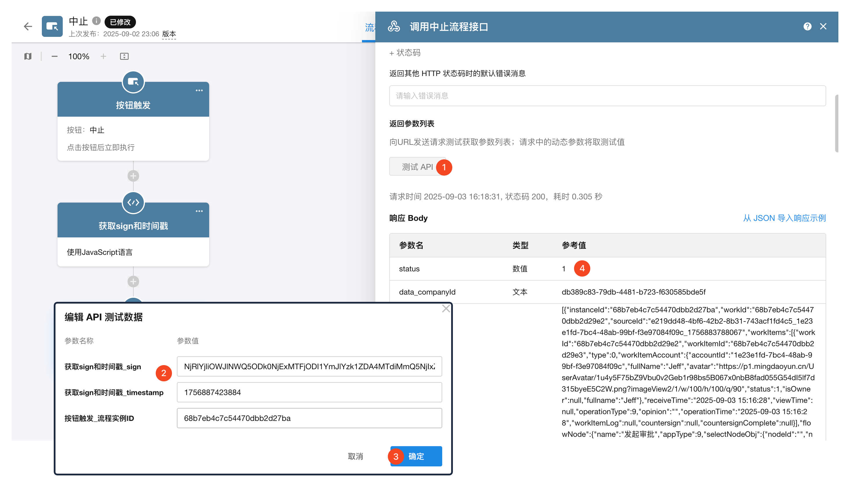

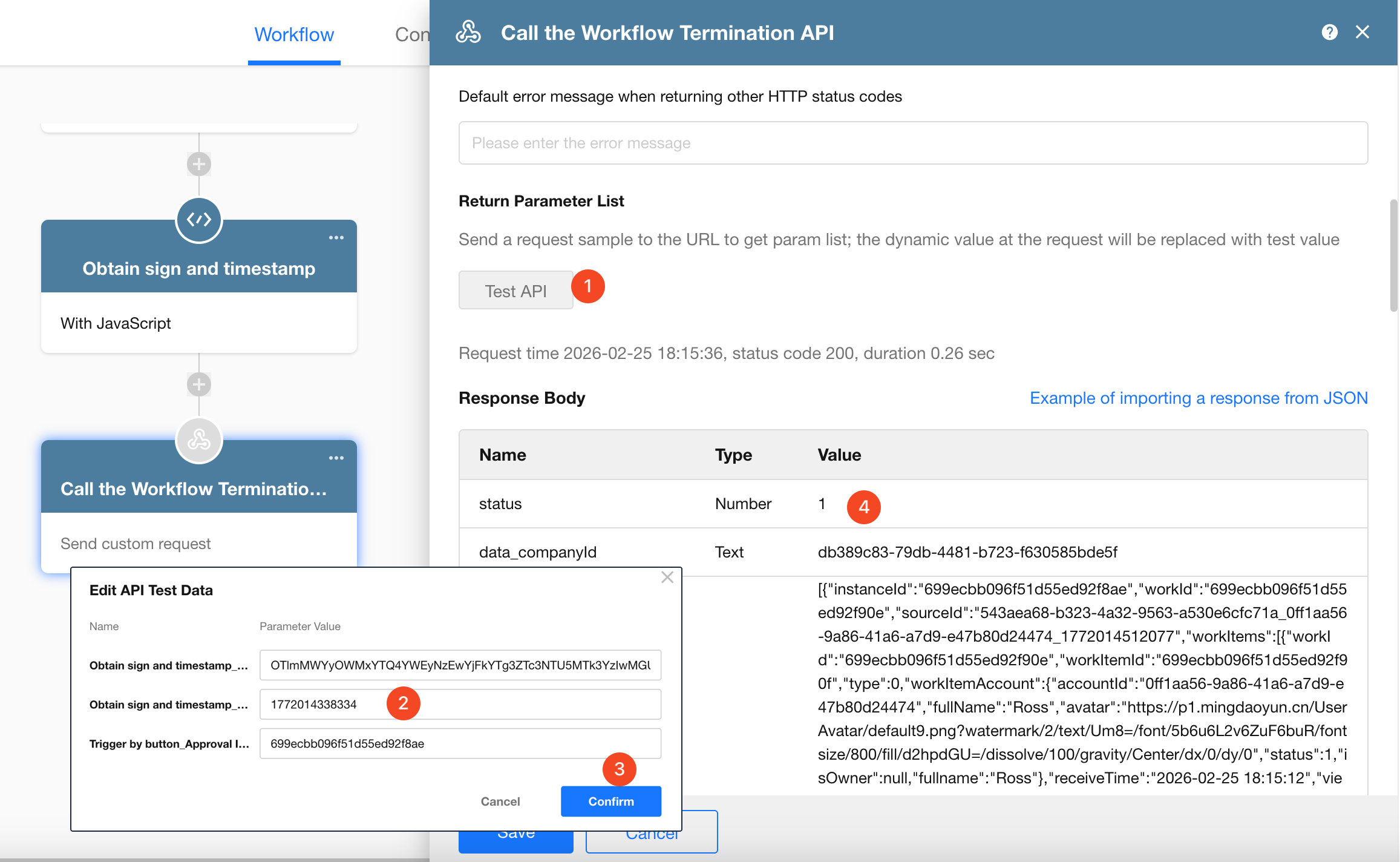

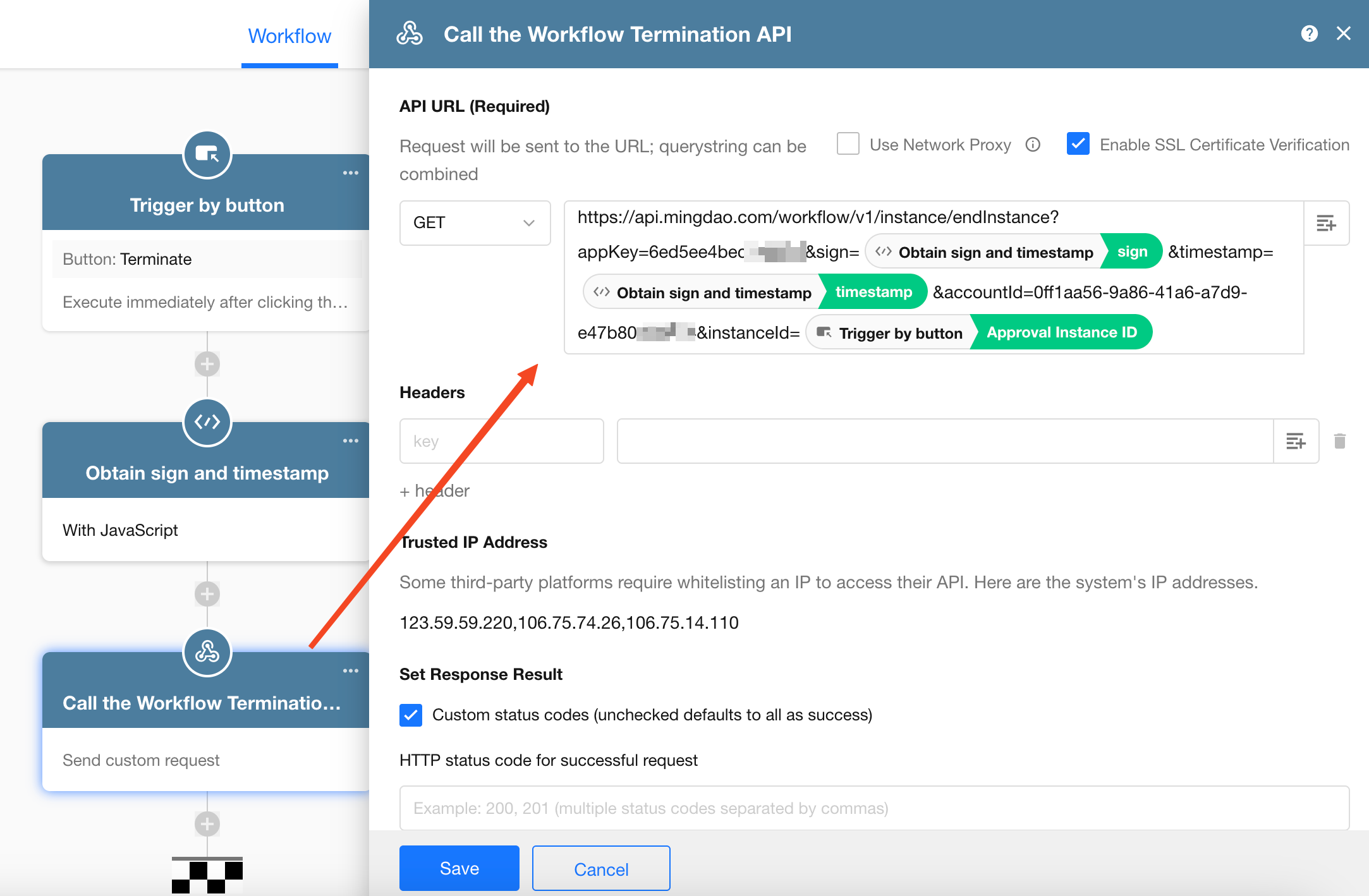

4. Call the Workflow Termination API​
In the workflow associated with the “Terminate” button, add a Send API Request (custom) node and configure the request URL.
Copy the following URL template into the request URL field.
Set the request method to GET, and replace the parameter values with the retrieved static values or node fields.
https://api.mingdao.com/workflow/v1/instance/endInstance?appKey=parametervalue&sign=parametervalue&timestamp=parametervalue&accountId=parametervalue&instanceId=parametervalue
Example:
Click the Test API button and enter the retrieved parameter values as test data.
If the request succeeds, it typically returns status = 1. You can also verify in the workflow History that the instance has been terminated.

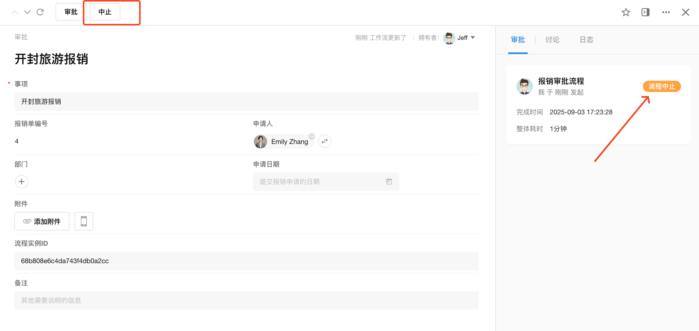

5. Publish the Workflow and Test​
Trigger a new workflow instance, then click the “Terminate” button to end the approval workflow.

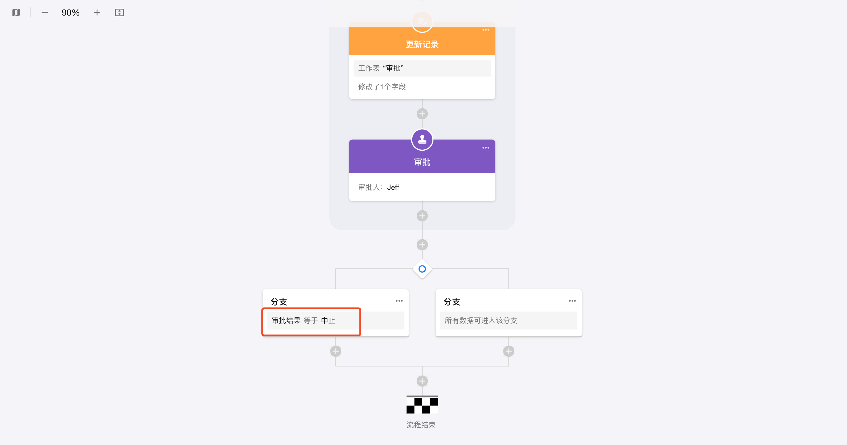

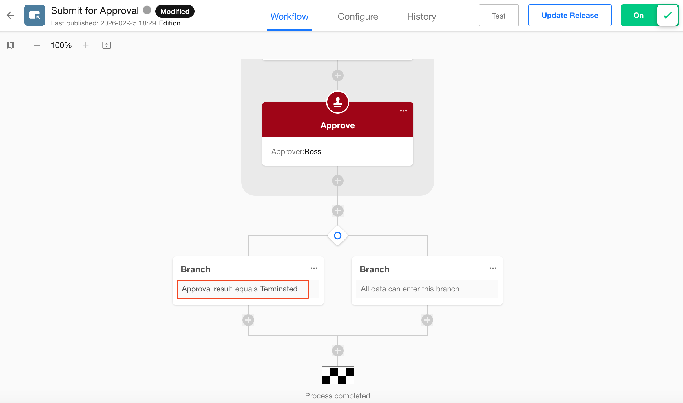

  • After terminating an approval workflow, the main workflow can branch based on the approval workflow status.
